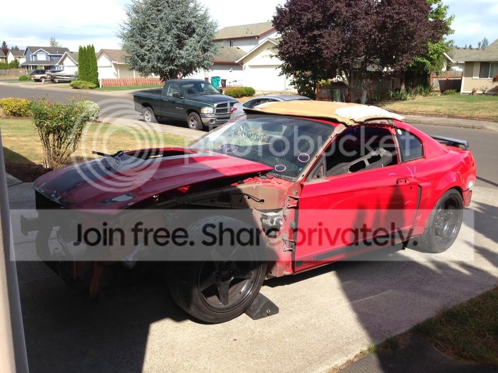

Upon gutting the mach 1 the other day I stumbled onto this under the driverside of the dash. Any ideas why its there and what its for?
