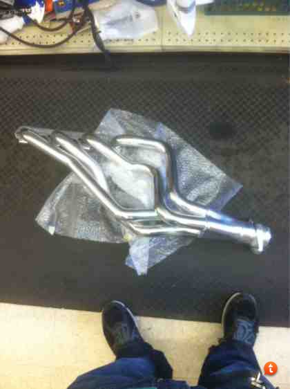

Headers showed up today. Really nice pieces. Just waiting on it to warm up a little to really start tearing it back apart

And here's my one picture from tonight- couldn't resist hanging that gorgeous header off of it to see how it was going to look. I'm thinking I need a shiny intake too to go with these and the valve covers.
