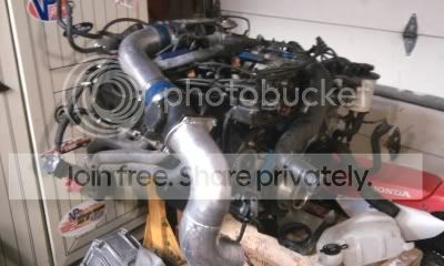

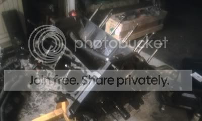

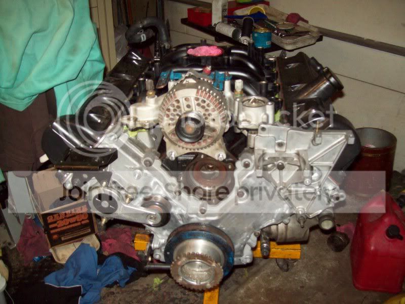

and the 4.6 dont have that many pics of it but heres what i have for the swap already

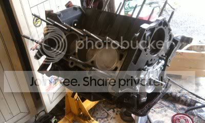

98 romeo 4.6 block
patriot performance stageII heads w/ cams
pi intake
ross forged pitons relieved for patriots
mach1 guage cluster
97engine harness w/ ccrm
slp long tubes
custom adjustible trigger wheel
98 cobra rear w/ brake brackets
magnaflow magna packs
magnaflow 3.5 midpipe.
cobra take out crank
cleaned those heads up a lill

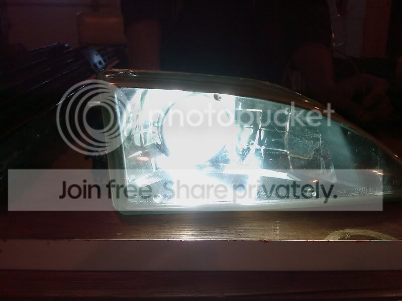

damn forgot im also in the middle of a projector retro fit, caught up right now cuz i broke my actuator but once i get a new one ill be sealing these up and get these in..

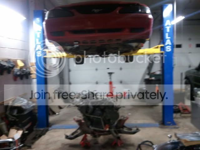

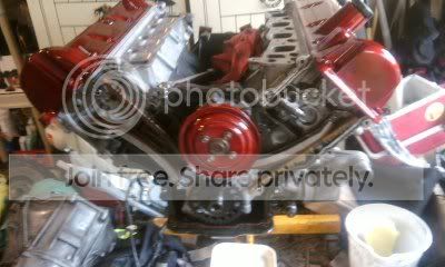

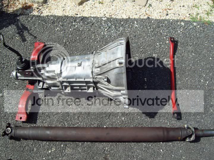

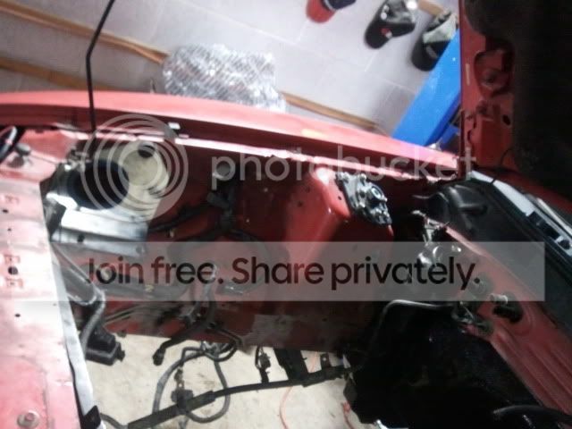

So i've been lurking around here alot, and i just realized ive kept you guys outta the loop..
shitty t45 i know. but it will be nice to cruz this summer while i figure out something else.
shopping spree i ordered the a/c condensor, misi radiator, all the gaskets, bearings, seals, ect ect
made shure i had everything
then built it
done

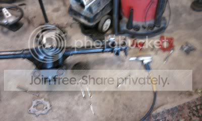

installing new rear
test fitting new mach 1 DD
well ive got all the parts, i have a crate full of harnesses ccrm, ecu, ac lines. any week now when its
nice im going to tackle her thanks for checking it out.

Re: shaggys 4.6 swap: motors built, have all parts, pic update
i have not installed the engine just yet. im prettty sure i have everything just saving to pay my painter to spray my engine bay when its all out. i wanna go darker red in the fall but i dont want it to be half a*s so i want the bay painted aswell. so the 4.6 is just sitting pretty in the garage.
i did however score a free lfp flywheel (the guy ive been scoreing swap parts, putting his cobra together and something about he needed the stock fly wheel cuz its set up for 10.5... well the lfp is drilled for both clutches...) so i win! lol
and what are you looking for in the rear?? i have a extra housing if you need shots of anything...
those are all the shots i have of a 8.8

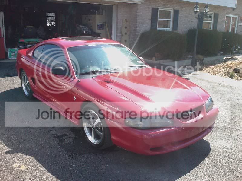

Holy crap guys didnt even realize that i finished and never even shared with you guys. so here it is.
:p

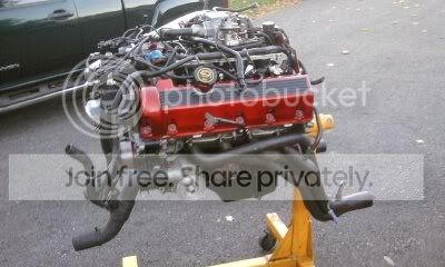

and what look like under my hood now!
ok a little summery for all of you that didnt read. went from a 95 3.8 with mach 1 take out shocks/ struts springs, mm cc plates, mach 1 rims/ brakes, cobra rear, no name racing seats, me own rear seat delete, mach steering wheel, smoked headlights, 5/20 tint, 255lph fuel pump, and hids, TOOOO..
4.6 283 yes 283. cobra crank, mod max feather forged rods, ross flap tops, pp stage II heads/ cams with valve train, ported plenum bbk. cai 24lb injectors, adj trigger wheel, slp long tubes, magnaflow catted x/ magnapacks, flp aluminum flywheel ram hd clutch, t45. steeda triax. misimoto radiator, oem condenser, adjstible clutch cable quadrant and fire wall adjster, autometer oil presss/ narrow band/ water temp. gt clutster with mach 1 inlay.
still have a few bugs to work out didn't replace the chassis harness so turn signals didn't work that's fixed but my parking lights and my fuel gauge isn't working. its smokes a lot until warmed up and is blowing valve cover gaskets. i think my breather system isn't doing it enough. seems to stop smoking if i run it without the oil cap... any input on this would be appreciated.

i ahd a problem with valve cover gaskets on my drivers side..i finally grinded it down in the groves where the seal fits and sprayed that spray seal onto the heads and used rtv on the corners....it hasnt leaked a drop even with nitrous thrown at it...and as far as smoking id throw some seafoam through it and then change ur grade of oil and see if it helps...

thanks frankenstang the valve covers were the only gaskets i reused. i plan on replacing them i did purchase new valve seals i heard patriots valve train isnt the best to say the least and if your not lucky you get a poopy set.
what oil would you recommend? i honestly finished this thing late January and Ive been driving it around the block every two weeks to let it get warm and fluids circulated. it also needs a tune in the worst way lol,
