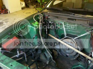

Did first startup and got all the leaks fixed and fine tune adjustments sounds very nasty ! def love this car

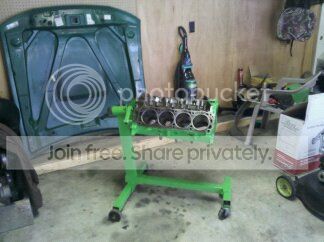

heres a pic of it as of now

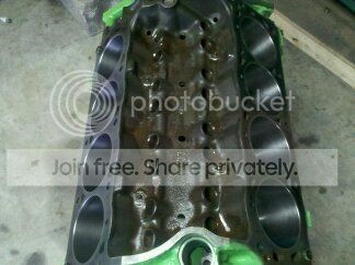

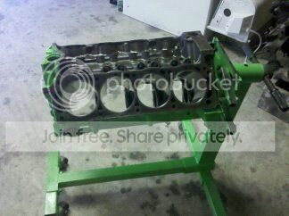

block back from machine shop. had it hot tanked ,crank and cam bearings and had him make crank bearings fit a little loose so i wont burn crank bearings up bored 40 over so 308 .
