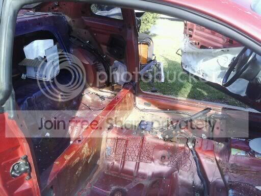

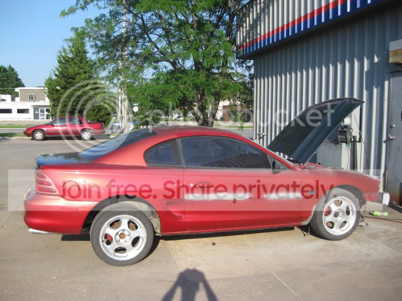

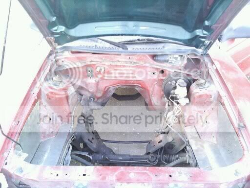

For some reason I can't find any pics of the exterior of the 1994, but I started out by taking out the interior:
There was a small quarter size rust spot in the floorboard around the ABS sensor plug, so I had to cut that out and repair that.

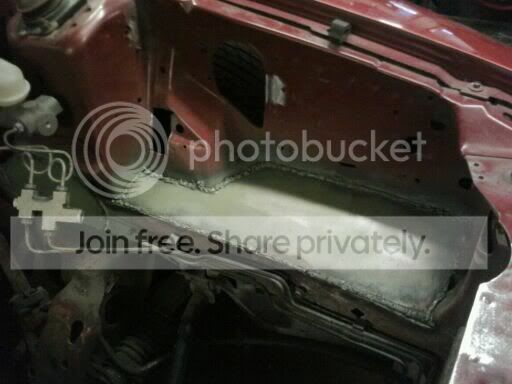

Then I decided to clean up the underhood. I already purchased a trunk mount battery kit, so that would be out of the way..
I went from this:
To the mock up:

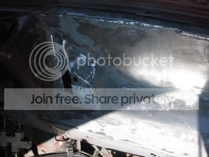

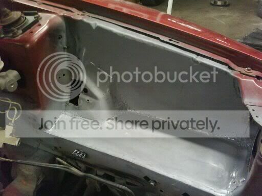

Then I welded up the panels and wondered why my welds we looking so "splattered"... apparantly there was an internal leak of the shielding
gas, so it was not traveling through the gun, So I eventually got it fixed, but before I did (basically MIG welding without gas):
To now in it's current state:

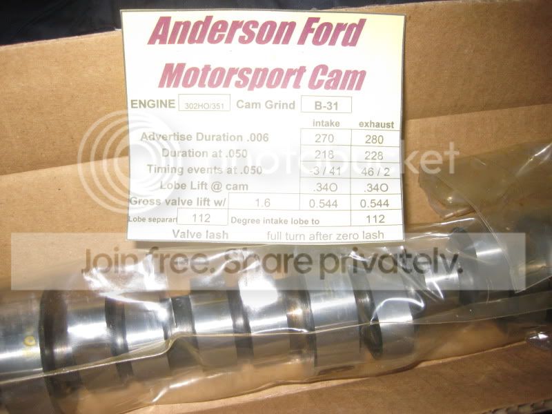

Then I started aquiring a few new "goodies".

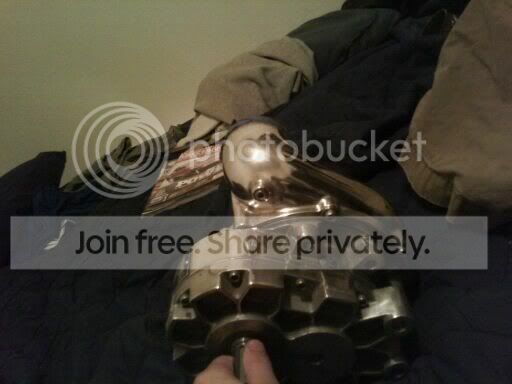

Vortech V2 S-trim kit, originally plain silver (I polished it myself)

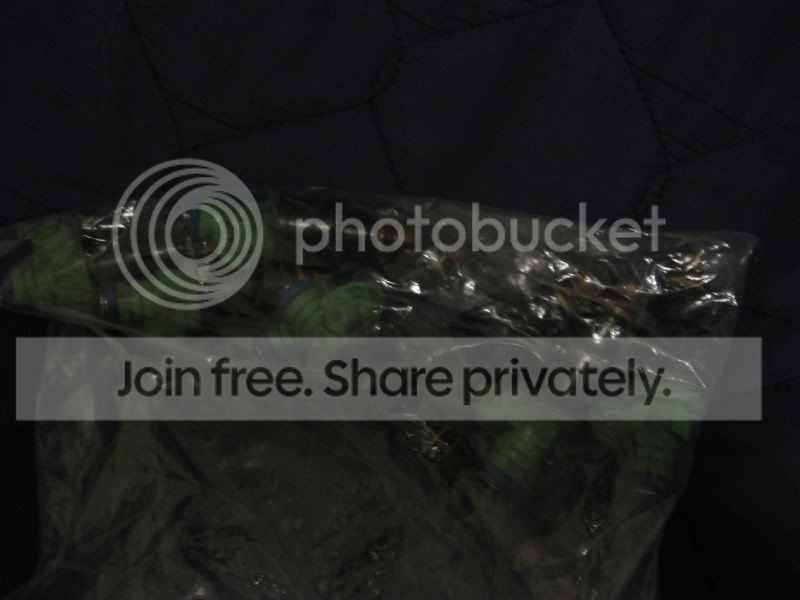

Ford Racing 42lb injectors:

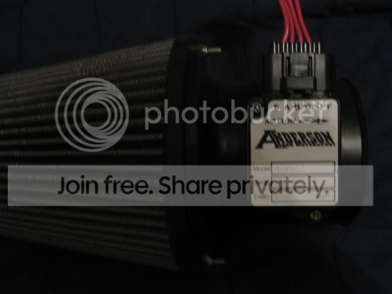

PMAS 80mm MAF cal'd for 42lb inj.
Anderson Ford Motorsports B31 cam

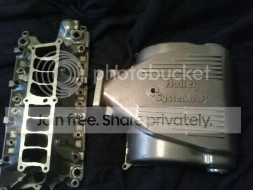

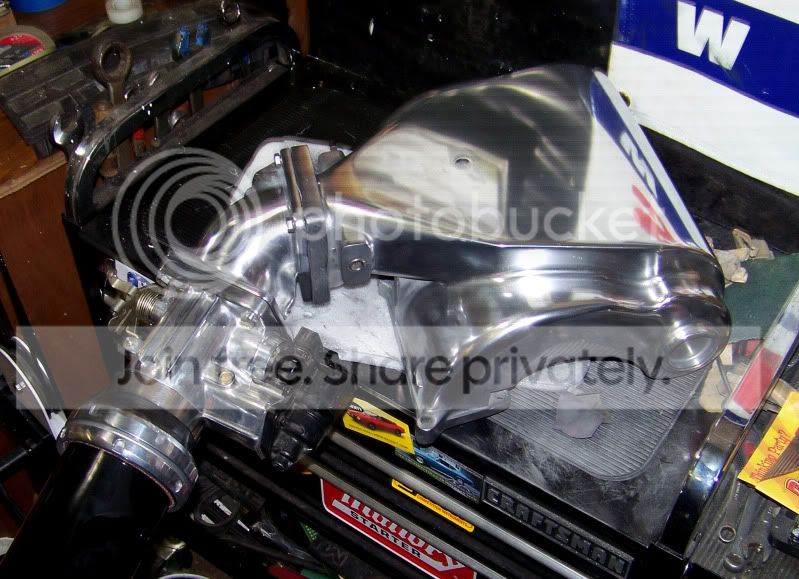

I still haven't made up my mind about what to do with the Systemax... I do like the idea of smoothing it out and polishing it:
(picture courtesy of 95opal)
But I also want to make sure the "balance" of colors/chrome looks good in the engine compartment...

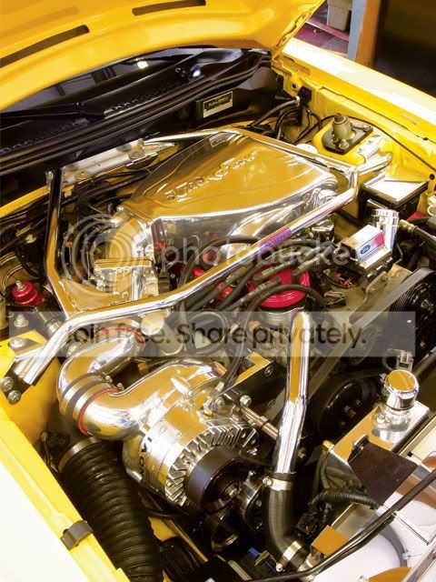

Although I do like this setup as far as the chrome goes:
I also thought about painting it the gunmetal color I painted my access brackets in (pictures soon to come)...
Maybe I will have a better idea when the engine is on a stand and I can see how everything ties in together.

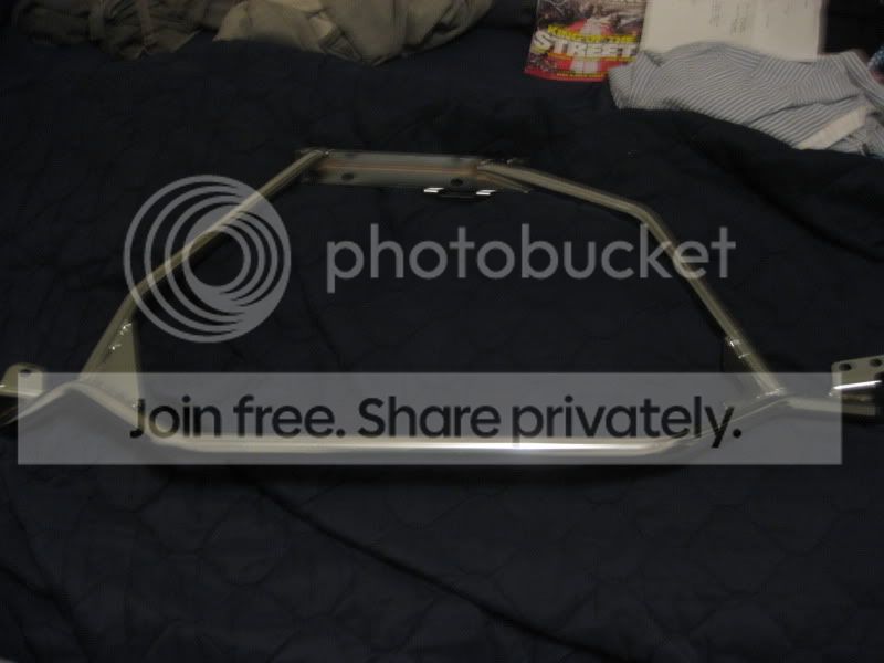

I haven't had much extra time to work on the car lately, but I did snag this BBK strut tower brace (barely used) for $50 off craigslist.

Good looking build, how'd you polish the S/C?
2slo95fiveoh
Dec 31, 2006
2,559
Lawrence, Kansas
Re: 2slo95fiveOhs 1994 GT build up from the ground up
I started with an angle grinder to get all the casting flash off, then 320, 500, 1000, and 2000 grits of sandpaper...
I finished it off with mothers mag/aluminum polish.. I like the way it turned out, but I still need to figure out the color scheme under the hood.

Looks good man good progress so far. One thing though i would look into a larger MAF like a 90MM instead of the 80MM
2slo95fiveoh
Dec 31, 2006
2,559
Lawrence, Kansas
Hmm, you think so? I figured it's not a very big setup (compared to strokers etc..), I thought 80mm would be big enough for a HCI/S-trim
302... I guess I could be wrong though, but then I don't know why Anderson Ford Motorsports would make only an 80mm and a 92mm in the
Pro-M style MAF meters... On their website you can get the 80mm cal'd up to 80lb fuel injectors so I'm not saying your suggestion is wrong,
I just don't know why they would offer a MAF that size for those injectors, if it wouldn't work well.. Perhaps I could call the place that
will be tuning the car and ask their advice... For some reason (I could be crazy) but I thought I read something somewhere that said your "mm" MAF and "mm" Throttle body should be very similiar in size otherwise you can run into driveability issues... I could be mistaken though..

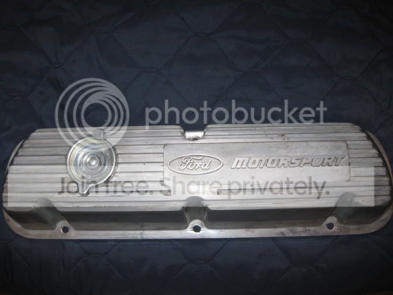

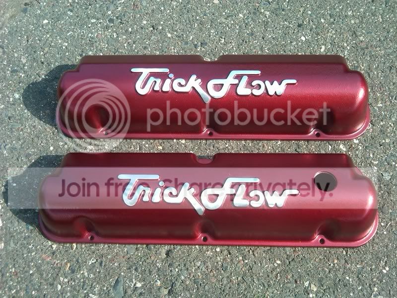

Hmm... Now I'm at a bit of a dilema.. Currently I have Trickflow valve covers sitting on my engine, and I don't have any complaints with them, but
my boss gave me a set of Ford Motorsport valve covers for free, so i was thinking about switching it up, although those have the oil fills on the wrong
side..
The Ford Motorsports I got:
The Trickflows I have:
An Idea I have for the Trickflows (although paint either gunmetal or whatever blue I decide to paint the exterior)
Thoughts?

Nice build up Matt, wish I was around to see it happen. I'd keep the Trick Flow covers. You have Trick Flow heads, no shame in more advertising.
Good luck with the color choice. I think SB is the way to go, maybe a little convincing is needed...
(Sorry to whore up your thread but it needed to be done!!)

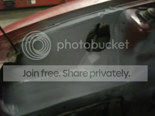

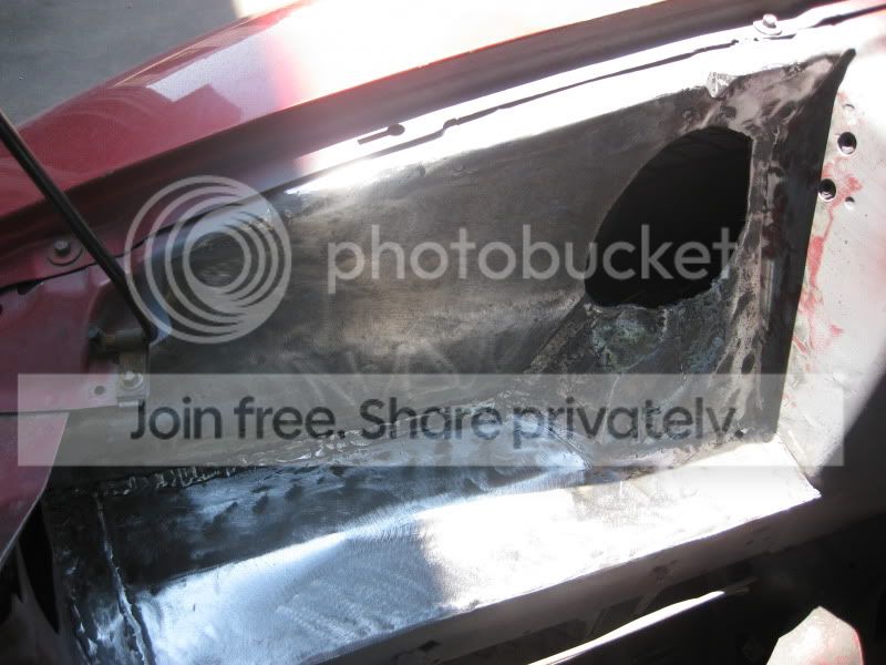

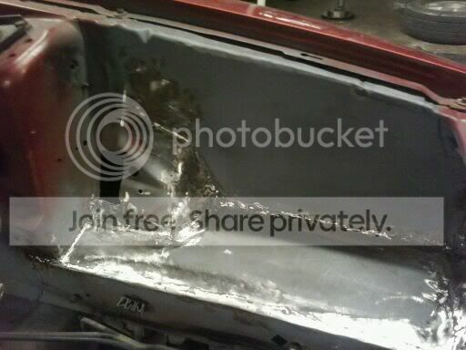

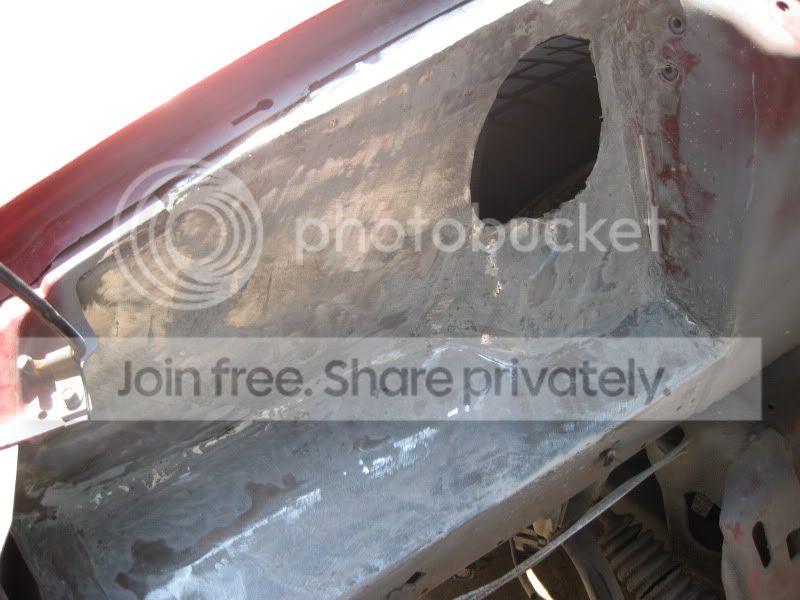

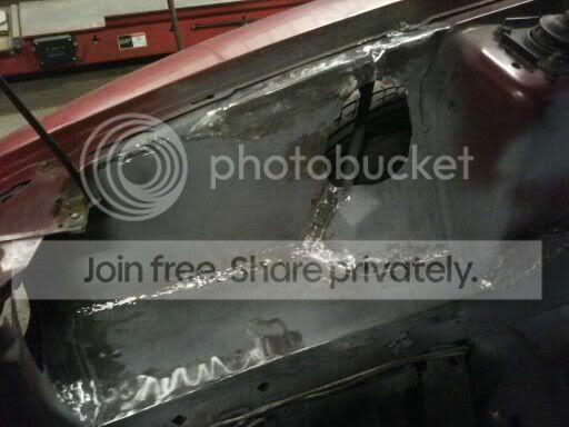

More progress tonight.. Welding, grinding, sanding, and repeat. I'm pretty close to smoothing out the corners with light filler and going to
final sanding..
And after a quick spray of primer to prevent rust:

I did a little more work on the car the last few days... Does anyone have any experience applying body filler to the engine compartment?
I've done about as much metal working as I can to make nice smooth flowing side panels, but I'm hesitant to use filler to smooth small imperfetions
in the metal work in fear of the heat/vibrations taking it's tole.. thoughts?

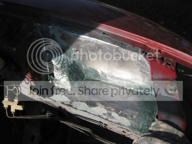

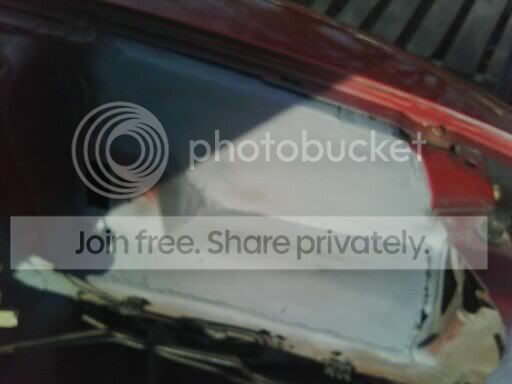

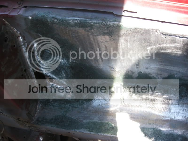

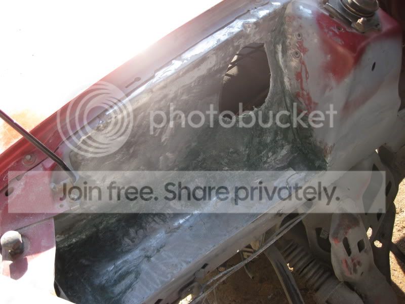

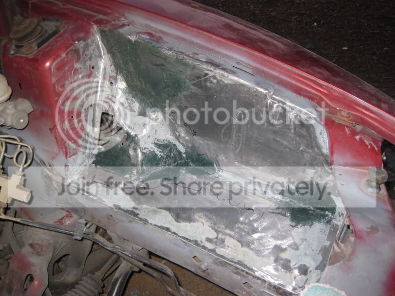

Spent a good 9+ hours on the car today, I made a lot of progress. I asked around a few of the connections I still have in the auto body
industry, they all seemed to say that a fiberglass resin would be the best bet for my underhood smoothing, so I bought some of that and went to work. I also finally got around to taking pictures of the exterior of the car so here goes:
Pass side before work today:
First coat of resin sanded:
2slo95fiveoh
Dec 31, 2006
2,559
Lawrence, Kansas
Re: 2slo95fiveOhs 1994 GT build up from the ground up... update 7/9

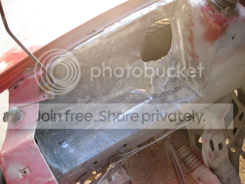

Didn't get the right contour I was looking for, so more resin:
And as I left it tonight:
Drivers Side:

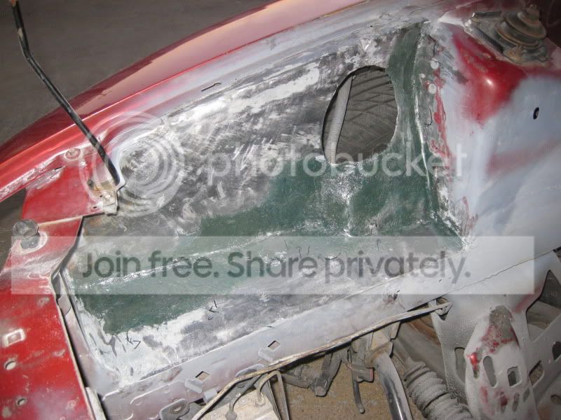

Overall I am pleased with the progress. I was getting sick and tired of welding, grinding, and smoothing. Now its filling, sanding, and checking.
The plan is tomorrow to sand down this last application of resin, apply a very thin layer of filler, then shoot some sealer.
I was hoping to get to the sound deadner removal in the interior today, but body work took more time than anticipated.
Comments/Questions welcome.
