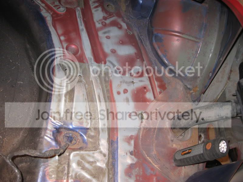

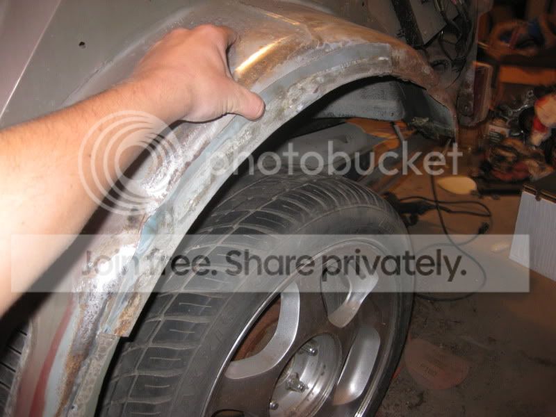

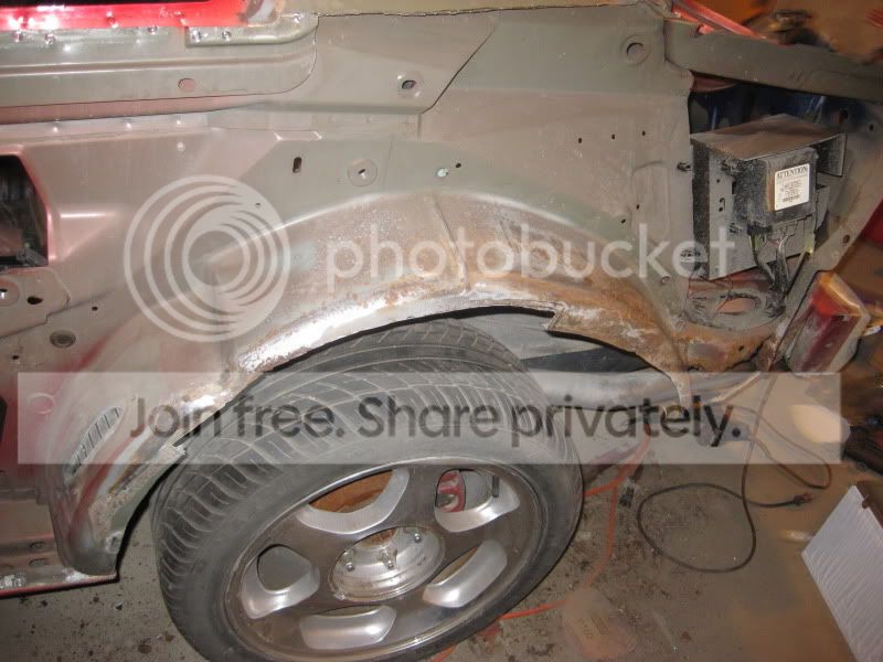

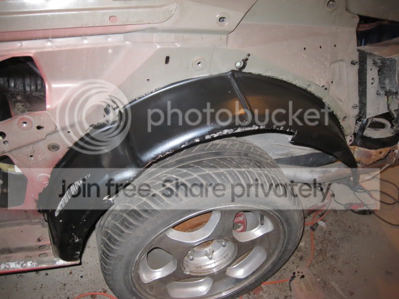

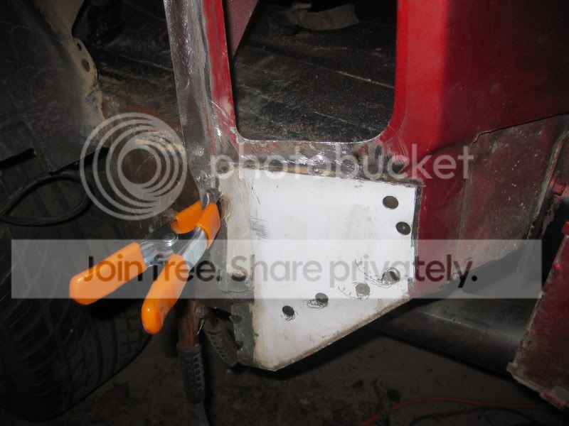

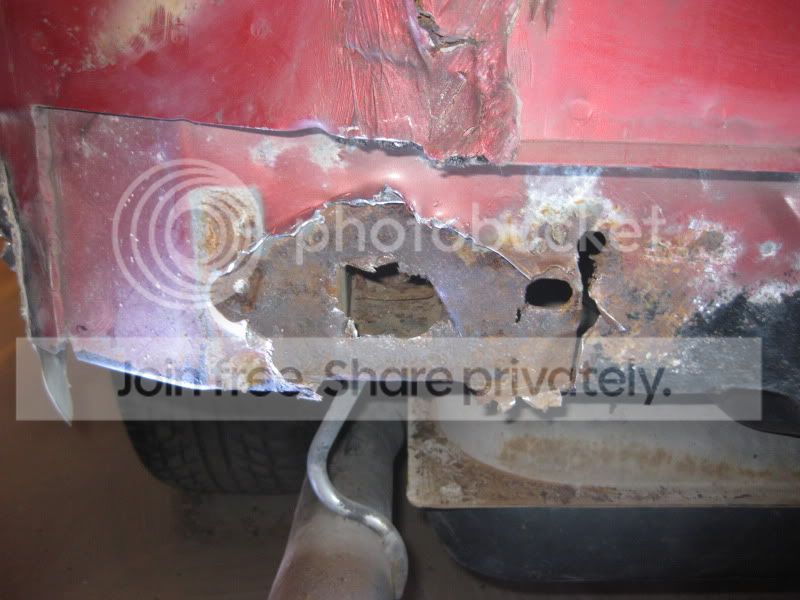

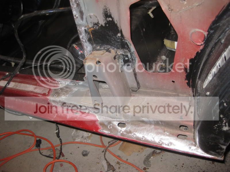

Made some progress tonight... The inner fender of the quarter panel had some slight surface rust that spread from the major rust on the quarter panel. Although at the top of the fenderwell there was a little more extensive rust that I wanted to replace before I attach the rust-free quarter back on.
The cut out portion:
The replacement piece (off the same portion of another mustang)
A buddy of mine is borrowing my welder so that patch will have to wait for another day

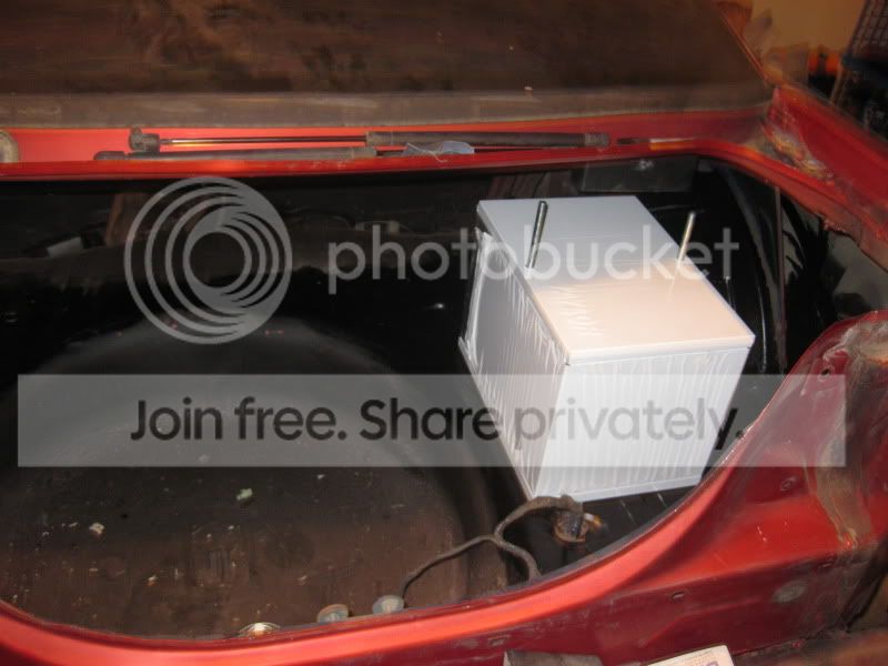

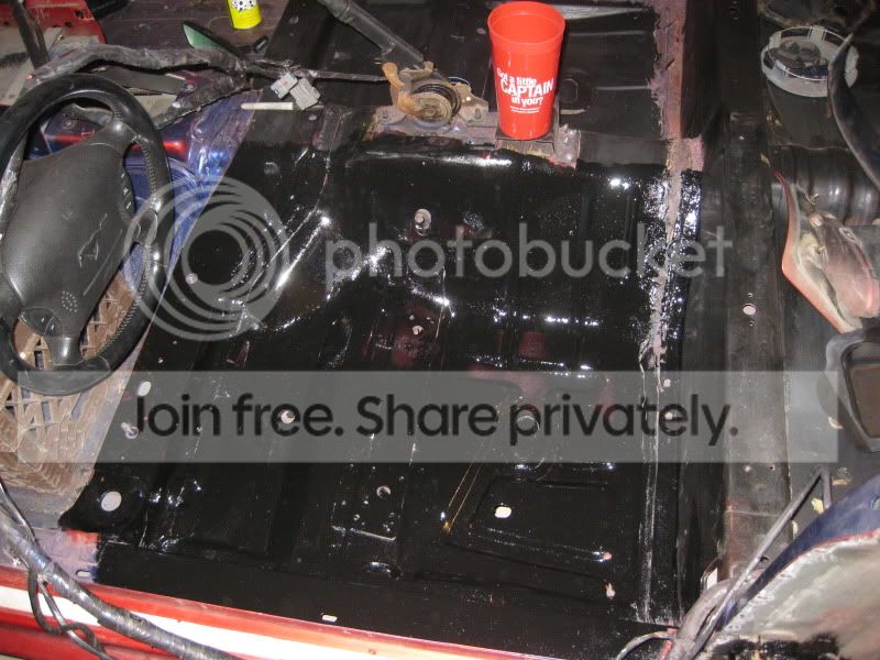

Moving on to the trunk. I previously mentioned that I applied POR-15 to the undercarriage, as well as most of the floorpan.. the trunk and drivers front portion of the floorpan were the only ones I hadnt gotten to.

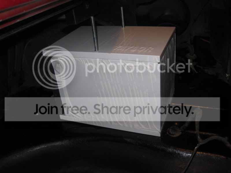

A while back I purchased a trunk mount battery kit..
So I drilled the holes in the trunk... With the tank still in place... AHHHH I'm a crazy person! or just that good...

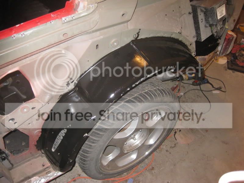

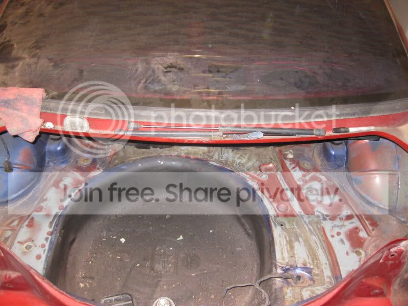

Then sanded down the trunk in preparation for POR-15...
POR-15 applied:
Battery box mocked up:
Questions/Comments/ Suggestions welcome.

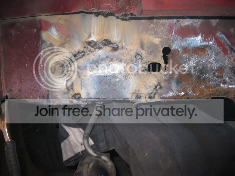

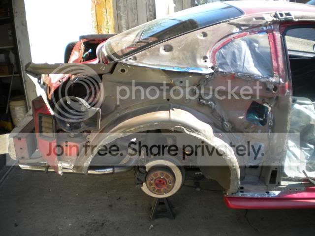

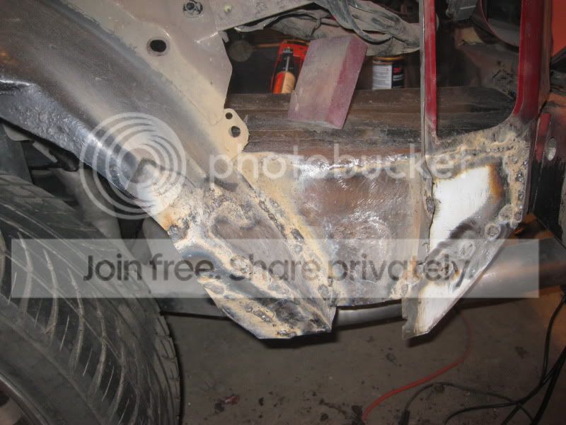

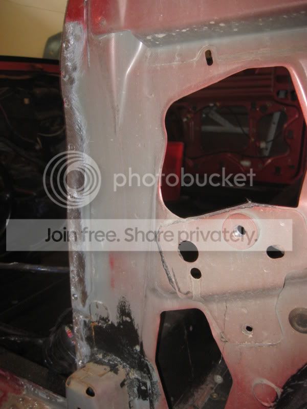

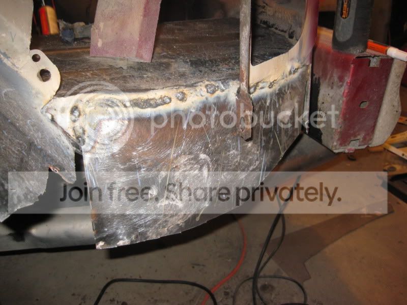

Finally had a little extra time. Between being a full time student and working full time, extra time is very hard to come by. I finally got my welder back from
my buddy, so I went ahead to welding in the two patch panels underneath where the quarter panel attaches to.
Where I left off:
fender panel welded in:
a reminder how bad the rear fender portion was:
and the replacement welded in:

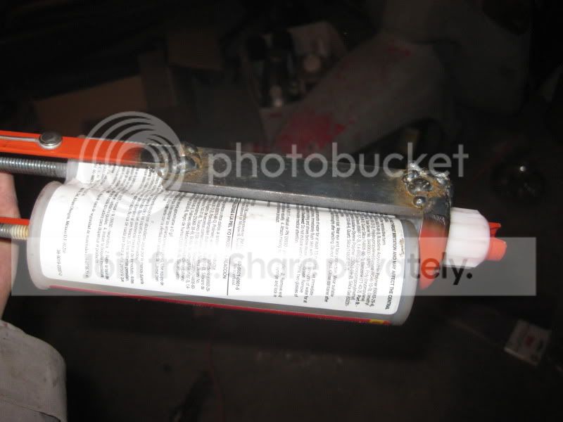

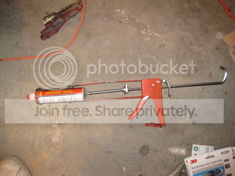

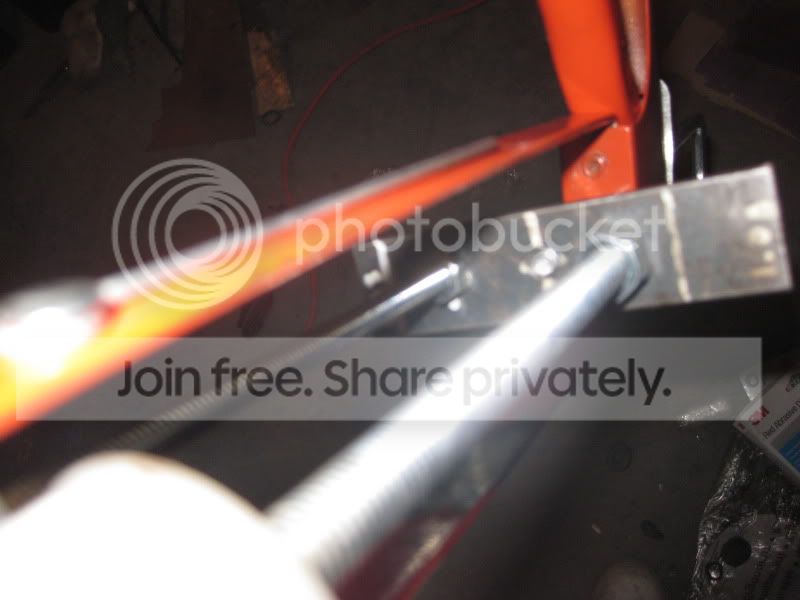

After talking to my painter and doing my own research, I decided to attach the replacement panel with 3Ms panel bonding adhesive (and some minor welding) as opposed to all welding... I already got the cartridge through a buddy for his cost, so that was a good deal. The 3m applicator gun, not so much.
This is what the applicator gun looks like:
The cheapest I have found it is $320....... So after looking at the cartridge, and realizing it was basically a large version of JB weld, without
the depressor.. So I made one.... for $22.

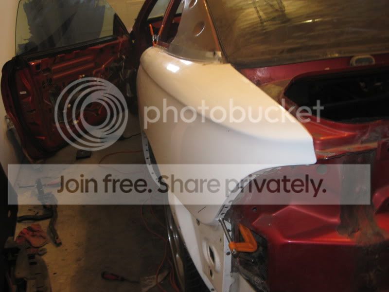

Some more work done... Finally!
Decided to clean up some of the mating surfaces and existing welds:

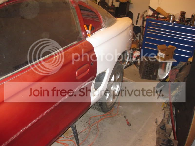

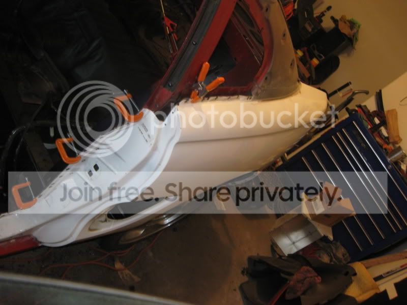

Then it was time for the exciting part, mocking up the new quarter panel for fitment:
2slo95fiveoh
Dec 31, 2006
2,559
Lawrence, Kansas

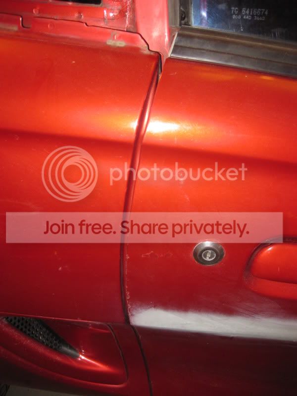

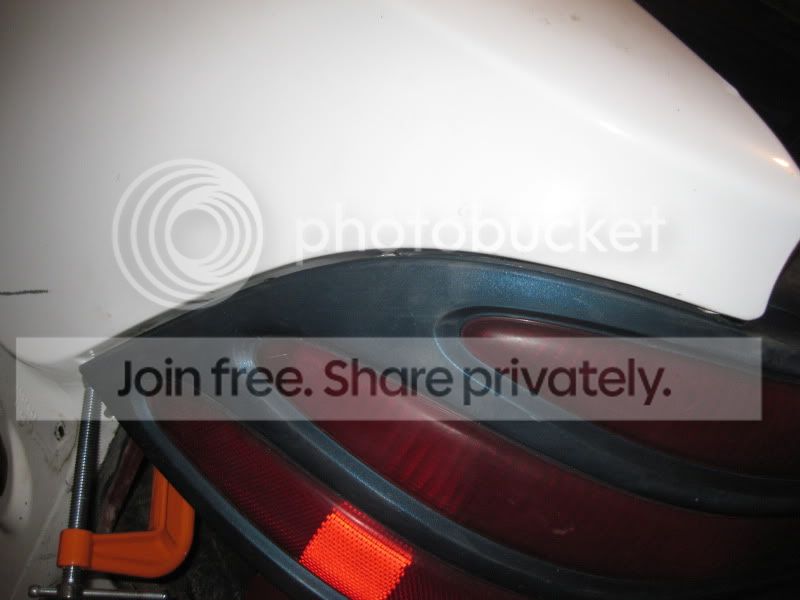

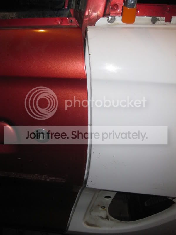

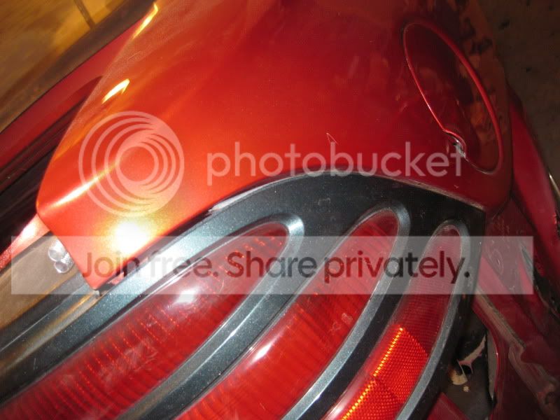

For fitting it for the first time, the fitment was actually pretty close.
Comparing the door to quarter panel gaps (Red/White is drivers side, Red/Red is pass side)
And the rear of the quarter panel gaps to tailights:

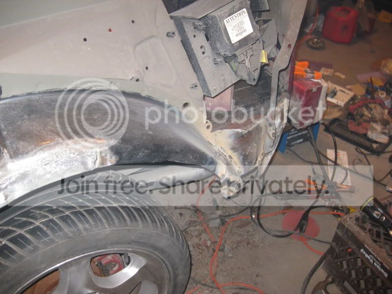

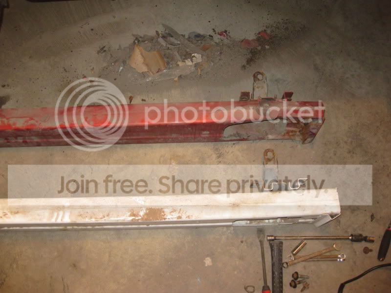

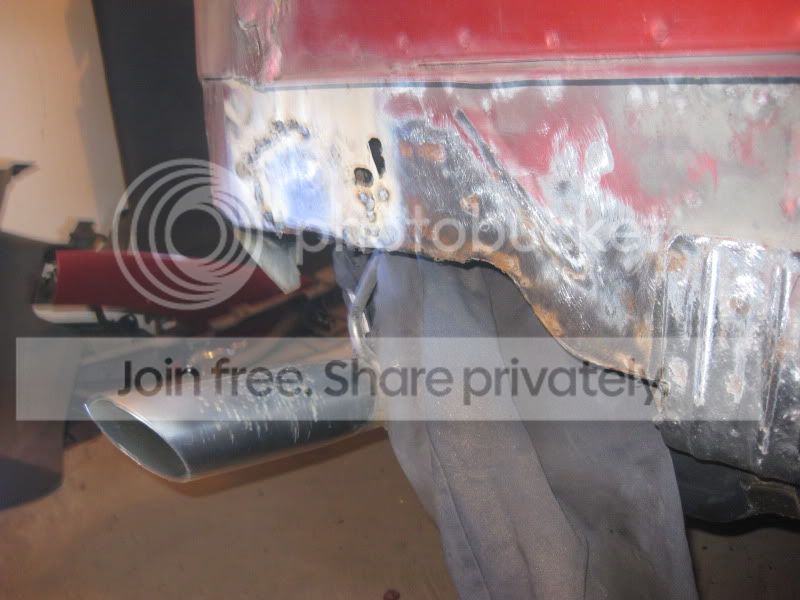

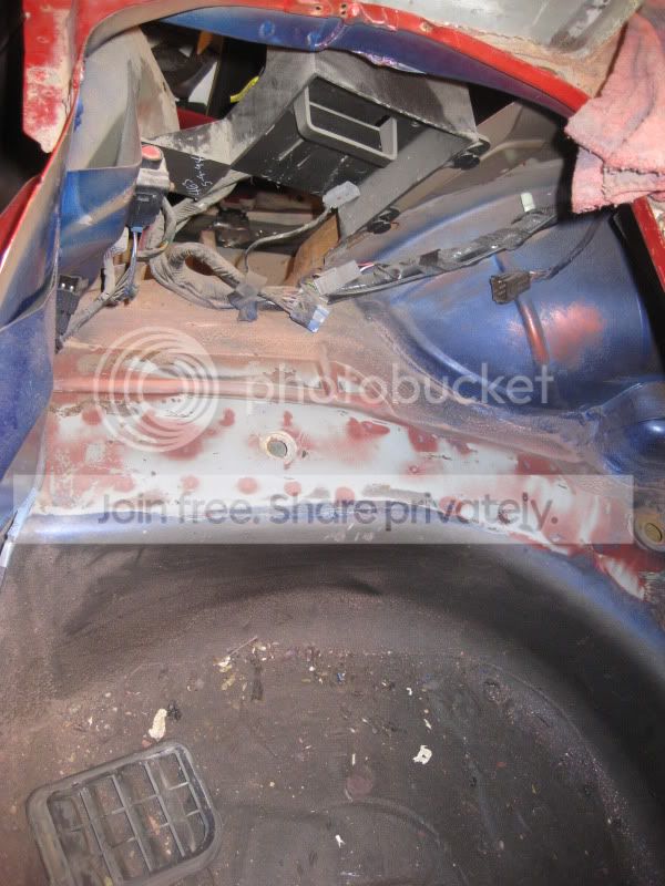

Did a little more work today.. I figured out that I had more metal missing/ infected than I thought...
These are 2 pics of someone elses car (happens to be the same color) of the passenger side to compare the lower portion (under the filler neck
on the pass side) and the portion that should be on my car (the drivers side).
So, what is was, and what it should be (if mine was passenger side, but you get the idea)
Someone else's passenger side:
2slo95fiveoh
Dec 31, 2006
2,559
Lawrence, Kansas

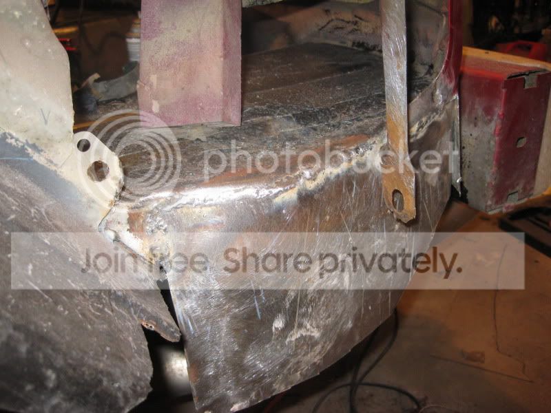

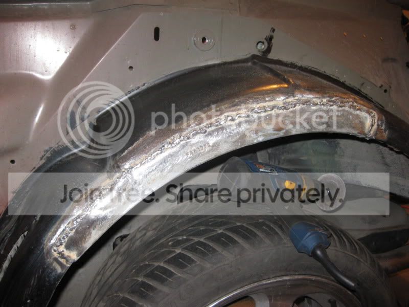

Notice the (example) inner fenderwell extends a lot further down then the remnants of mine. So I did some research and made my own:
That was about it for today.. My sh*tty ass welder (and my sh*tty ass welding skills) make for some nasty welds, so I will be using my
buddies grinder to clean them up before I do more mocking up/fitment of the quarter panel..

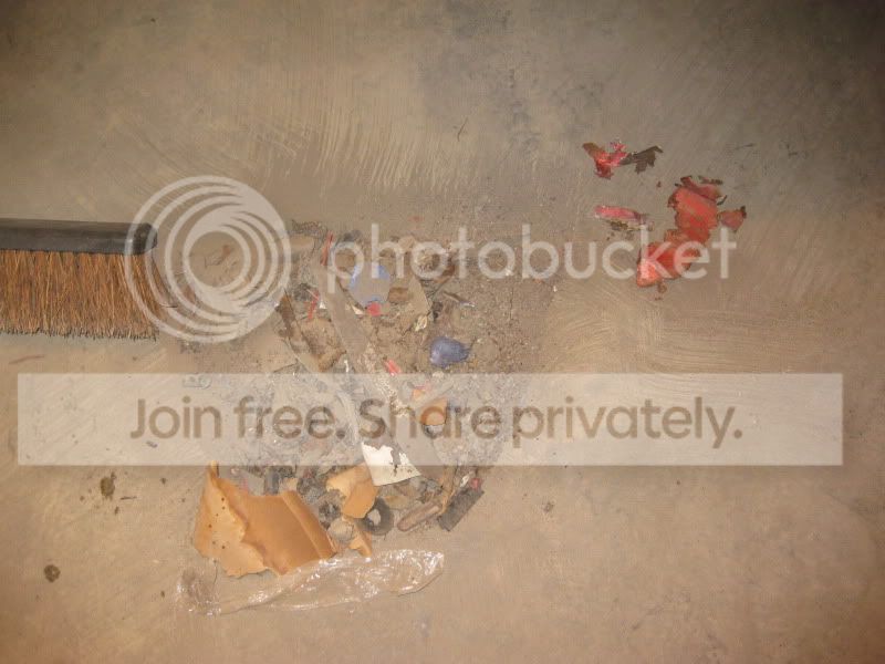

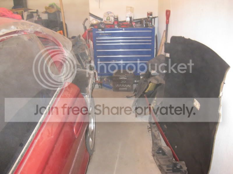

I started off by cleaning up the work area.. I had dust, debris, rusted metal and various tools laying around.. So I figured a little
organization wouldn't be too bad of a way to start out.
Its sad that all of this came out of my car, mostly behind the LR wheel, where all the rust and problem areas were/are:

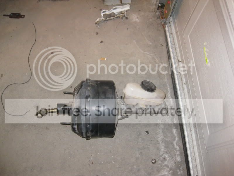

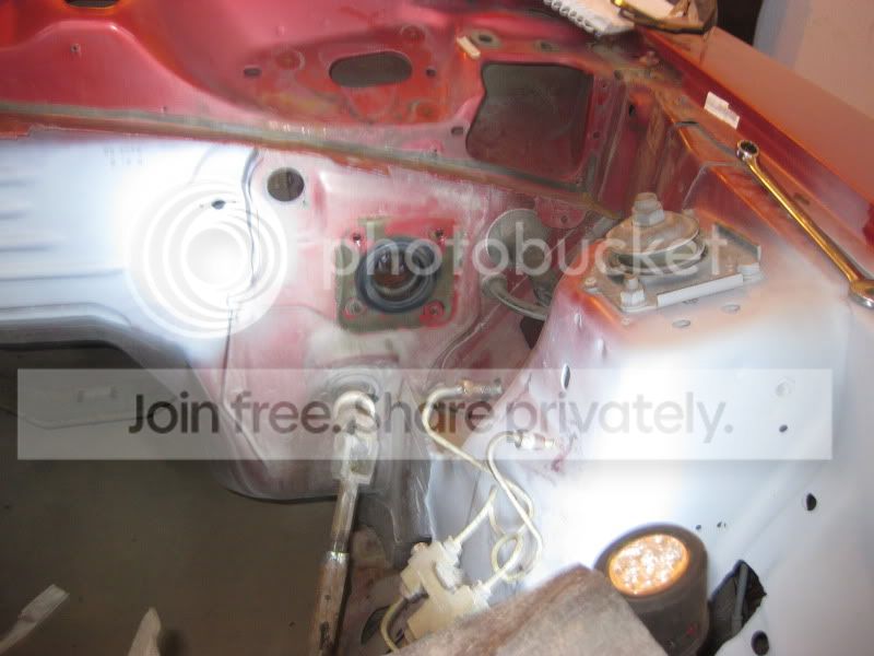

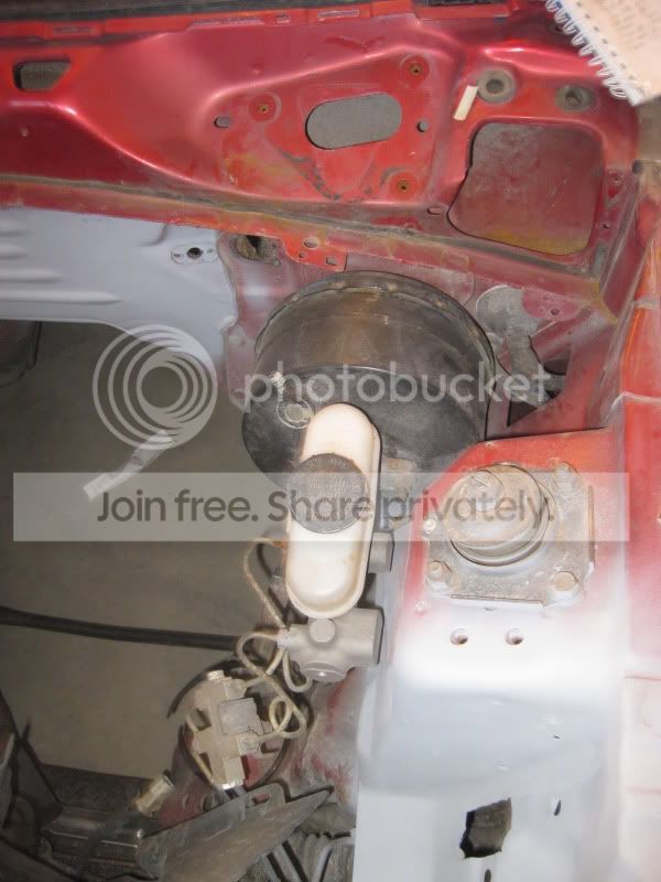

After that was all done, I remembered my painter suggested I remove the master cylinder/booster since I am having the
entire engine bay painted and cleared the same color as the body, so where I started:
Four nuts on the back side removed, and the two brake lines disconnected and it was out:
As it is now:

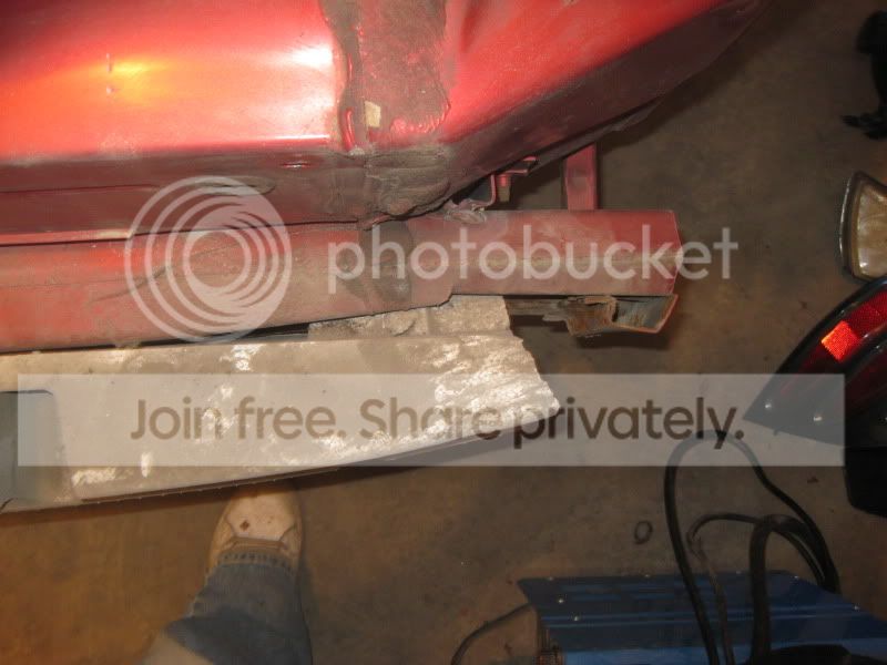

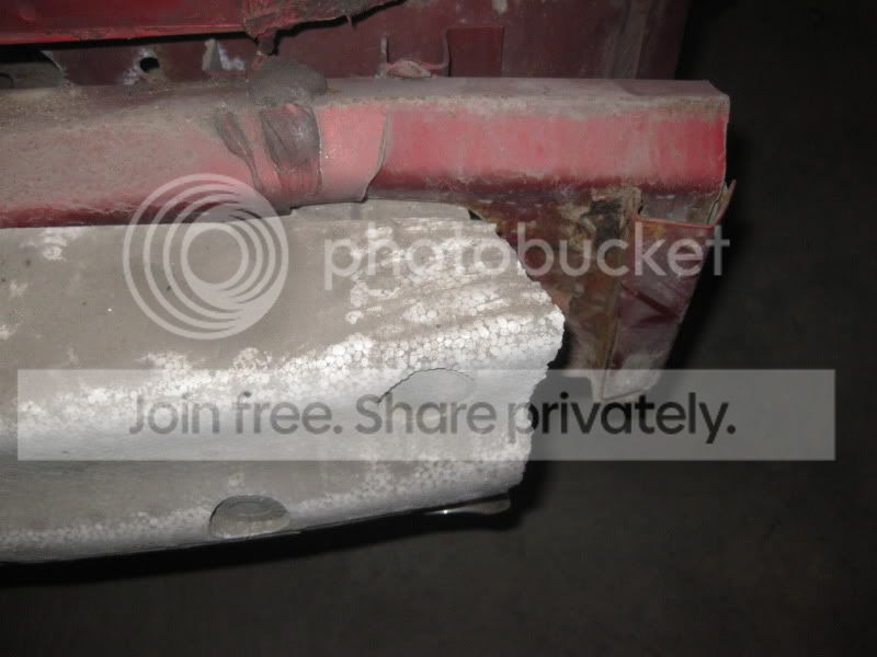

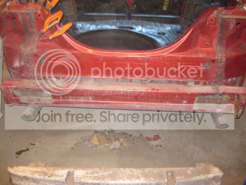

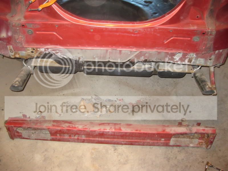

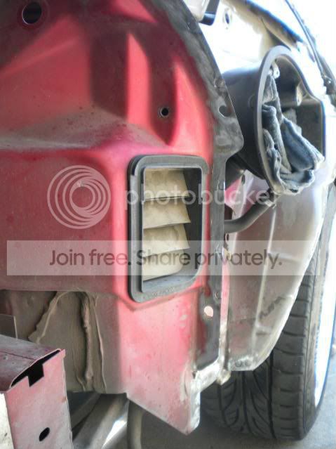

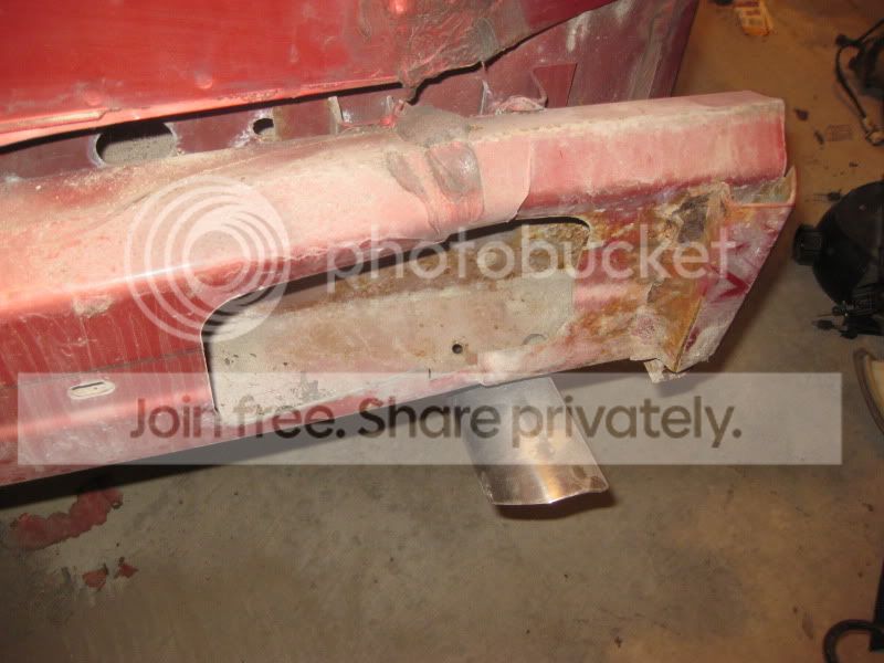

Onto the rear bumper. I believe the car was in a collision in the rear right corner, because the passenger quarter panel looks to be in terrific shape compared to the drivers quarter panel, and because of the damage done to the rear bumper (which they did not fix unlike the quarter pane)

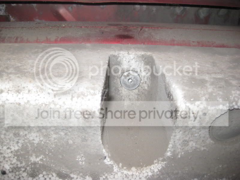

I have the other piece of the foam bumper, so I will probably just epoxy that back together. The metal bumper on the other hand, no so much, so I grabbed the metal bumper off the same white car I got the quarter panel from. So I started by drilling out the rivets on the foam:
And its off:
Up close damage of the passenger side of the bumper:

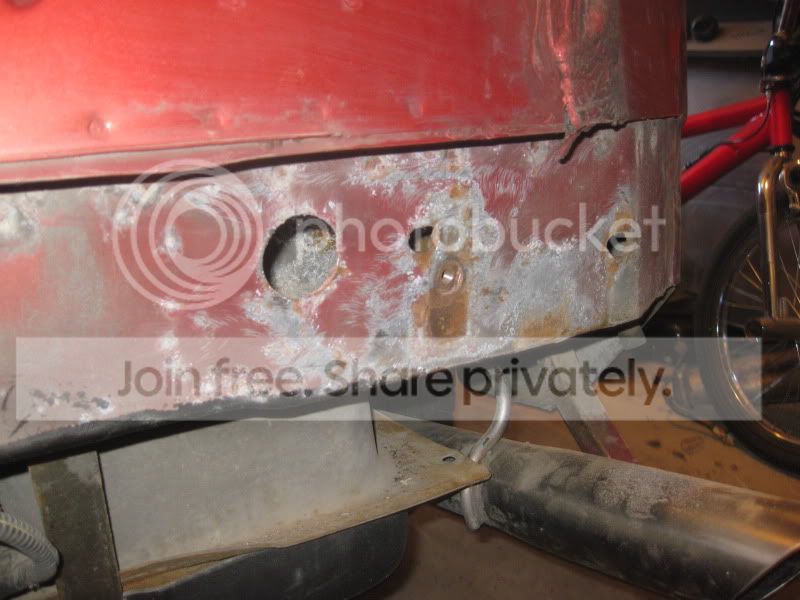

Then the 6 bolts that hold the bumper to the body. All of them came out rough and I thought all of them were going to break, but only had one snap off while removing, and it was one of the easiest bolts to access, so it could have been much worse.
Comparing old and new:

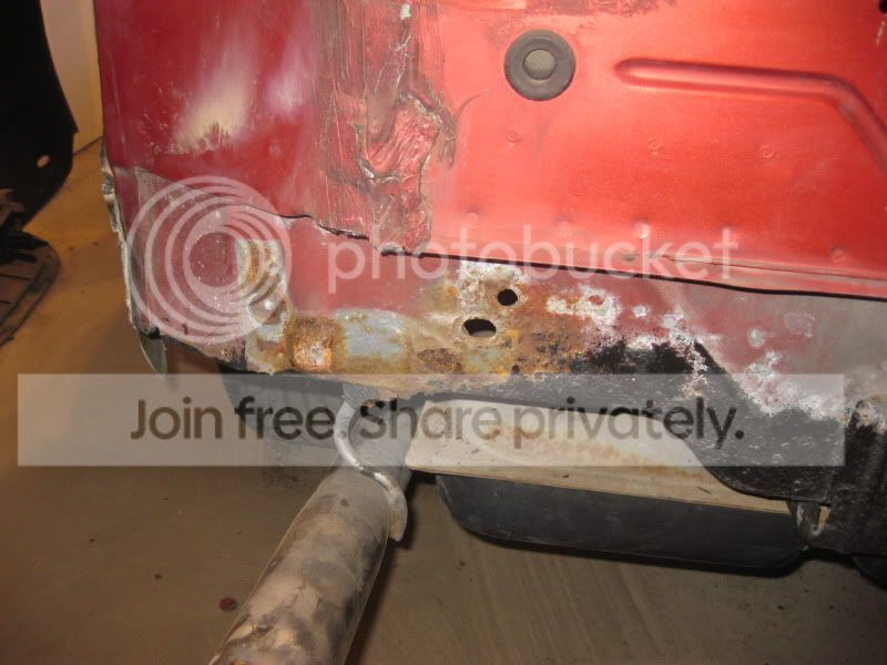

Oh great, more rust issues... This Drivers rear area is a nightmare on this car, but there's no turning back now.
Passenger side isn't nearly as bad:
Then I was curious to see how far it had been affected, so I just started chipping at it and soon enough:

But I'm not going to fret over this one too much. It is mostly the sheet metal for the rear of the trunk, so I just welded a patch panel in there:
That was it for today. I am still waiting on my buddy to bring by his grinder. Then I will grind down the welds for the quarter panel, and the rear bumper.
Por-15 will be applied over all of the sheet metal that will be hidden, then the replacement metal bumper bolted in, and more mocking up of the quarter panel.
