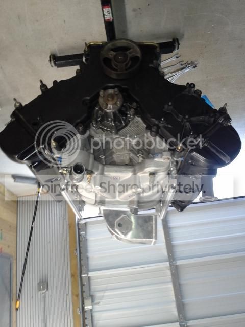

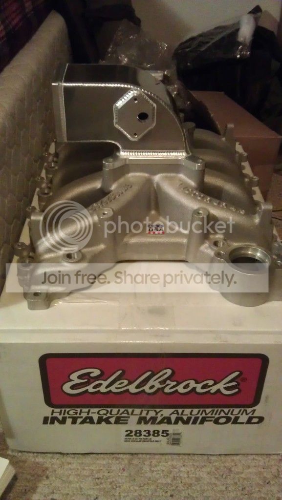

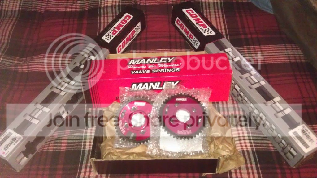

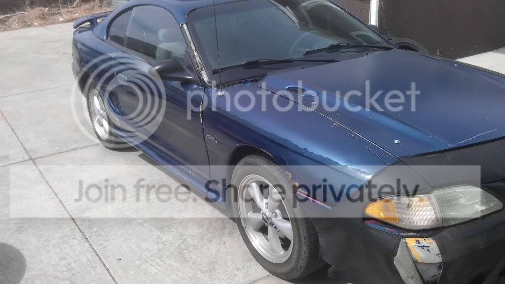

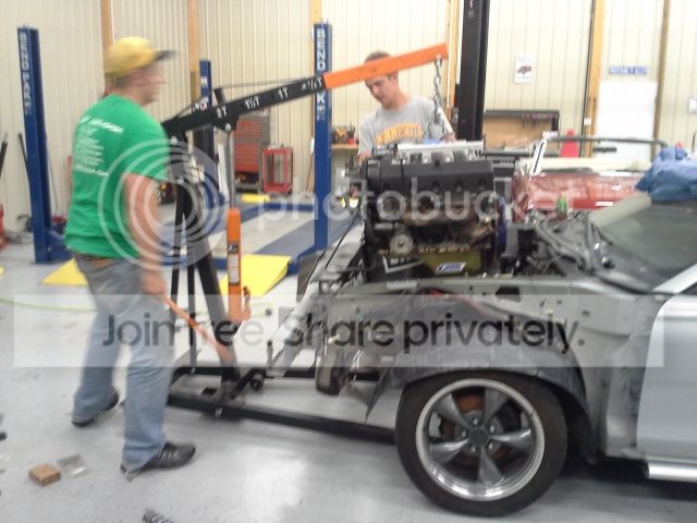

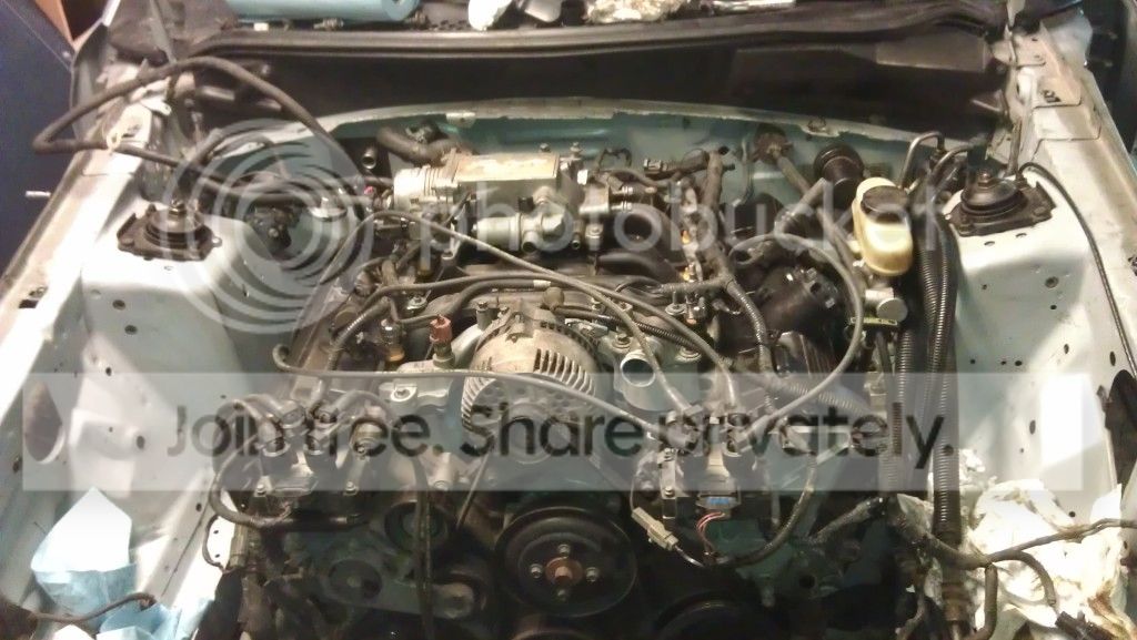

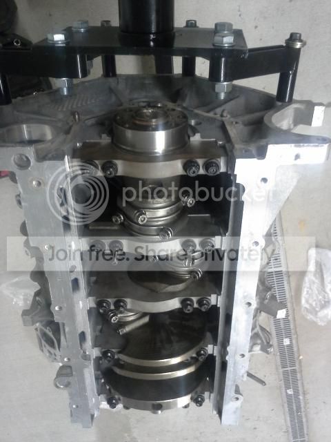

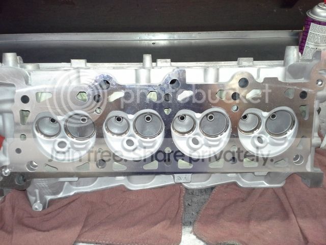

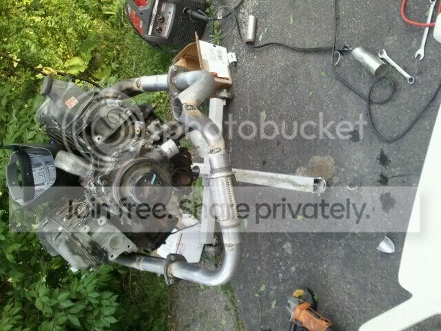

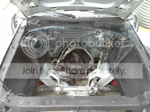

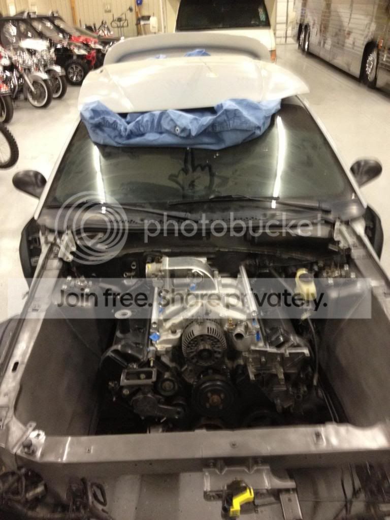

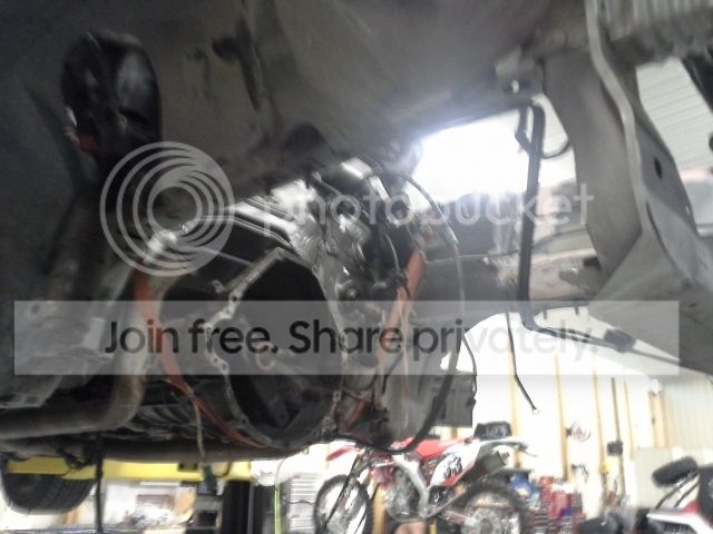

I have a 96 mustang that used to be a v6. Ended up putting a little 60 mm on it and had some fun. I did the split port top end and cammed it. Made a world of difference spooling the turbo and made a little power. The car made 300/300 and was fun. I blew up the v6 motor and found a gt car that the guy wanted 1,200 for. It was an npi car but cheap enough to use as a donor. I used everything from that car and sold the body and wheels and came out on top. I worked all the bugs out of the v8 swap and now the motor is out again. And that is where I am going to start posting from. Here are the pics of the car over the time I have owned it. I am now building a motor to handle some boost. Aluminum block, .20 over, forged pistons and rods with arp 2000 hardware, cast crank, a DIY port job on 2v pi heads, eddlebrock victor jr. intake, mhs 6061 elbow, eddlebrock fuel reailes. Main studs and head studs. Repainted the bumper and new wheels Turbo time No cam, just turbo at 6-8lbs Donor car V8 going in Porting my heads Some goodies for new motor build Painted my valve covers Motor out again for new build Trying to knock out smoothing the engine bay before it gets back from the shop. Hopefully more pics this week.

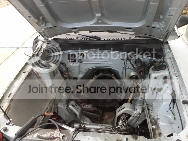

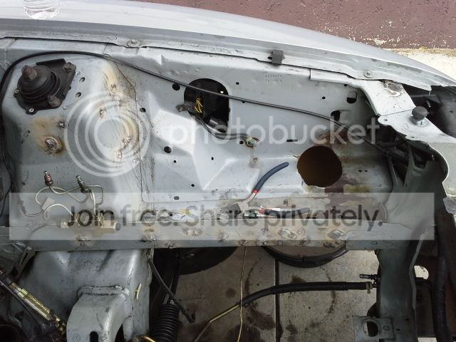

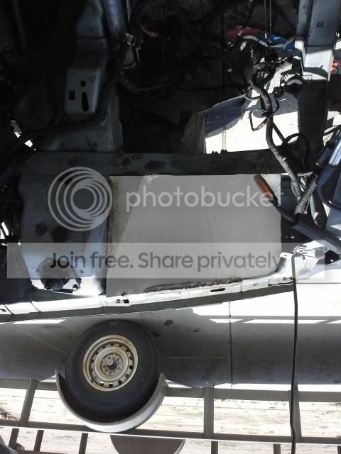

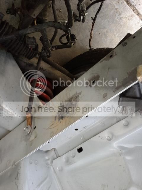

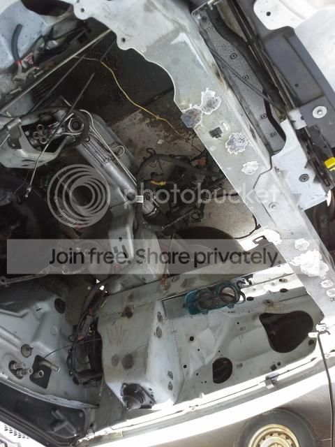

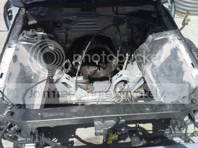

Everyone said I could shave the bay with a harber freight welder, so guess what... oh yea and this is how I learned how to weld on my own haha

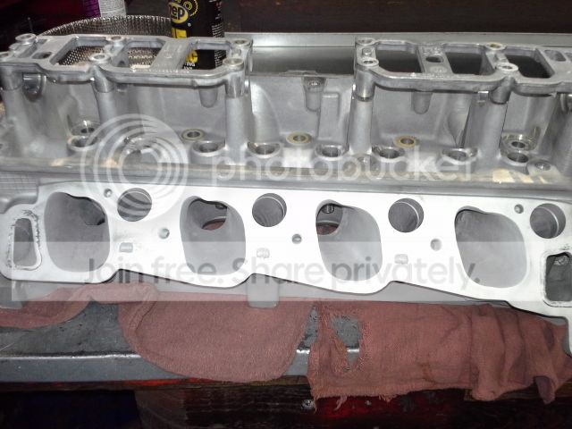

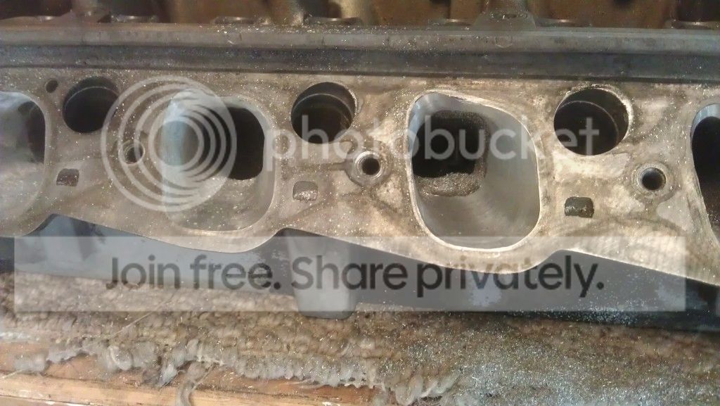

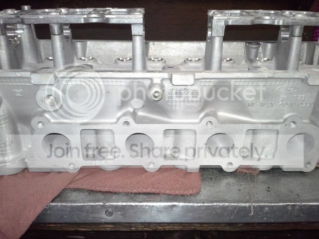

The heads I decided to learn to port with too haha, all I did was gasket match and took minimal material out.
Wasn't happy so I readid it..

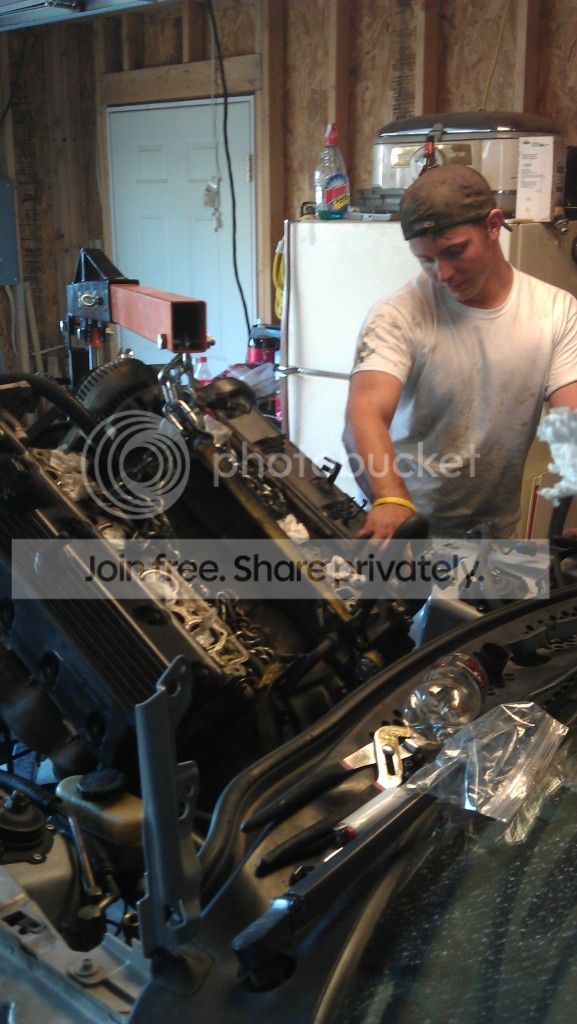

Off to my buddies shop where I will install everthing

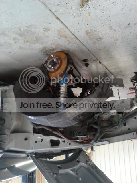

Scored a tubular kmember and coilovers

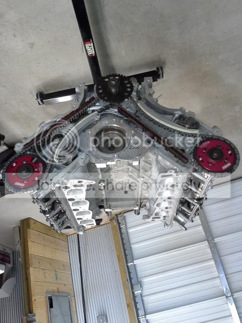

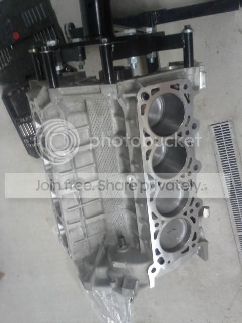

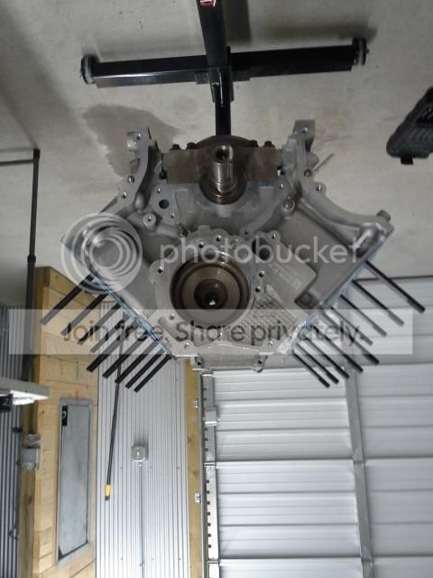

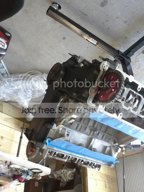

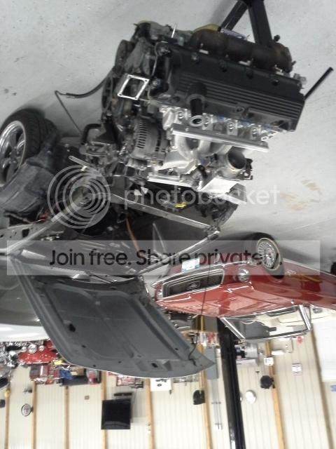

more motor progress
Took a break from my car and worked on my girls car with her and this is where it is now..

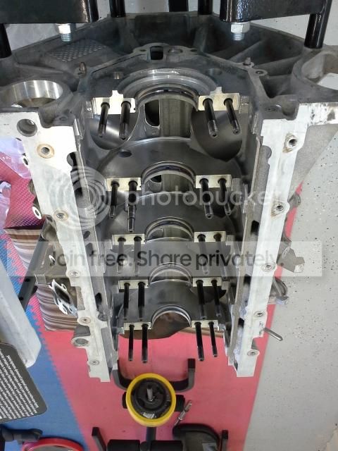

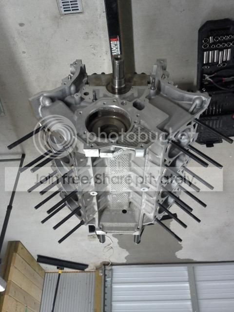

After three different main bearings the crank is in...rookie of the month again..

Oh yea, once I felt that turbo in MY car I fell in love. Yea, this motor was built for a turbo :) I want to do the on3 with the 76 mil. I really want to make over 500 with it. I scored the tubular kmember which will make it easier to start on the turbo since it required with the on3 kit.

Thanks! I have really been trying to do it right even though I am learning how to do things for the first time. Next is the dyno next saturday, then drive the crap out of it. I am getting it tuned on e85 too.
2V, eddy, pi heads, some compression, I have seen a few make some power, good luck and interested to see how this turns out....
Thanks, I am at least hoping for somewhere in the 600's. If not I will be disappointed.
