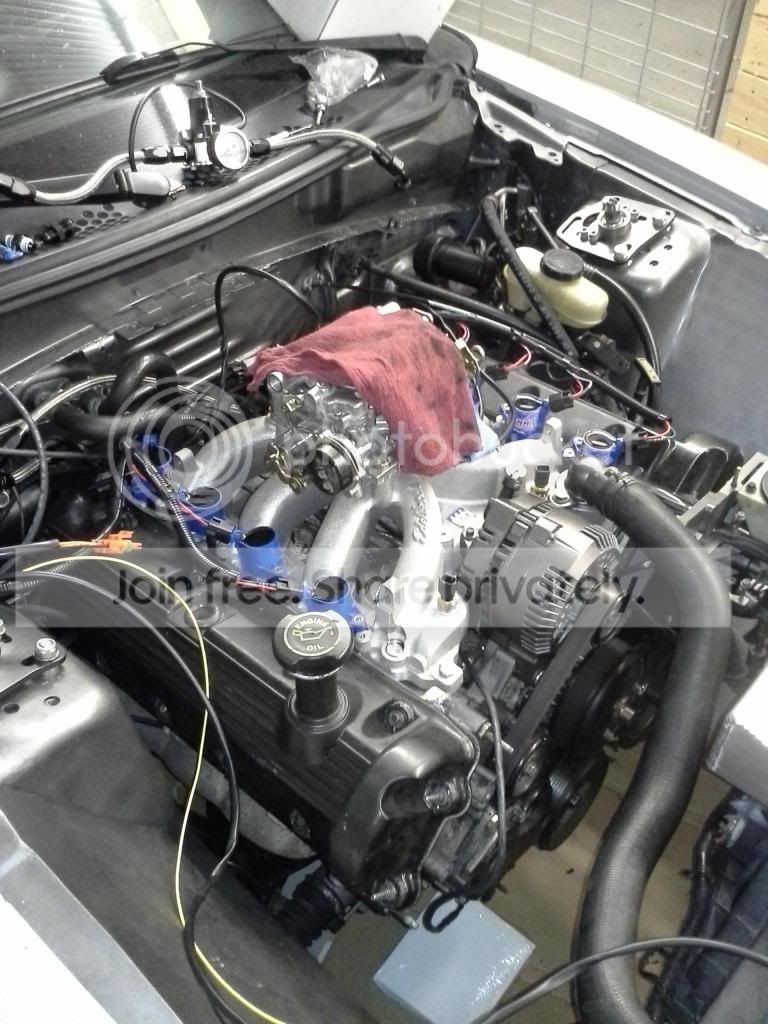

Here is how she looks so far. I am going to tuck the wires better after I get it all figured out and make sure it is wired correctly. I just need a temp controlled fan switch, wire the two step, tach and get an adaptor for the fuel line.

that's cool. I always wondered how a carb would do on a Mod.
if I may ask, what made you decide to go this route and how did you size the carb?

I honestly just got really sick of chasing down problems and not finding answers. It was getting to the point of not enjoying it anymore and was getting really burnt out on the car. Did some reading and found the parts I needed for pretty decent prices so I said why not. Plus it will be kinda different to see a carb on a mod motor. You have a bad ass car by the way..
It is getting really close. Almost everything is wired up, need to find a cord that connects with my computer to the ignition to get the timing table on there. I need to get the throttle cable put on and then get everything nice and tidy.
