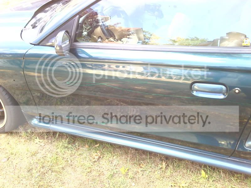

Here is what it looked like with the guards on.
Here is what it looked like after I used some fishing line to remove the guard and my wimpy electric power washer to get most of the tape residue off.
