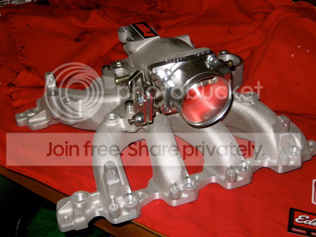

jwyche
Feb 26, 2009
46
98saleen88 said:
i beleieve its roughly 2000, i was thinking about a 5.4 swap, but sound the thought of having a stroker is always nice, but i already have a set of comp 274 xe (might trade for 278xe not sure yet) along with a ported piheads, and still debating on a type of intake, dont really want to use a stock pi one, actually thinkin of getting a custom fabbed one....
When you decide on an intake, consider the Victor Jr. I got it and a Dragon plenum and 75MM throttle body. The engine is still being built, but I think it's going to be great. When I ordered the Dragon plenum, I didn't take the size difference between it and the Edelbrock manifold, but a Sam O'Rear billet adapter fixed that.
