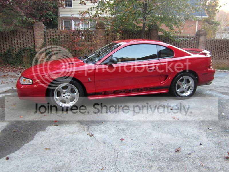

Hey guys , Just got this cobra in Nov. Trying to get the MPG's up. Last check it was around 13. Possibly foot was too heavy though. :D

real nice dude.....the only thing is i think i'd pull the decal but at least its a little different than normal......nothing like a clean stock lookin cobra
