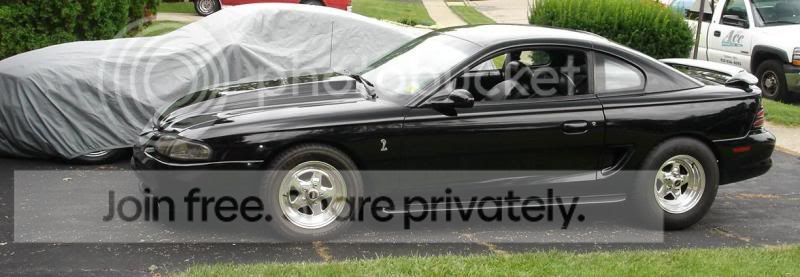

Objective for this build is to have a contender for the 2010 UMTR series. The platform will be a 1995 Mustang Cobra
Current mods include:
306ci SBF
Factory Cobra u/l intake
ported e7 heads
B cam
shorty headers
o/r X pipe
Borla dumps
stock T-5 w/ King Cobra clutch -TOAST
Hurst shifter
H&R springs -blue
sub frame connectors
...on a set of big 'n little Pro Stars.
Whats to come! :angry4:
Tremec 3550
Spec stage 3+ clutch
Custom aluminum drive shaft
Custom built rear end with 9'' ends
33 spline Moser axles
Auburn full spool
Ford 4:10 gear
UPR Pro rear suspension kit
UPR Pro front end suspension kit
D-Spec shocks all corners
Trick Flow topend kit
Huge 3 core radiator
SCT chip w/ Custom Mike Bell tune
The car is being assembled by none other than [size=10pt]Dayton Performance![/size] :headbang:
Stay tuned for progress pictures and updates.
