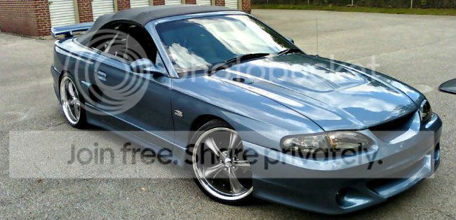

^now i realize my hoods not shut but even with it shut you can tell it had the same gap you do.

man after looking at the second set of pic it almost looks like your bumper i already hitting the bottom of your head lights. like its raised as far as the headlights will allow....
does it rub there?
does it rub there?
Actually it doesnt rub, there is a lot of free play. I can put my finger under that and move the headlights up. The headlight is missing one of the adjustment screws. I've been kinda busy latelhttp://sn95forums.com/member.php?8290-uncltrvlnmatty and haven't gotten around to getting the proper screws.
