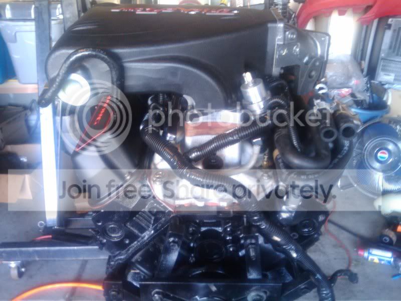

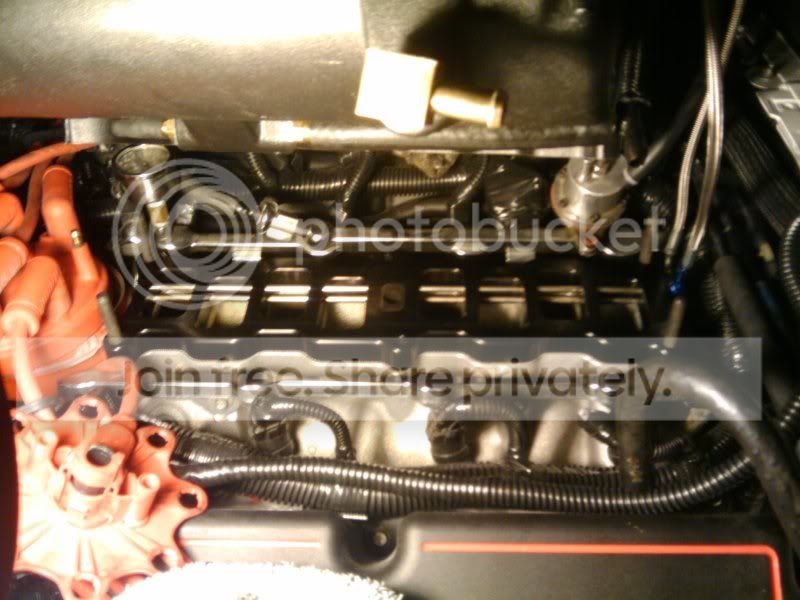

I just bought a 2000 explorer engine. Cleaned it up, and swapped it in. Im running a 100 shot wet plate system. If that one you looked at is a 97, check if it has normal GT40 heads(3 bars), or GT40P heads(4 bars). Depending on if it was an early or late production engine in 1997. Mine has the GT40P heads (4 Bars)

Its a p headed engine, i made sure when i checked it out. would the edis ignition work with the 95 comp? Do i swap my ignition over to the explorer 50? any tuning involved cause of the compression difference? i know the ho cam will go in but any other changes needed? thanks guys and birel thats a nice looking engine
