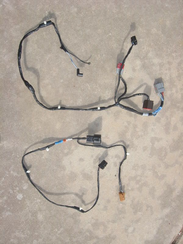

you have to splice some wires for the 12v by the shifter and extend some wires for the fog light switch.
pics:
on your right the 01-04 wiring harness and on your left the 94 harness
see the pigtail that has the letter" H" written on it? that for the fog light switch, notice that it doens t reach to the opening.
pics:
Nice shoes... :tongue3: :tongue3:
