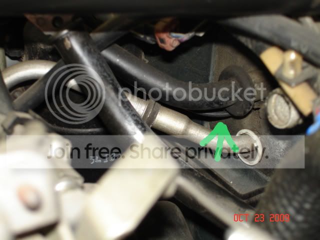

The only vac line I see is this one.
And it gets plugged into this canister.

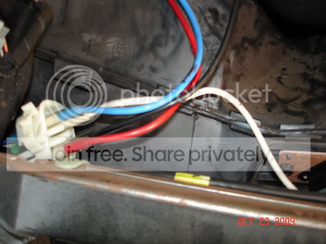

And then the black line comes from the canister and there is vacuum all the way to here. None of the other color lines have vac though...

All of the colored lines are the ones that operate the vent doors.
So you DO have vacuum in the black one when the car is running? Correct? Can you put a guage on it to see how much vac you have?
If you do have vac then the next place to look would be the control panel
