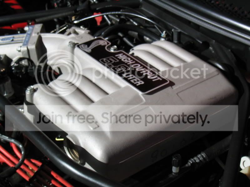

I have a 95R engine in mine ( 255 Engines were made out of 250 production cars, long story on how it got into mine) and even mine didnt have the 5.8L plaque on it. There was one made up for it but it was not an original 95R upper.
looks slow
