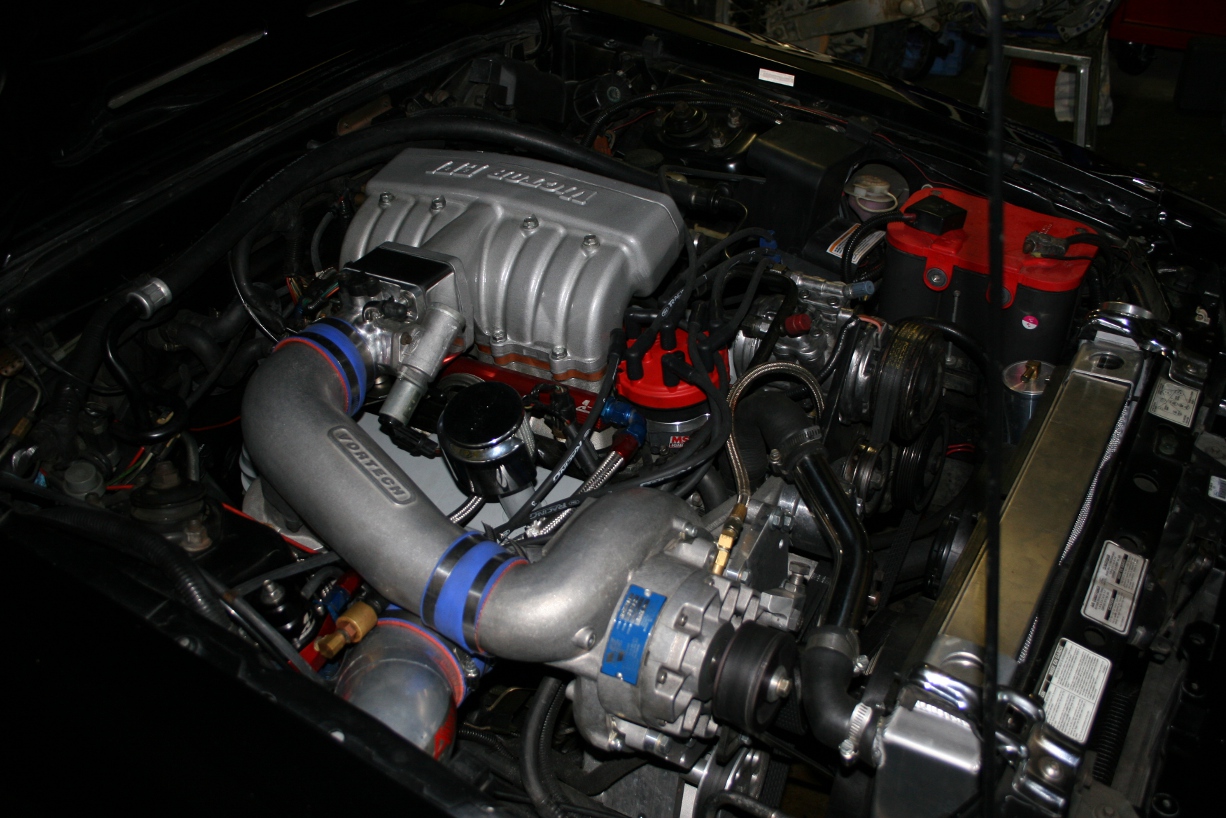

here is a older pic of my motor but you can see the fpr on the shock tower

I've put my regulator on the strut tower too before. Your y-block can be anywhere it fits conveniently, like just inside the engine bay, or near the rails. There is some flexibility to the fuel system.
