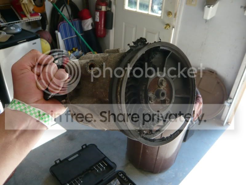

CompOrangeSN95
Jan 13, 2010
2,113
40
North Jersey
just food for thought, if you ever plan on using the car on a track I would recommend removing it... this is my air pump after a few laps on a road course.
