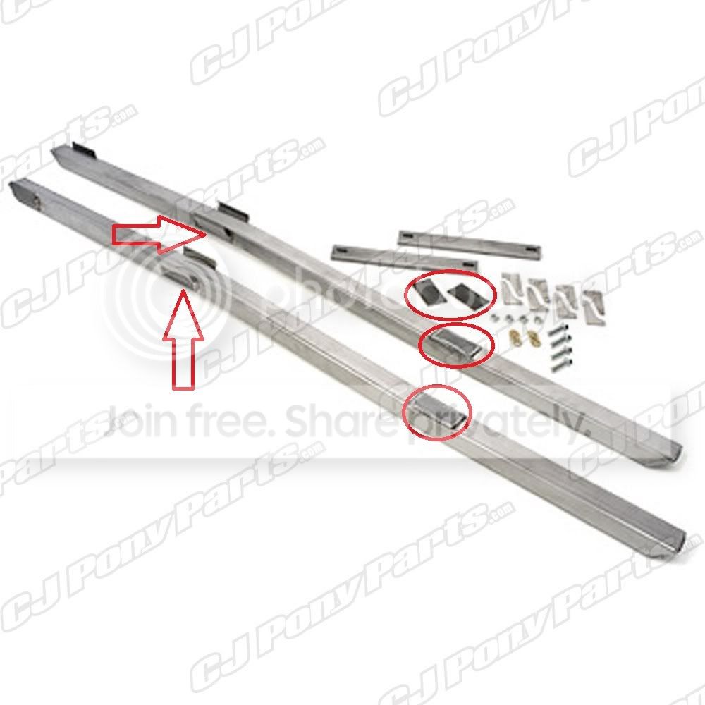

What are the stiffeners? Is that some of the other parts that comes in the MM subframe connector kit? I hope they have instructions for putting the stiffeners on if they do.
Musturd
Feb 12, 2011
11,225
3,676
There these little plates that go where the kinks are in the subframes
They should be welded on at the end once the connector is up in place. My theory is they left them off to allow the connector to flex for installation since most likely it's not going to fit perfect.
