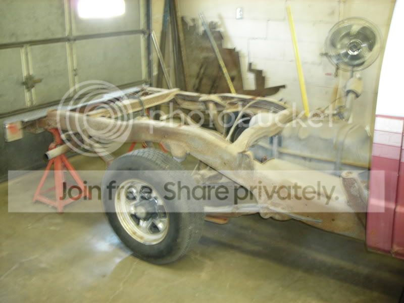

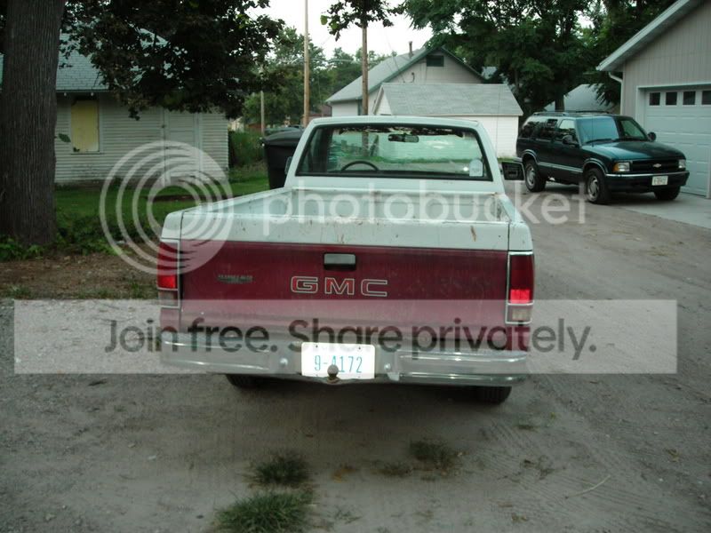

this body(chitty pic i know)

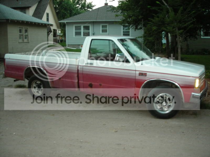

onto this frame...my gpa loves this truck, it will be TONS better after the 48 body is on

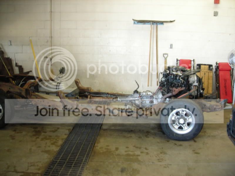

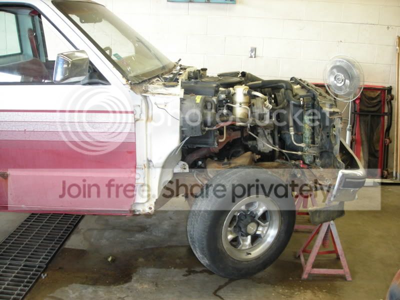

well, I got the box off today, along with the hood and a couple front clip things. The box turned out to be a pain. Could hardly get the impact on, but when i did it didnt have the juice to get em off. So i took a breaker bar to em. It felt good to get it off. Tomorrow will be the front clip, fenders, lights, grill, maybe cab if we get around to it.

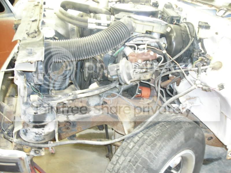

Updates for those that care, its kinda slow, but yet fast. The fenders had something like 20 bolts in them a piece, and i learned why 'J clips' are referred to as jesus clips now....the damn thing kept spinning. We finally got it out, then the fenders came off, with a little persuasion of course. I busted open 2 of my knuckles today, im sure that is just the start. Slowly but surely its coming. Radiator and such is tomorrow.

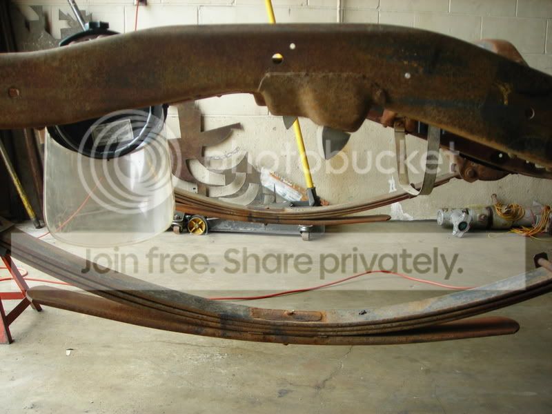

Update pics, got the cab off today, obviously. You wouldnt believe how much of a pain the E-brake cable was. When i was takin off one of the cab mounts it started spinning, but its basically a big screw. I guess it rusted at the end and wouldnt come out. We just lifted it over the mount haha

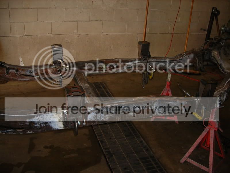

I then torched and ground off the body mounts makin the frame all smoothy smooth

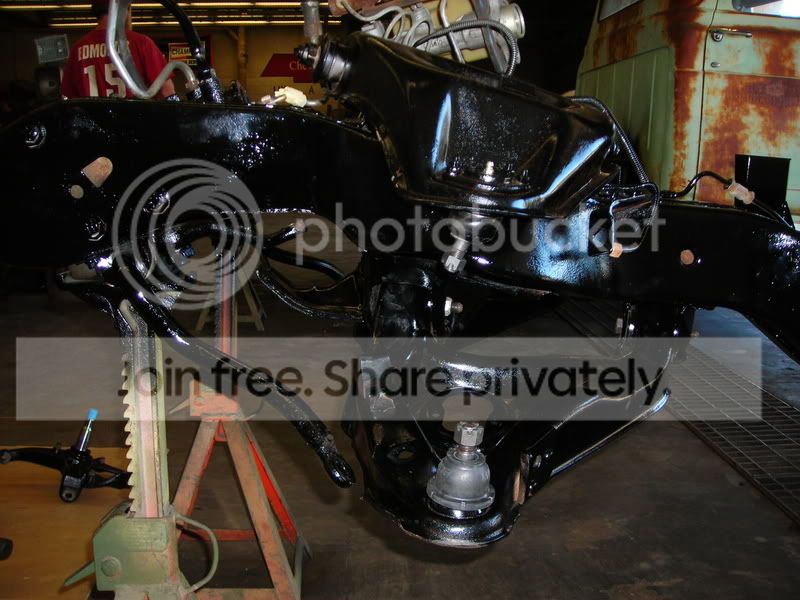

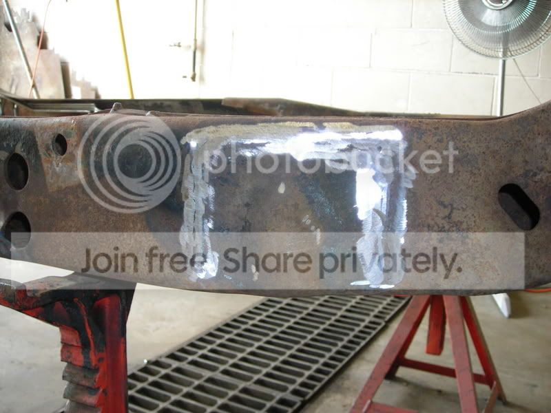

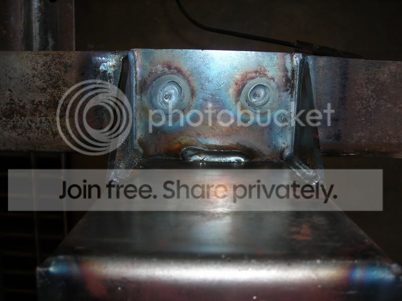

These next couple you can see the frame prep we did, "marine ready" to get rid of the oil and grease then "metal ready" to help it bite into the rust, the white residue you see is zinc that promotes adhesion

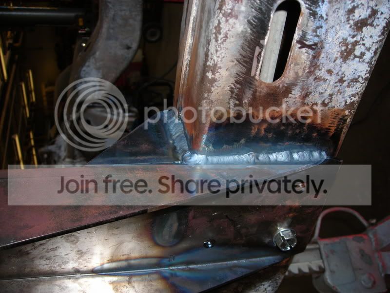

TIG welded on by my autos teach...stack 'o dimes

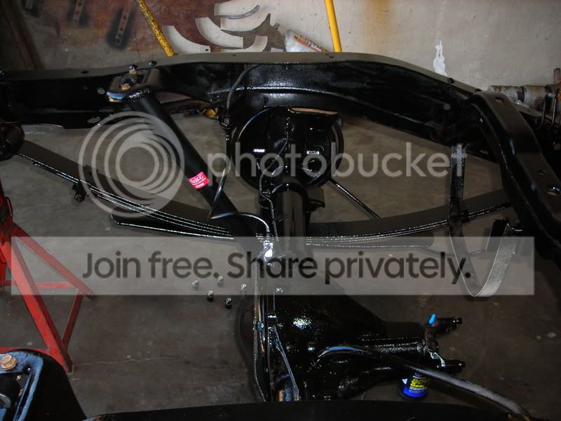

theeeeeen, we threw some paint on....HUGE difference, even painted the spings and spindles n such

Ive also got one shock and one strut bar 'rod' in. Along with the spindles and spings. Basically brakes and shes done
