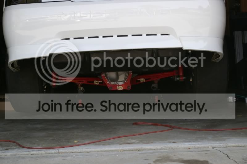

Thanks i am trying to get it ready for next year. From working on the 98 i have learned that it comes very fast. I have all my parts for the new rear end build up i will post up pics. it Consists of a new 8.8 rear end that has been squared and welded, 373 gears, 31 spline moser axels, Eaton posi rear, TA Performance Girdle

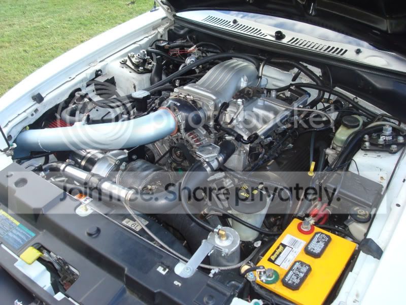

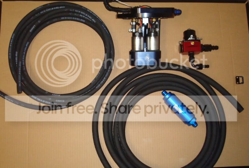

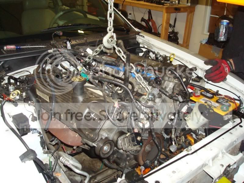

:D wow have not been on this forum for a long time!! looking at my old posts i thought i would update the thread. The cars best with the stock motor and p1sc went 11.61 @122 mph. i sold the procharger and started paying for my new motor from mmr its a 281 stroked to a 302 stage 3 heads and stage 2.5 mhs turbo cams. then found out i had to do a big move from CA to WI :(. now im back trying to put this damn thing back together. waiting on my new trans to be done then its off to the dyno!!!
return style fuel
T76
NEW REAR
first drive around the block

that's quite an update! what are the goals for the new combo?
kennyz
kennyz
Jul 23, 2006
245
24
Don't really have a goal. High 600hp to 700 hp would be nice. But as long as it runs good I'll be happy

AWESOME! What manifold/plenum is that?
lower intake is a edelbrock vic jr then a 2" spacer to clear the alternator and then a sullivan upper intake plenum

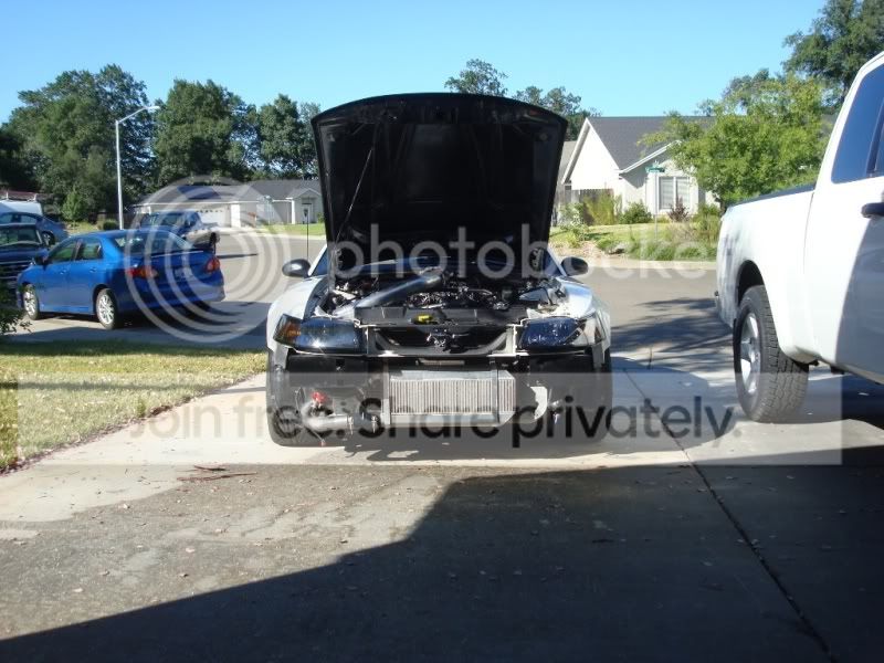

Holy crap found my old posts on here. Well here's an update.
http://youtu.be/WtC3b6uyvnk
Car made just under 600 hp on 12psi :). Maxed my maf out so I've changed some things and heading back soon for 20psi ;)
