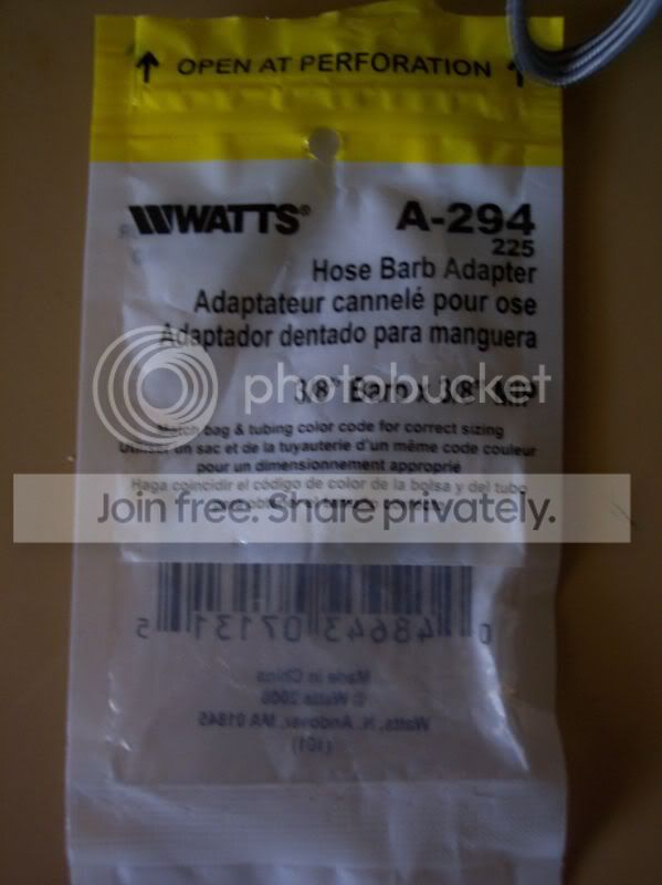

2) you will need 2 (two) 3/8" NPT x 3/8" MIP adapters, $2.48 each at Lowes. likewise, i didnt take pics of these before i installed them, but i did take pics of the labels. in the post install pics, they are 2 brass fittings on the top of the filter.

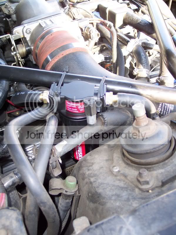

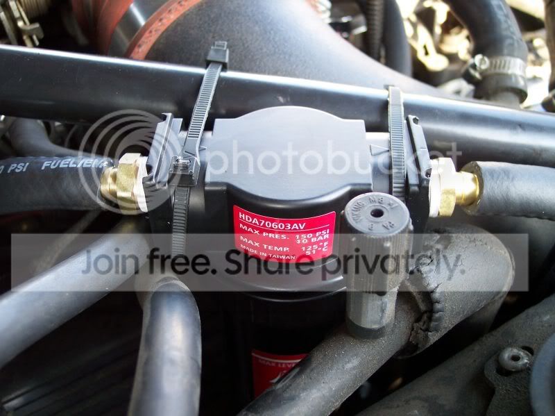

1) the filter comes assembled, all you have to do is put some of that thread tape on the threaded ends of the adapters, and then screw them into the top of the filter.
see the picture below so you can see how the fittings fit.
2) next thing you need to do is find a sutable mounting location for your oil seperator. i zip tied it to the strut brace on the passanger side. i like zip ties because i can fasten them to anything, dont have to alter anything, and they will hold. only down side is they arent reusable
3) remove the tube that goes from the PCV to the plennum, including the rubber at the ends. you wont need this tube anymore, but i suggest you dont discard it, instead save it somewhere.

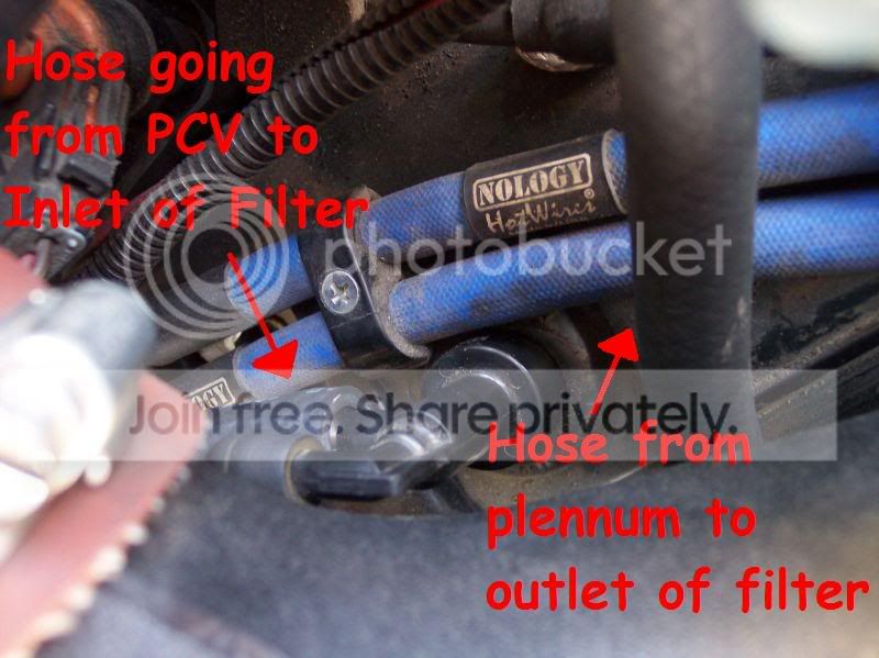

4) from the 3/8" hose you bought, cut enough of it so that it reaches from the PCV valve to the inlet of the filter. i pointed the PCV valve towards the back, and routed the hose behind the fuel pressure regulator and into the filter.
5) now, with the rest of the 3/8" hose, plug it into the outlet of the filter and then plug the other end into the plennum. i routed mine similar to how the factory tube was routed, but then i routed it under the intake tube and then up to the outlet.
6) if you want to, plug a piece of the hose to the bottom of the filter (drain) so you can have easy access to drain it when the time comes. me, ill prob just unscrew it and then drain it back into the engine.
and the finished product:
now you're done. im not sure how often you have to check it, or drain it, but i will be checking it daily for at least a week or two to see if i can see a pattern going.
