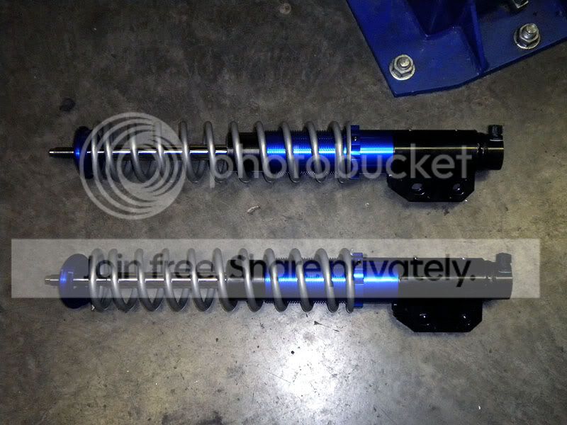

Hey everyone, I was seeing if anyone had any coilover pictures of how the coilover is supposed to be assembled. I've got mine assembled, but it just doesn't seem right for some reason. I've got the kit from UPR.
My problem is...
I've got the body over the strut where the adjuster nut is, then the coil, then the top 'plate', then the washer, bearing, washer, & then the other top plate, and then the spacer. All of which is under the caster/camber plate. When I adjust the the adjuster to lower the car, the coil slides up and down the coil and comes seperated from the top plate stuff. It just seems that if I hit a bump of any sort, that everything will not stay lined up?

This is what I have. Everything in the picture is under the CC plate. The big blue circular piece sits in the top of the coil, then the washer, bearing, washer sits in the bigger blue piece. Then the smaller blue piece sits on top of the bigger blue piece, thus covering the washer, bearing, washer. Then on top of the smaller blue piece a spacer sits on it, and then it slides up into the CC plate. And then the strut nut is on top of the CC plate. If that explains what I said above better with the picture below.

To the OP: The UPR kit is a cheaper MM knock off. If it works anything like MM stuff, then the upper perch should be sitting on top of the strut still completely sealed, despite the springs dropping down or not. Springs dropping down is just what happens when shock droop exceeds the spring length. Don't worry about running over bumps and losing stuff. Believe me, if your springs become fully unseated on the street, you will have bigger problems, such as landing from that 50 foot jump you just did.

i used to have the UR kit. i think i had the same problem. you're saying that when you jack up the car the top plate that sits against the CC plate slides down and is no longer touching right? so then everything is lose? thats the problem i had. and i would have to put the big blue ring back inside the top of the spring before i lowered my car down. thats a pain in the a$$.. i wasnt happy with that kit and it made alot of cracking type noises when i would hit bumps and turn. its a cheap coilover setup but not something that i would ever buy again.
