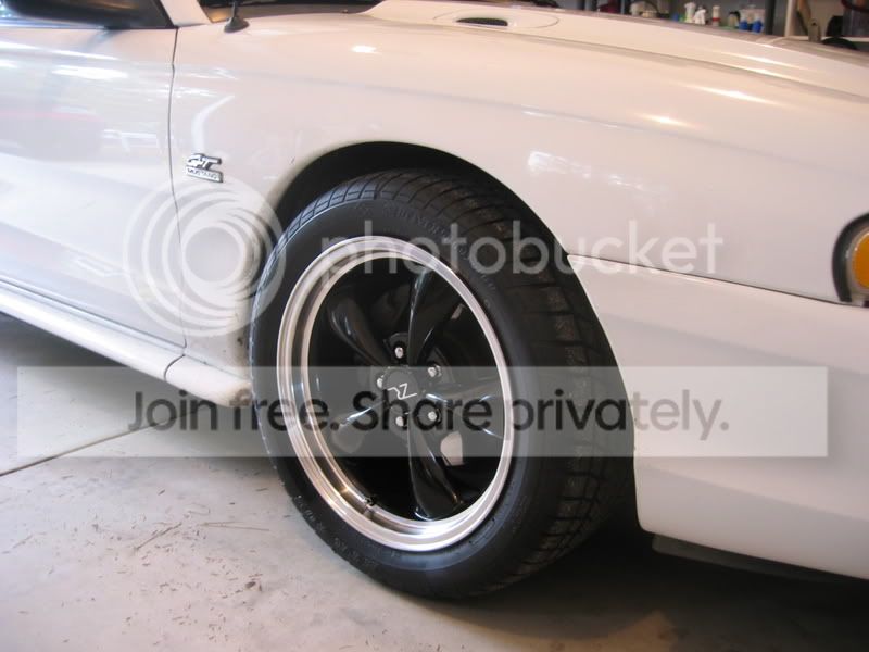

I had 275's on mine briefly when I put the 315's on the rear.
It drove fine with no rubbing, handles a lot better than the 255's because of the extra width.
The offset depends on whether it'll rub or not.

The black american racing bullitts I'm looking at have a 24mm offset. And the ones on American Muscle have a +33. Which is closer to what I need without rubbing?
Mustanger, yes! That is exactly the stance I"m looking for. I can't afford to lower mine right now. I'm going to have so save up for that. I'm hoping it will look ok with the stock height and that wheel tire combo for a while until I can get the dough for the parts. what kit do you have?

Sway bar on the left side.
It actually rubs the rim a little if it's lock to lock. These Potenzas run narrow, compared to the Gforce sports i used to have on the front that run wider. When those were on it would just rub the tire.

I did all the front end components, ball joints, tie rod ends everything that then put the 275s on...As my first set of tires wore down it tracked some Put new tires on & it feel great...no real tracking to speak of but instant turning response. It IS very quick to respond! I love it.

When I put my 275/315's on, I didn't really notice any difference as far as tracking goes. I agree with others, Mustanger, your stance is perfect with those wheels, can you post or link to what springs/iso's you have? I think I read it somewhere on the suspension pages but can't remember.

Thanks RedRider...it is the Eibach Prokit Plus complete suspension. Eibach Struts & shocks with stock Ford isolaters. Not a bad DD setup at all, handles wonderful in the curves got very good reviews in the Mags. I have a lot of miles on them & want Koni's or Bilsteins next until I can swing Air Ride.

I run 295s up front as a DD set.. Blew out 2 rims so will be switching to a 275 on an 18. Then redoing the 17s for track use(still sticking with 295s all the way around).
Btw. No rubbing issues except sometimes at full lock. sometimes.
