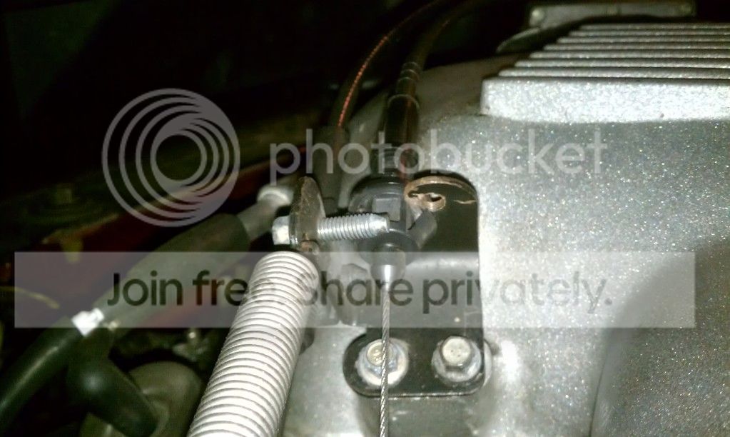

Too bad the replacement clutch took a dump. The FRPP King Cobra should be a decent piece. When you get a chance please post a pic of how you modified the V6 throttle cable to work with the 4V. I agree the 4V cables are rare and expensive when they pop up for sale.

For the throttle cable, I just hollowed out the stock bracket with a dremel until the v6 cable was able to slide into the bracket. One of the screws rests over top of the cable's mounting piece which keeps it from backing out through the top. It's been fine like this for about a year and a half.
