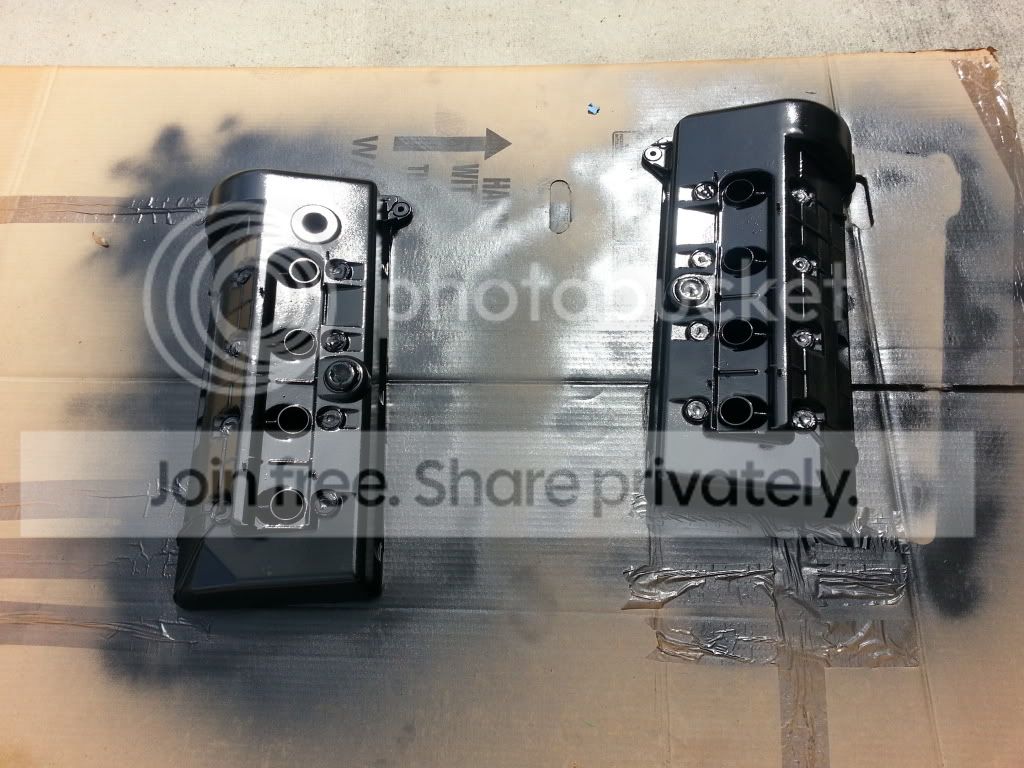

cleaned and painted my valve covers. they look amazing I cant wait to see them on the car
