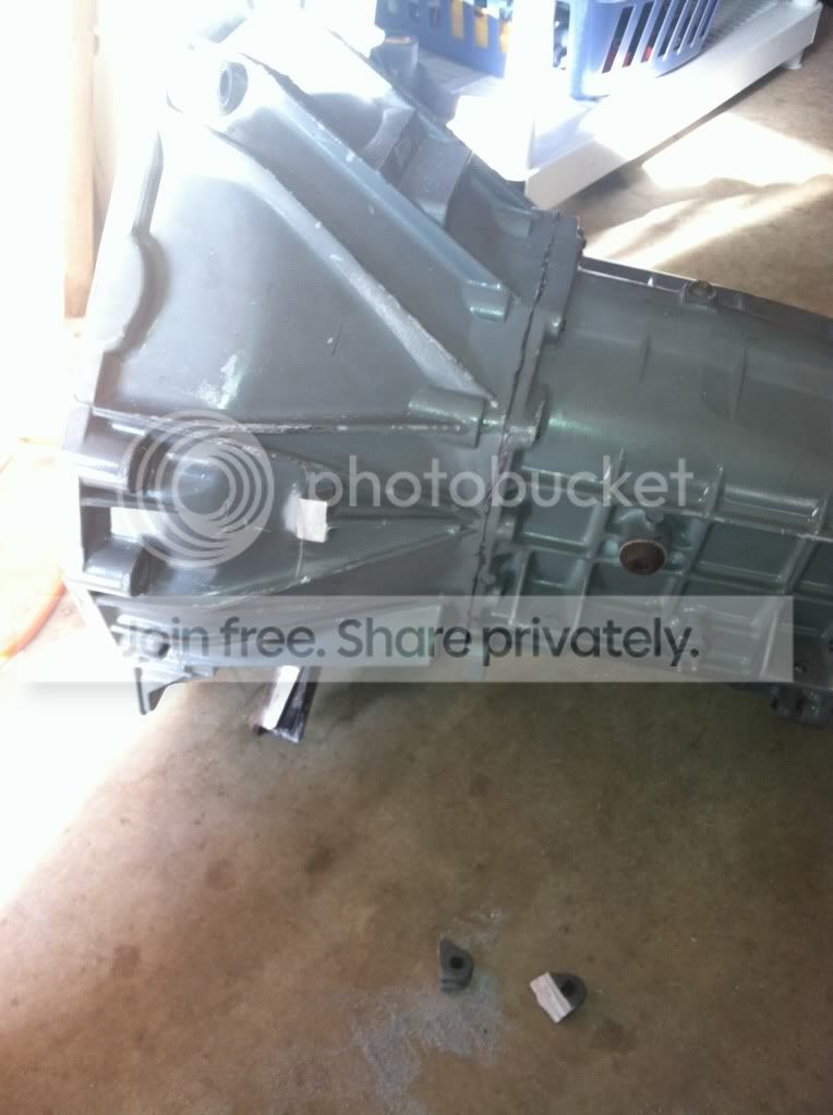

Save yourselves a ton of frustration and sawzall off the casting ears before you put the t45 back in. It makes re-installation sooo much easier, especially if you are working under jackstands with limited clearance. Just be sure to sand/file them smooth so you dont cut your hands trying to secure the top 2 bellhousing bolts. Lots of long extensions and swivel sockets will make the job much smoother.
