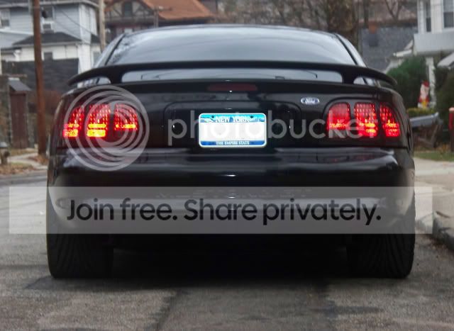

Depends on the tire, some look lined up and some look a touch in.  Mine are close but not perfect, i have 295s. Probably the best pic i have to show it:

did u have to do anything to the wheel wells to fit the 295's? what bout the quad shocks?
Well I had removed my quads prior due to lower control arms so i don't know if they would have hit or not, but other than moving one of my tailpipes over nothing else had to be modified.

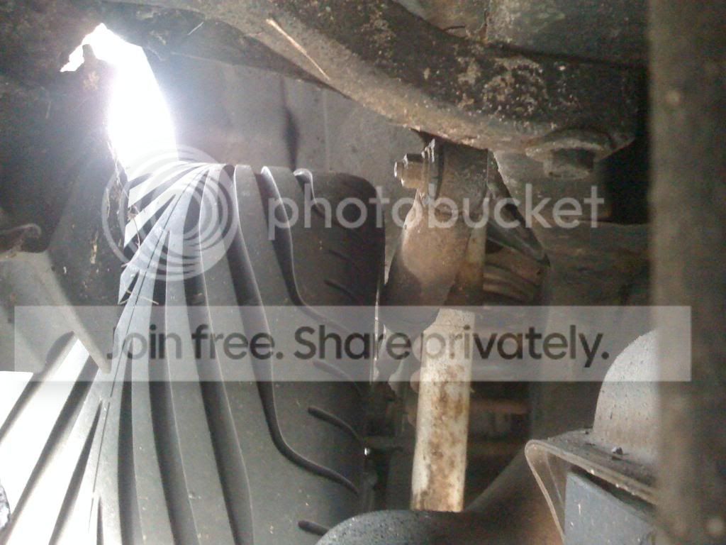

I still have my qua shocks on the car and as i stated on the other thread i have to beat the inner fender wel, due to the tire rubbing against it in real sharp turns.
on the next picture, if you look on the very top of the tire were the tire and the fender well almost touch.

Is that a 295 tire jav?
