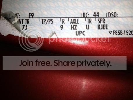

I'm pushing towards the gears being 3.08's. The 96' and up have the 4R70W transmission. Every time I get under the car (which is all the time), I always forget to check my rear end for the ratio numbers. Everyone says these sn95's have the 2.73's in the automatics but after reviewing a chart, having 2.73's would SUCK. Based on the chart, 70mph will set me at 1700rpms with 2.73's and a tiny tad over 2,000 with 3.08's. I'm at 2,000 at 70mph.
You can also look at the sticker in the drivers side door jam and look up the axle code (providing it's still stock). 3.08s sound about right. Mine has 3.27s and I'm at 2K rpms at 65mph.

Also, 3.08s came standard in the auto cars I believe.
Yep. You're right. Inside the door it says under AXLE HZ. Z is for 3.08's. M is for 2.73. And E is for 3.27
I'm sure 2.73's would be more towards a 5 speed's stock ratio.
