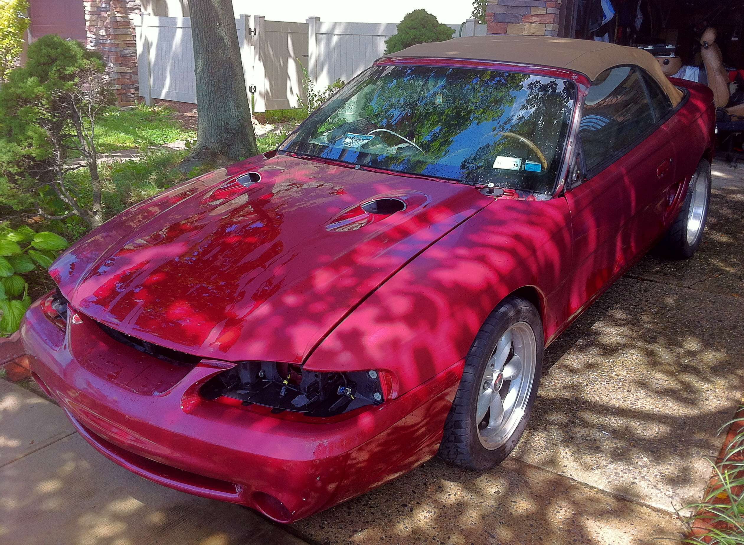

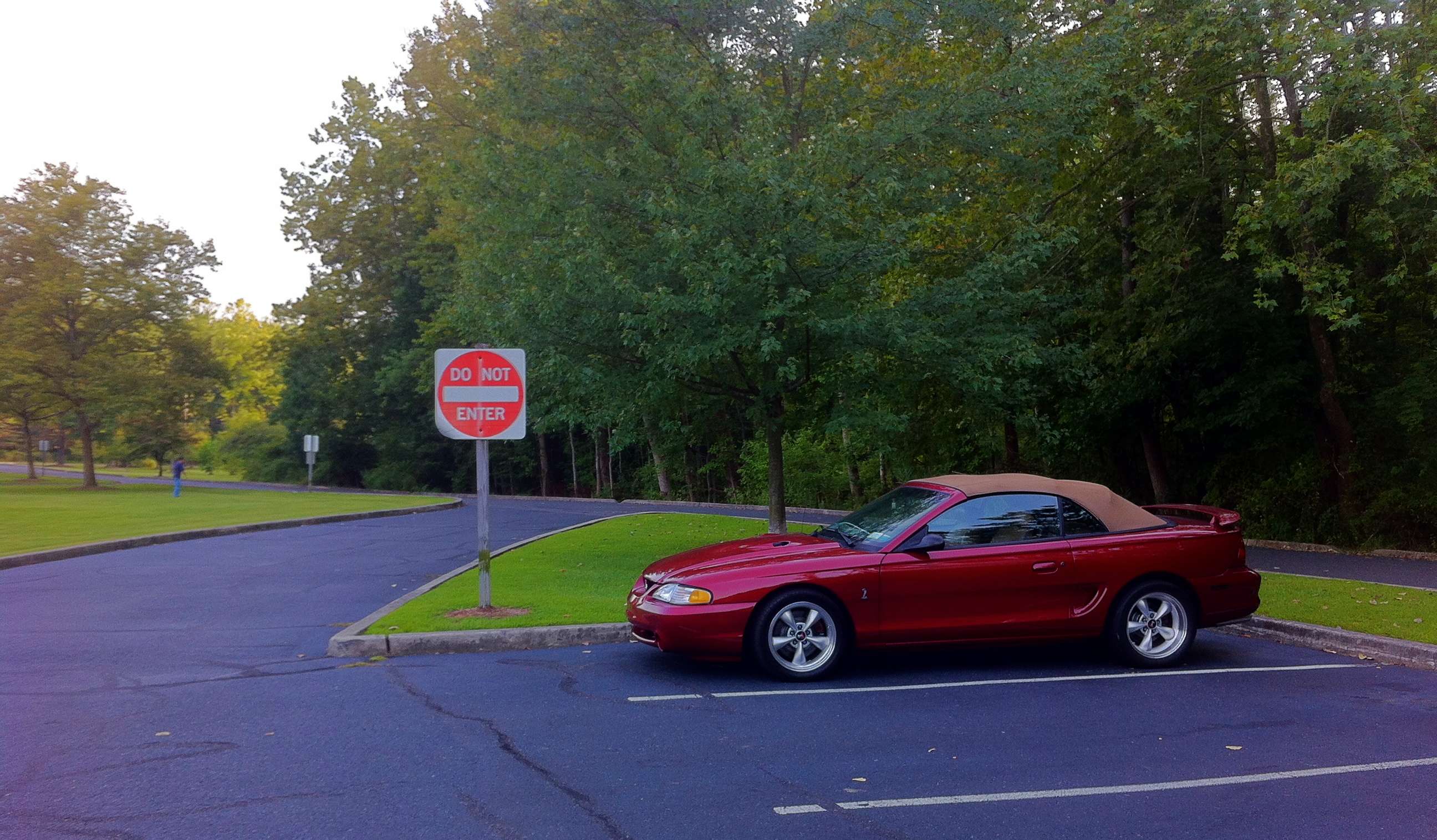

Some inspiration for ya buddy(not to whore up your thread)

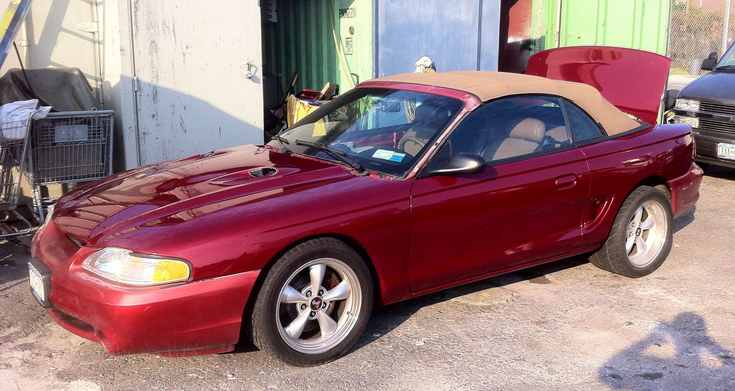

First painted sans bumpers:
Done(pre color sanding):

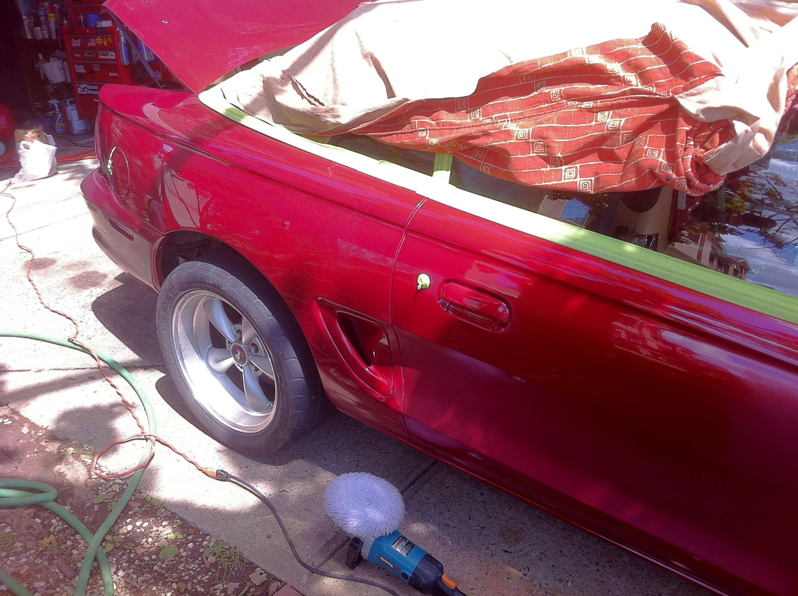

Doin' work:
Cutting/Buffing:

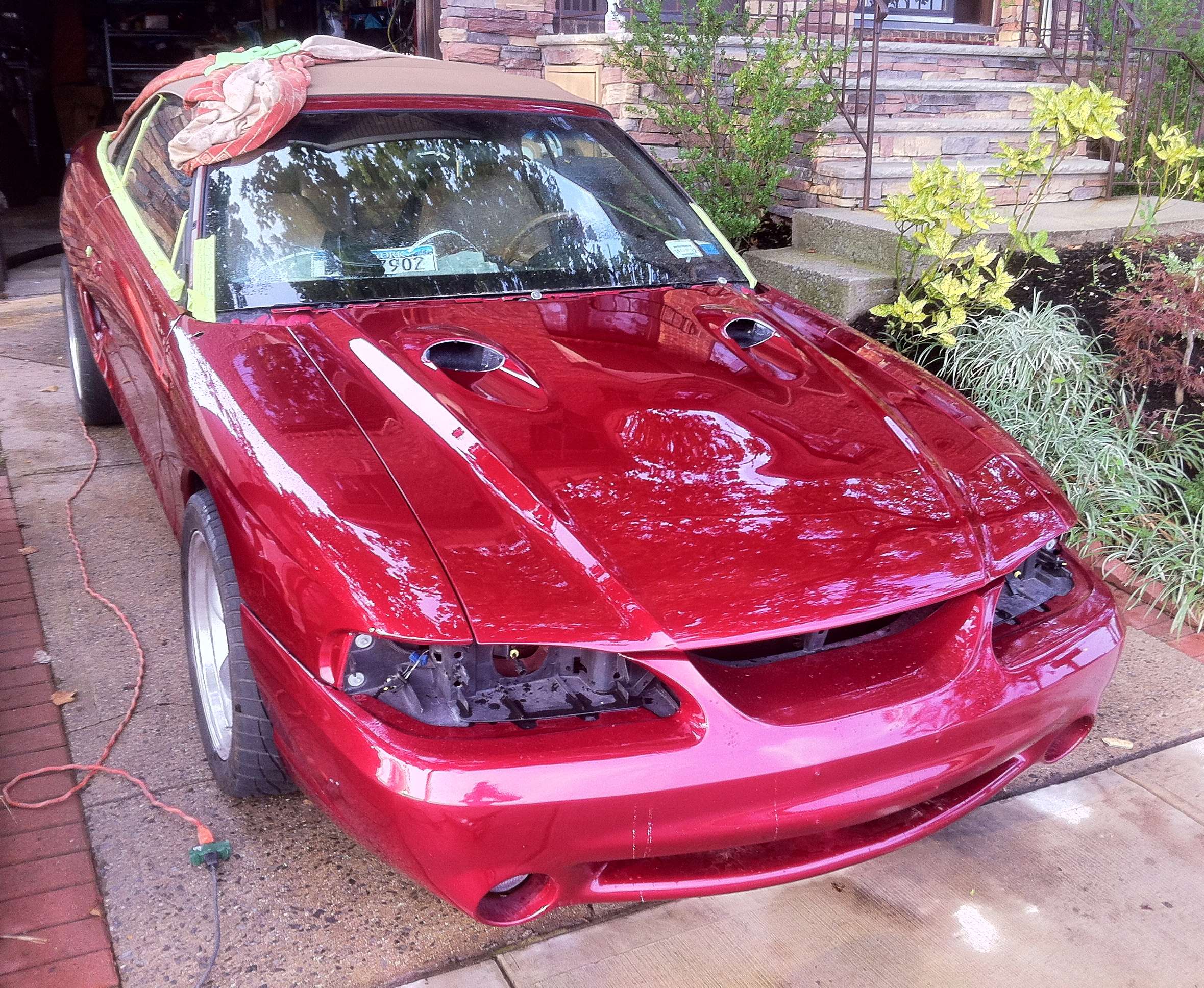

Results with no wax on it yet and still not complete for the most part:
Hope THAT cheers ya up :)

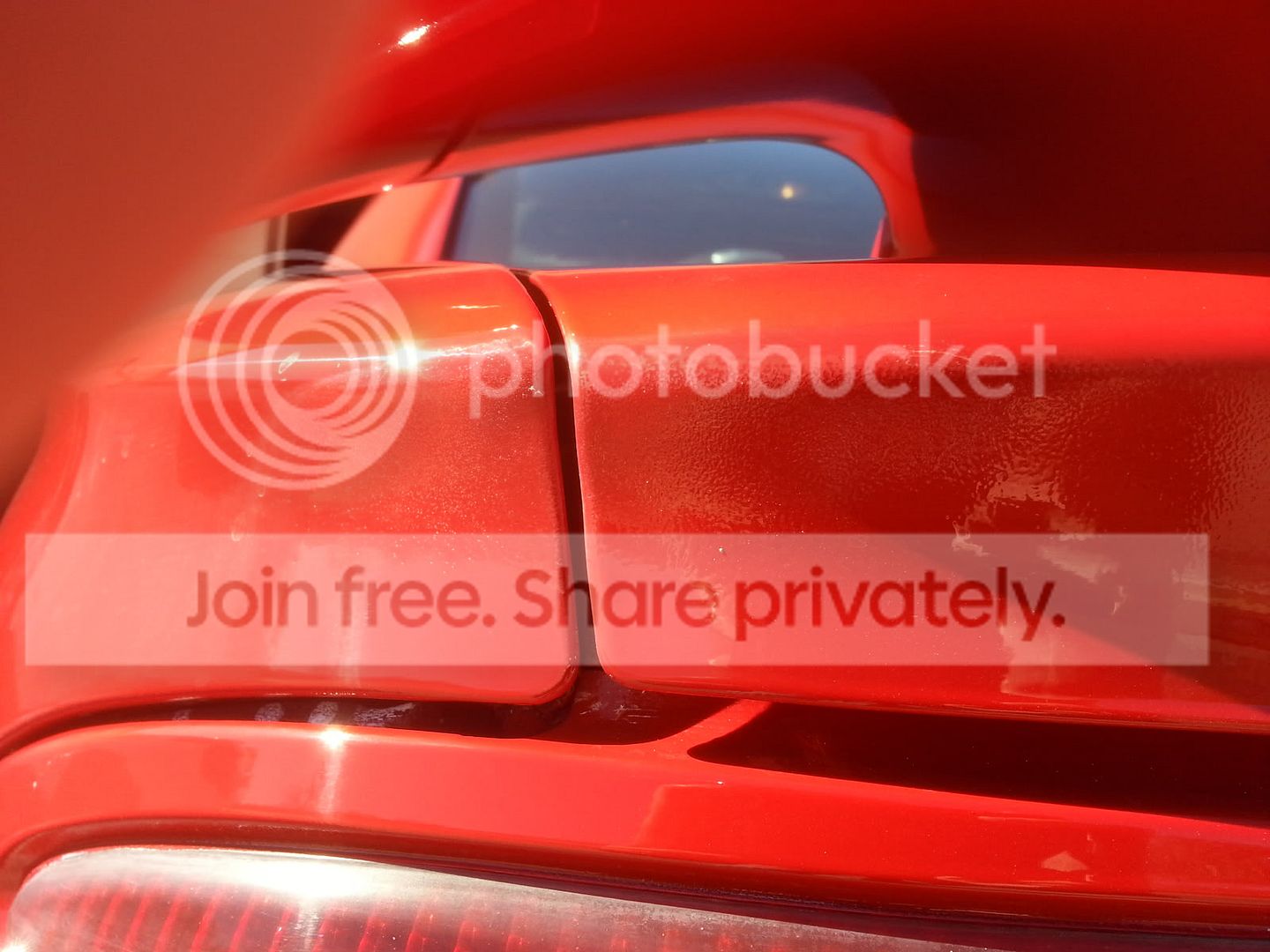

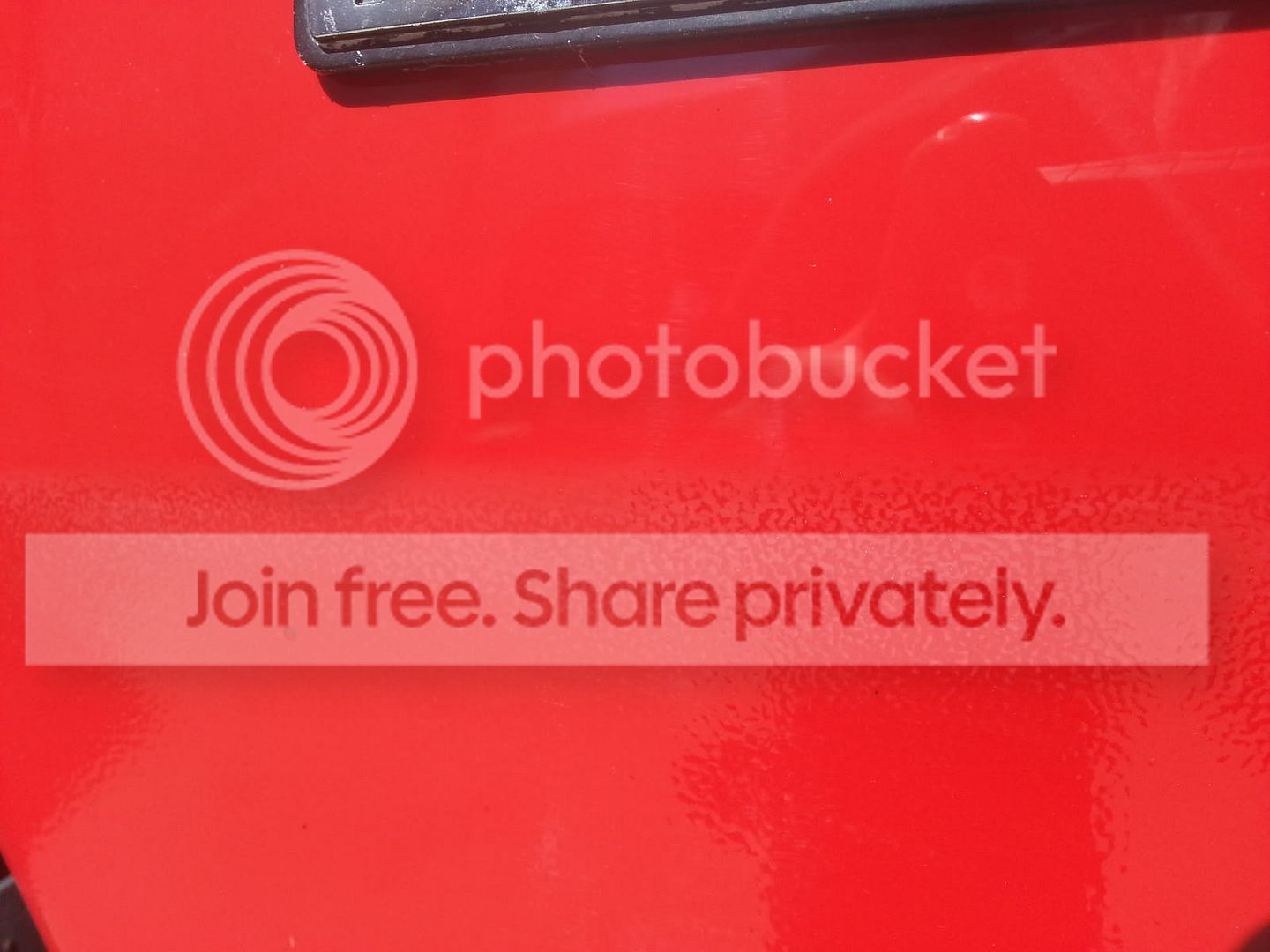

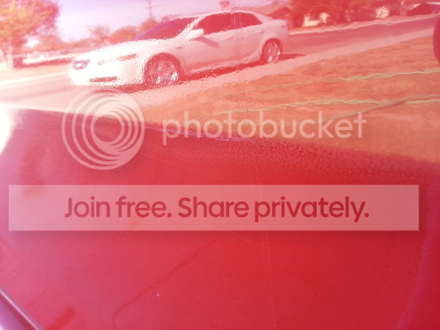

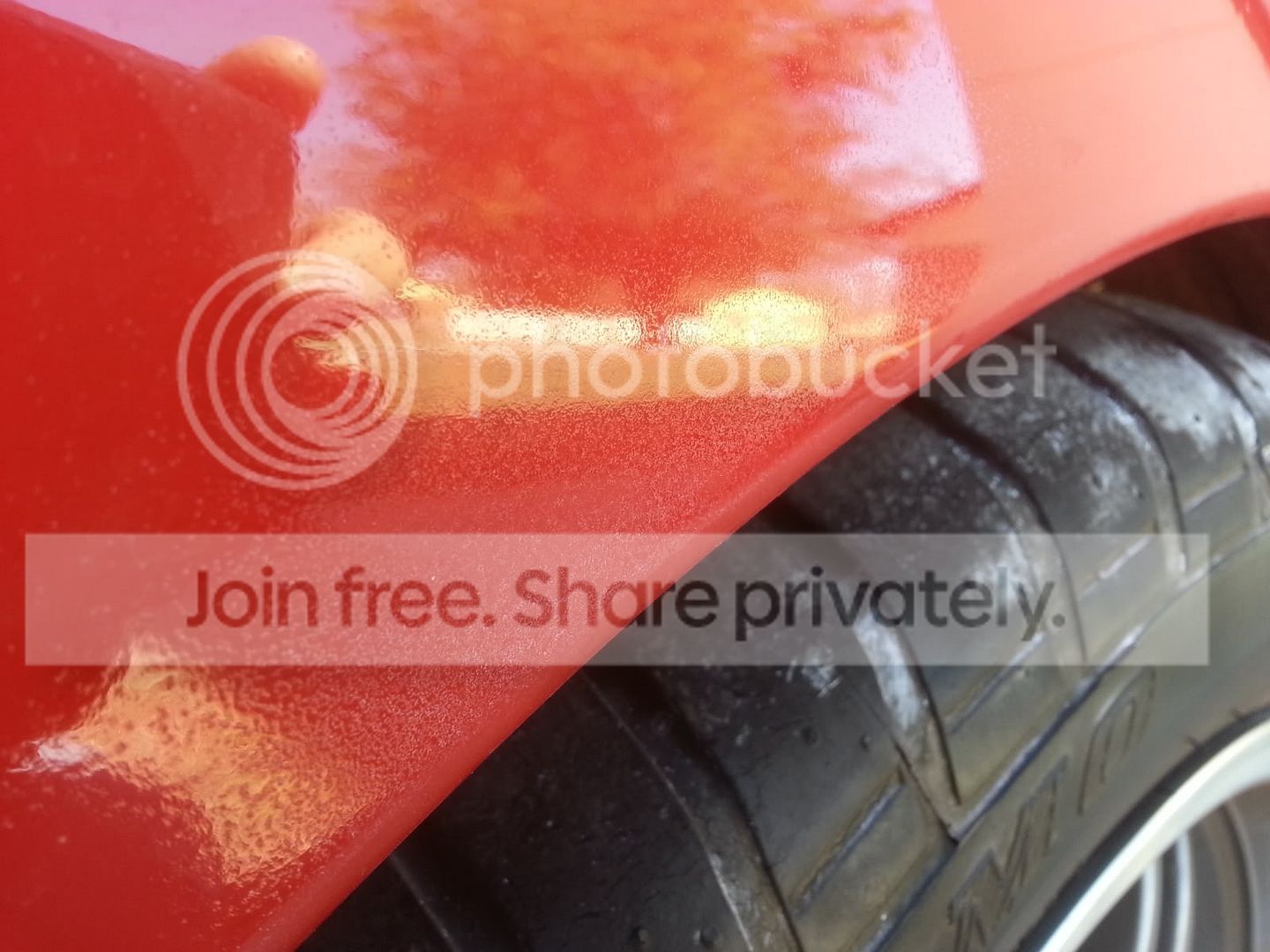

Greenscobie86 thanks for the pics. I can't see them right now due to this damn government computer but will check them out when I get home. Here are some pics of the places that are bugging me the most! I hope they work as I usually have a fit posting pics here for some reason lol. Any advice on correcting the paint is welcome. I am new to this and don't want to screw it up more than it already is!

That looks like the clear got contaminated. Best bet would be to re-clear it. But I would try to sand/buff it first. From the looks of it I don't think it will buff out.

A clay bar isn't gonna help you at all. The other ones could be sanded out. But the fender one looks pretty bad.

Hopefully you can fix it. What you have is not dry spots. It looks like they didn't clean the surface good enough and the clear reacts with the contaminated area. Usually silicone contamination.

90% of that is simply orange peel. you can def rub that out to look 1000x's better. i would 2000 grit, then 2500 grit, then 3000 grit. buffing compound, then polishing compound. the fisheyes are the only thing ya cant rub out usually cause they simply are holes in the clear kinda, lol. but most of that is good 'ol orange peel my man. pretty sever orange peel yes but for 1400 you wont get great paint.
do you own a good buffer?

you dont have to do the whole panel. you can feel it blending and smoothing while your sanding. just be careful and patient so ya dont burn throuh your clear. as soon as ya start to feel it get a little smoother. stop.....spray a little water where ya sanded and wipe off the milky shit to see where your at. its really no biggy just takes a good eye and a little patience. i am 100% positive you can smooth almost all of that out!!

[/QUOTE]see all the light dull kinda faded bumps? that whole panel prolly looked that way, they just got lazy and didnt finish cutting and buffing. if they would have continued on they would have got all that out as well.
