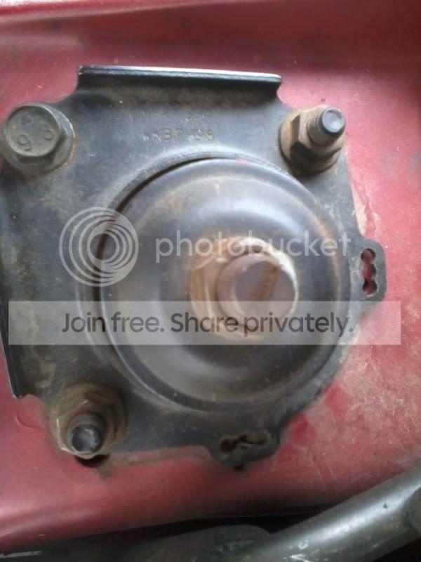

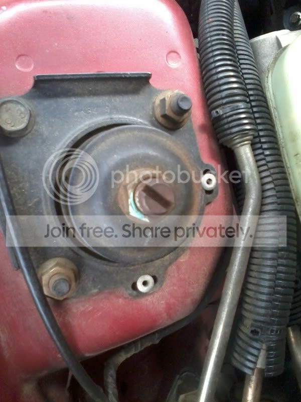

aside from the torn boot on the passanger side i noticed this
This is the drivers side
These two are of the passanger side those two silver pin type screws in like in the driver side snapped off and are no longer on the passanger side
pay close attention to the next picture by the bottom bolt it looks like the plate actually has slid up from its original position?

If I were you I'd be scared shittless to drive that car without changing the BJ's. It looks like whomever did the last alignment gave it a hell of an adjustment. It sounds like its popping in and out so when you step on the gas the torque is pulling it out. Same thing with shifting.
Dismantle all of it, replace ball joints and outer tie rods. Follow your chiltons/haynes and you should be fine. Also Give your tranny mount a look see.
When doing ball joints air impact tool is your BFF.
Edit: On second look is your car lowered? This could've aggravated it.
