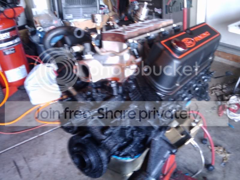

After 16 yrs of oil, dirt, etc. It was not a pretty sight.

Here is whats going in.
2000 Explorer long block
GT40 "p" Heads
light intake port job (gasket match heads, gaskets, and intake)
Crane 2040 PowerMax Cam
Billet true dual adjustable roller gears/chain
Cam timing advanced 2*
Flow Kooler High Vol. water pump
Melling high Vol. oil pump
Proform Pickup
Proform 7 qt. oil pan
Felpro 1 pc. silicone oil pan gasket
FMS lifters
FMS pushrods
Crane cams 1.7 rockers
Prothane Poly engine mounts
ARP bolts throughout
FMS black/red valve covers
TFS track heat intake
1" phenolic spacer
24 lb injectors
TFS valve spring kit w/ chromoly retainers
BBK 75mm TB
Summit 75mm MAF
Aluminum U/D pullies
Centerforce DF clutch
Findanza Aluminum F/W
Etc, Etc, ...

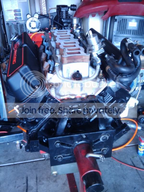

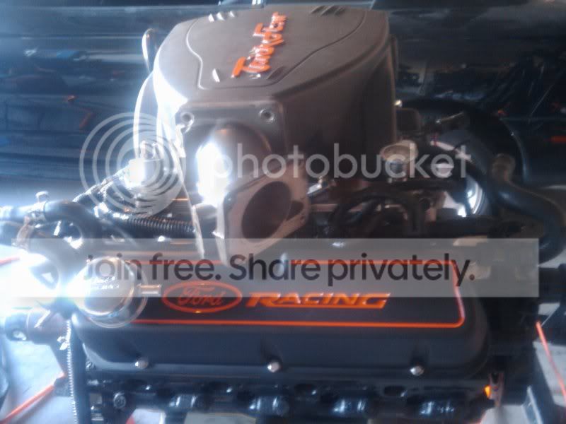

Here is an update:
Got the Injector harness re-covered and installed. Upper intake is on, intake elbow is on, rebuilt my POS BBK throttle body that broke, Gasket matched my exhaust ports, Passenger side long tube header is installed, i have to beat the hell out of my D/S header on the #7 spark plug-all others are fine. Pullies installed.

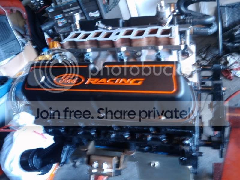

Here is the finished product...

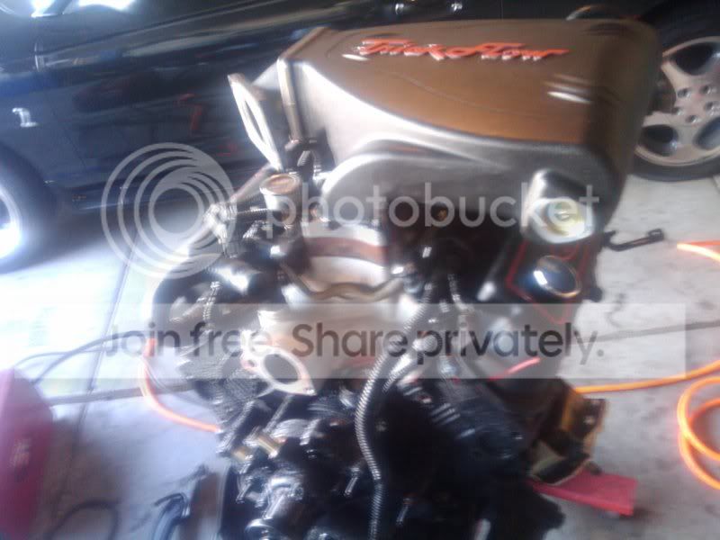

Update;
Longtubes fully installed, and heatwraped.
distributor painted and installed
Brackets painted and installed.
So basically the engine is ready to have the flywheel, clutch, bellhousing, etc put on and installed. BUT im not going to right away. My entire engine bay is going to be sanded, all small holes welded and painted. Wires ran through fenders, and carbon fiber panels covering where the battery and CA intake used to be.

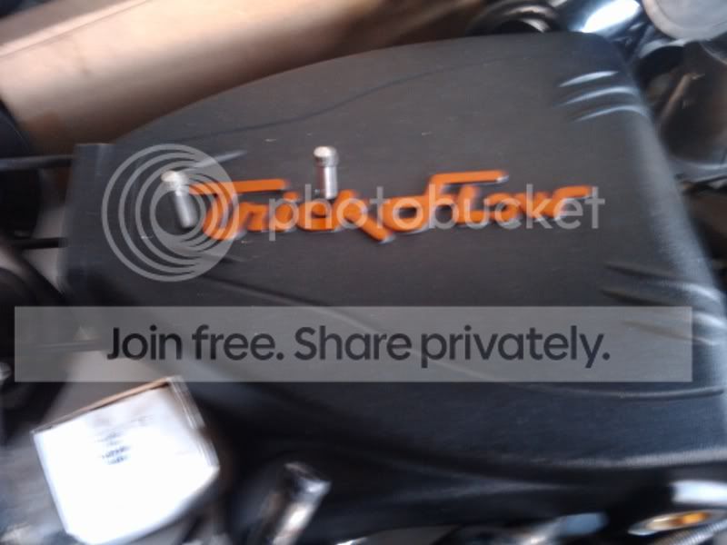

Here I decided to put a special touch on the brackets. I ground down the edges on the side...
Wires on. BIG THANKS TO HEATSHEILD PRODUCTS FOR THE 2" HIGH TEMP EXHAUST WRAP! THIS STUFF WORKS PHENOMENAL!

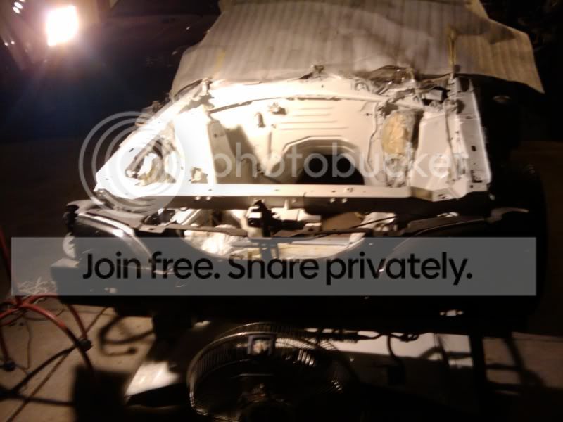

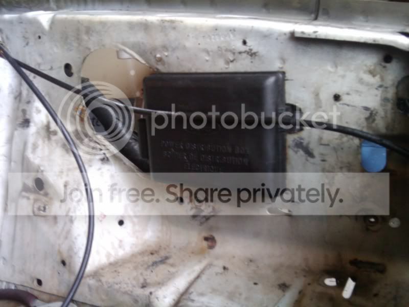

Alright, so i was up late last night, pulling off all the body work and fabbing up my opening for the fuse panel. This space will all be covered by a carbon fiber panel.

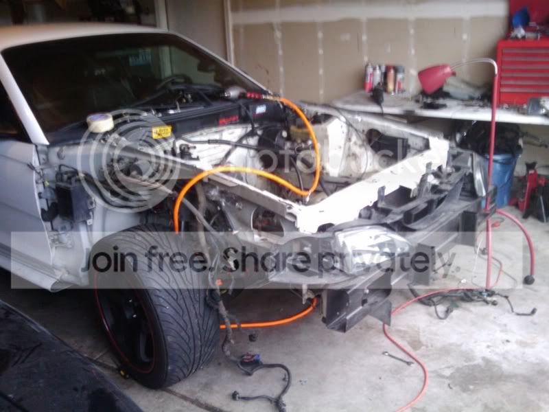

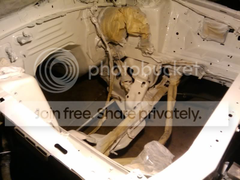

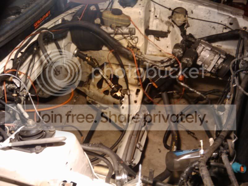

I just finished going through my engine bay. I wire tucked everything, and painted. I made carbon fiber panels to cover the areas where the battery and air box used to be... Its nice to work for a composite manufacturer. :)
