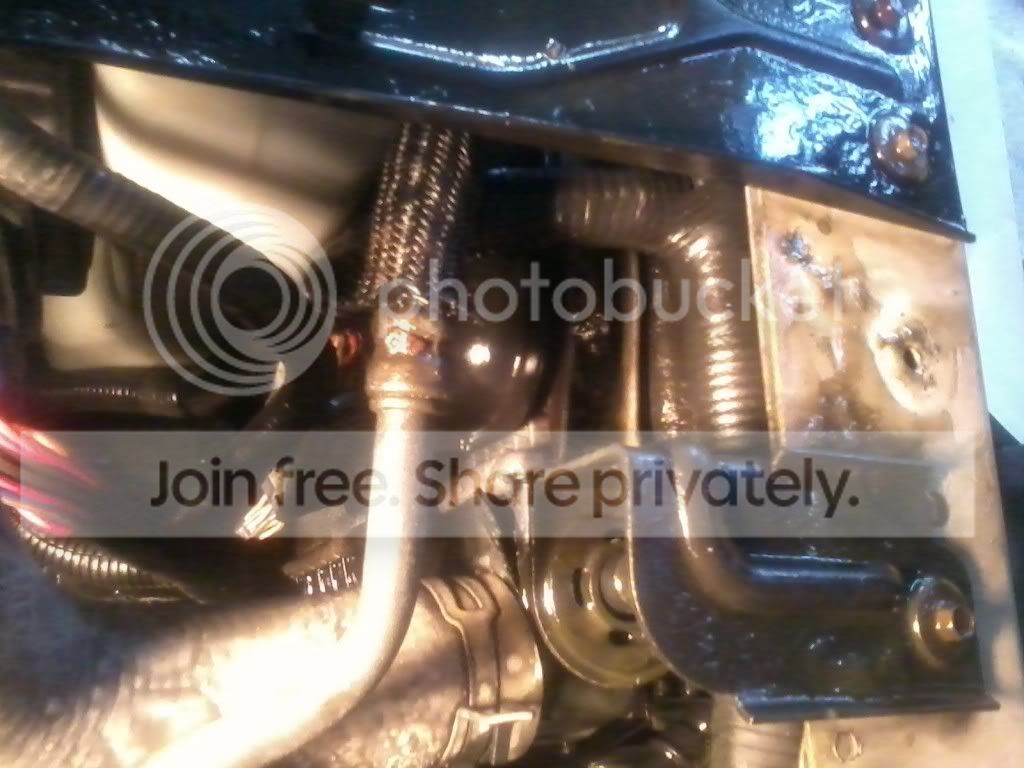

Okay guys. Tell me does this sort of thing happen on our cars? Or is there a underlying problem here? This happened on my drive home. I heard a pop and saw the smoke. I just figured a hose blew out.

I did a compression check and it went as follows.
Cyl #1 142
Cyl #2 0
Cyl #3 139
Cyl #4 110
Cyl #5 120
Cyl #6 121
Cyl #7 120
Cyl #8 115
I checked Cyl #2 three times before moving on. Something let loose in that cylinder. Until I pull it apart. I dont know what.

mustangshane said:
Yeah, probably. So what to do until then.
well you can't drive it obviously. you should start taking it apart as there is probably coolant in the oil and a puddle in that cylinder. don't want to let it corrode the cylinder wall
