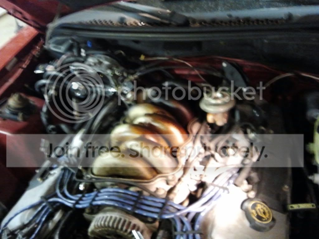

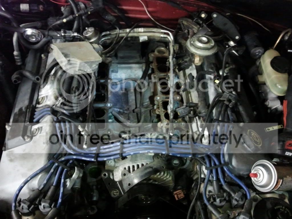

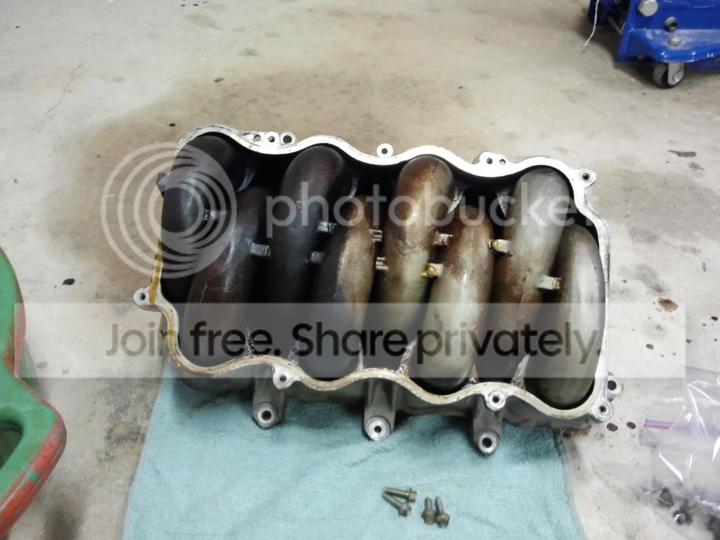

so the cobra has been acting up again. i thought it was the o2 sensors because i drove over something and it cut up a wire from the mils i made so i re did them made them look nice and what not. and it was still acting up so i hooked it up to the reader and it gave me p1519 IMRC STUCK CLOSED so i searched and decided to clean them. found this article http://www.svtmustangcobraclub.com/media/pdfs/tech/IMRC_Cleaning.pdf
IF U SEE IN THE MIDDLE THERE IS A UNPLUGGED WIRE THAT GOES TO A SENSOR OR SOMETHING CAN YOU TELL ME WHAT IT DOES IT WAS UNPLUGGED AND IDK WHAT IT DOES. JUST CURIOSITY I PLUGGED IT BACK IN
I WAS PUTTING EVERYTHING BACK TOGETHER WHEN I NOTICED THAT ONE OF THE GASKETS WAS MESSED UP SO I GOTTA WAIT TILL TOMORROW TO FINISH :(

I'm assuming the plug your talking about is the connection to one of the knock sensors.

Making IMRC deletes is not very difficult, you need to remove the butterflys off the rods and once that is done the rods can come out. You will basically end up with just the bare composite IMRC plates. Use expoxy to close up all the holes left open from removing the rods. The IMRC controller (bolted to bottom of intake) will need to be removed along with the IMRC cables. You will get a code for the IMRC's but they can be turned off if you plan to get the car tuned.
On my car I used industrial strength JB weld since mine are aluminum, but you will have to use epoxy since the 98s came with plastic/composite IMRC plates.
