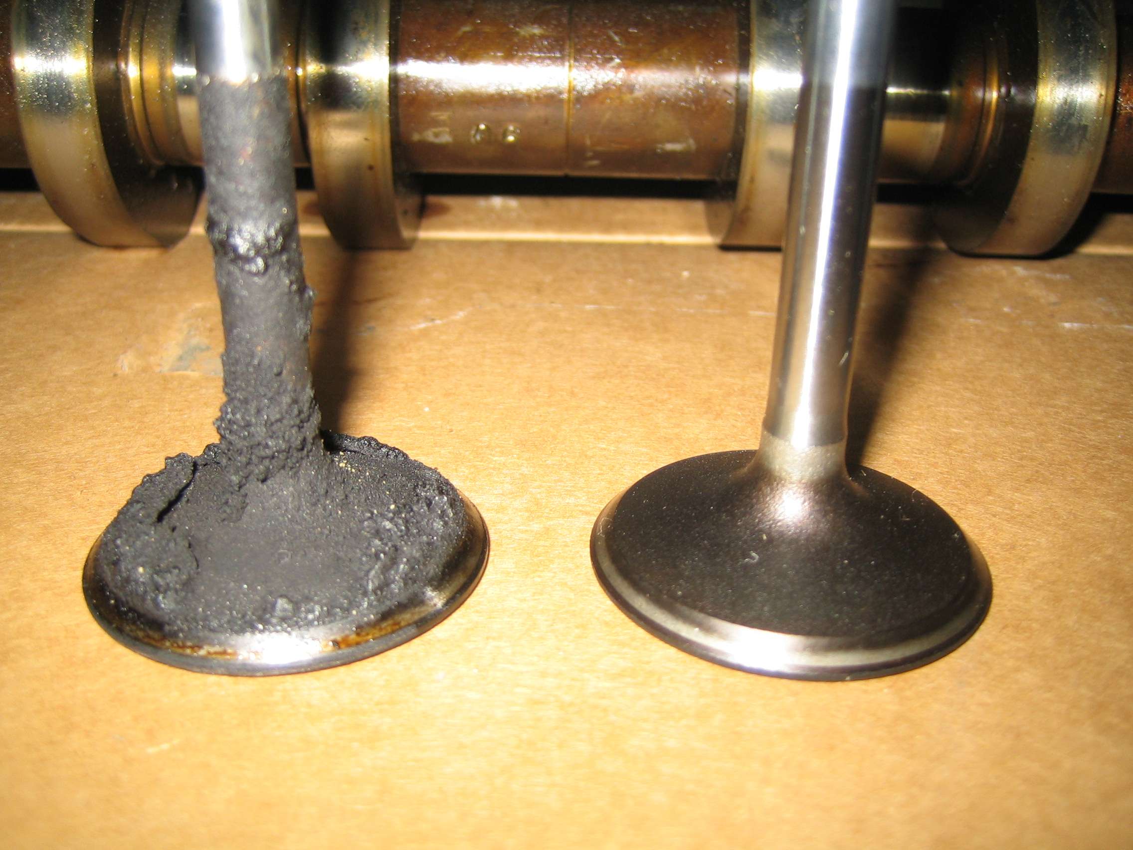

Cleaning the IMRCs is only 1/2 the battle. The real crud is usually on top of the valves.
From no fuel spray to the secondary butterflies, they get buildup like this:
Secondary( no fuel spray) on left, intake valve with fuel spray on right.
