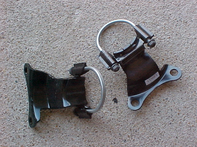

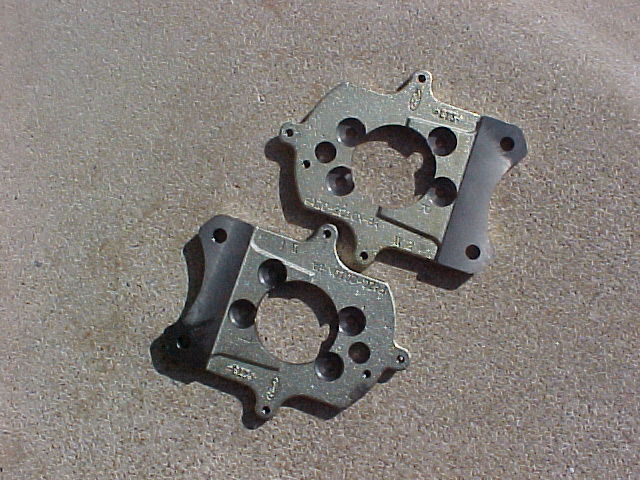

The rear calipers are the same, but you do need new brackets. Since the rotor is thicker, your pads will be thinner, and the cobra bracket has bracing on the outer edge. See pics below.
GT Caliper Mount
386608
Cobra Caliper Bracket
386609
As others have said, you will need the axle brackets, and anti moan brackets.

Thanks for pointing out about the different bracket the caliper slides on. Yes, it is different. I learn something almost every time I log on here.
