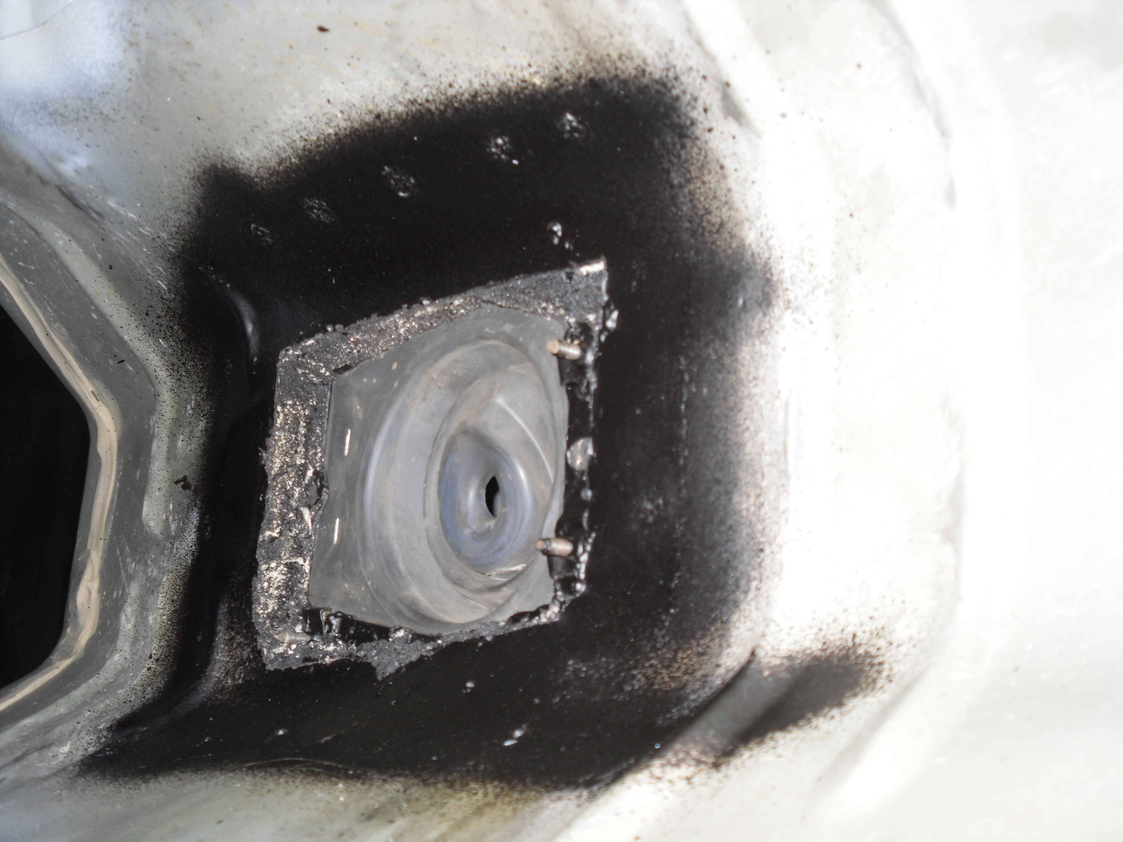

Here are some pics of the Transmission Tunnel I am talking about.

If I remember right the transmission tunnel plate only only comes up about 1-2". You could probably get away with just bolting the boot to the original tunnel since it is rubber and will bend, but don't quote me on that, im not 100% sure on that. If it were me i would just go to a junkyard and get this, it will probably run you around $25, its easy to install and only needs to be spot welded in about 20 places. This is how it came from factory. To remove it you just need a drill bit, you simply drill the spot welds out and the piece will come right off, then place it on yours and re spot weld it. The steering column will be needed, i have both a auto and a 5 speed column in my garage. The automatic one has a cable running to the switch that will not allow you to remove the key unless it is in park. You can probably disable this and it will work fine, but also the 5 speed column has the safety switch that will not allow you or a friend messing around to turn the car off accidental while its in gear. This column will probably only cost $25-40 through craigslist if you can find someone who is parting one out, and while your there why not get the transmission tunnel piece.

You don't need the piece with the switch on the column. And yes they're right you don't need the piece for the tunnel. I did add that piece on my car Cus I ripped everything from the cobra on the other lift beside my car while I did the swap. I've done a bunch of 5spd swaps with out adding that piece. I'm doing one on a fox right now. All these guys whining about the pedal assembly being hard do one on a fox body lol the sn95 one is easy to do

I cut the tunnel with a air chisel and siliconed and used some sheet metal screws. Didnt care to weld it not being
Stuctual in anyway

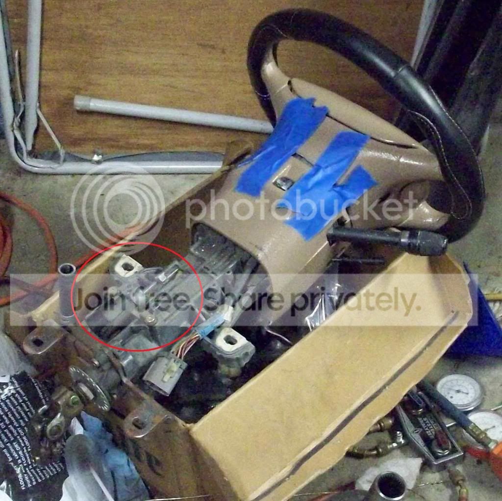

Yeah, looks like the tunnel piece is not a necessity and I took my column out. I will be posting pics of it and what can be done to make it work with the manual. I assume what most people do is just leave the cable in place on the column. I may or may not do that. If all the cable is doing is holding something forward or back, should be able to put something else in there that will keep it where it thinks it should be. I'll update when I get around to it. Damn work cutting into my mustang time. Bastards!

Here's where the cable goes into the steering column as part of the shiftlock assembly. If this part needs to be held by the cable forward or back for the ignition lock cylinder I'll find out and let you know.

OK, well the lock cylinder moves the cable so it can be left out. I left the cable out completely and have no issues.
