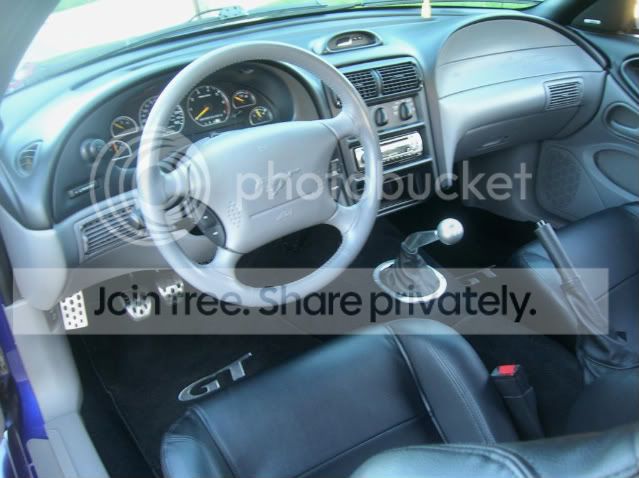

Motor, trans, brakes, and rear end will be minor in needed modifications. Matching fenders to doors will be the hardest part to blend. Next hardest will be interior swap with electrical,steering mounts, and the needed trimming to finalize the fit.
These are some links I found on people doing the interior swap. I suggest you do the doors before the dash. Placing the doors first will give you a better placement to trim the dash for a cleaner looking install. If you do dash first you will have to do more trimming at doors and they are more visible on where you would have to trim.
http://www.allfordmustangs.com/forums/5-0l-tech/61587-help-installing-sn-95-dash-into-1993-fox.html
http://forums.corral.net/forums/body-shop/1188162-lets-see-pics-sn95-door-panels-fox.html#post9493045
Uses fox door panels in these. :( http://forums.corral.net/forums/body-shop/1188274-sn95-dash-foxbody.html
http://forums.corral.net/forums/body-shop/916576-1987-1999-%3D.html
I assume you plan to do sn95 dash, doors, and console when you say full interior or do you plan a no center console option.

@castine awesome links and pics! that is exactly how i plan on doing the center console delete.
