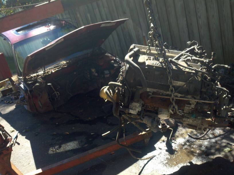

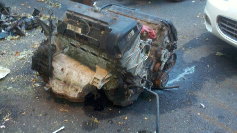

Picking up the engine:
Saw this on the way back. We ran if off the road.

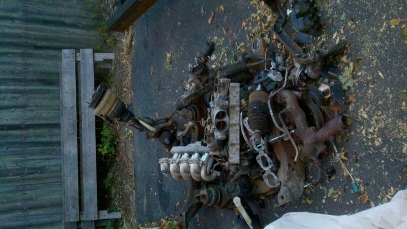

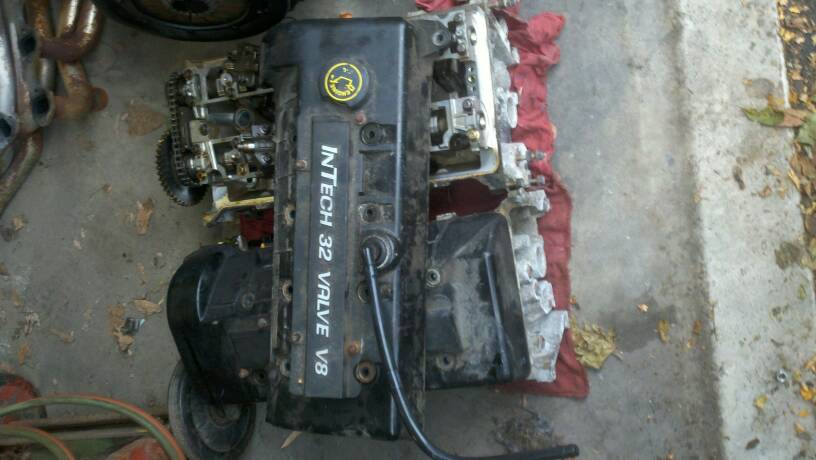

Day 1:

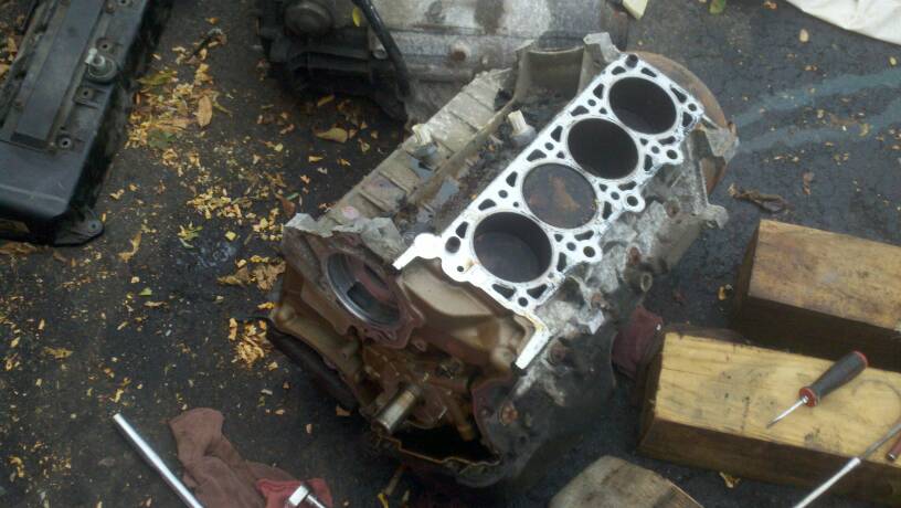

Day 2:

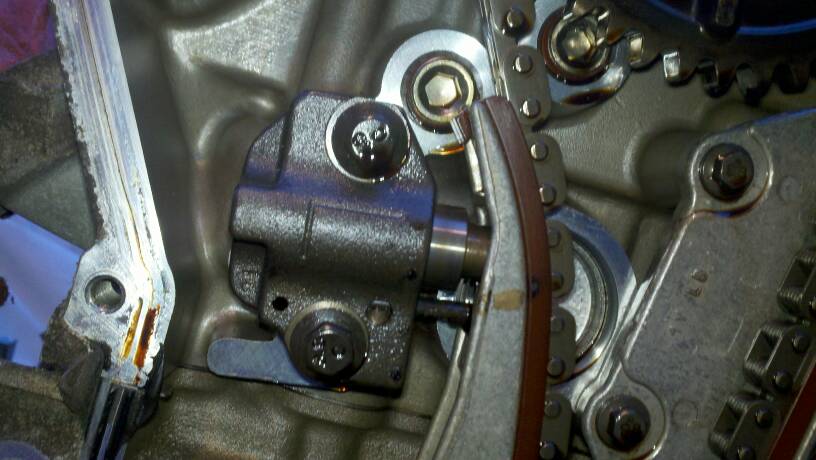

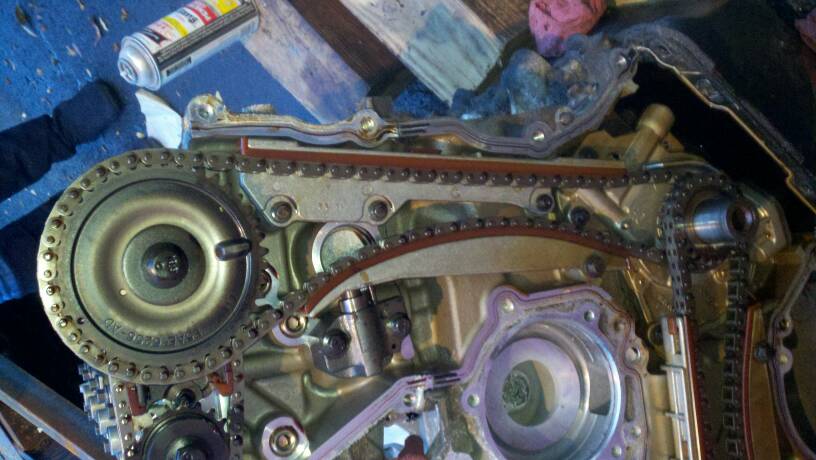

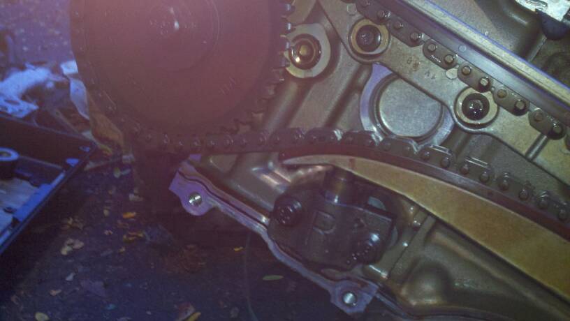

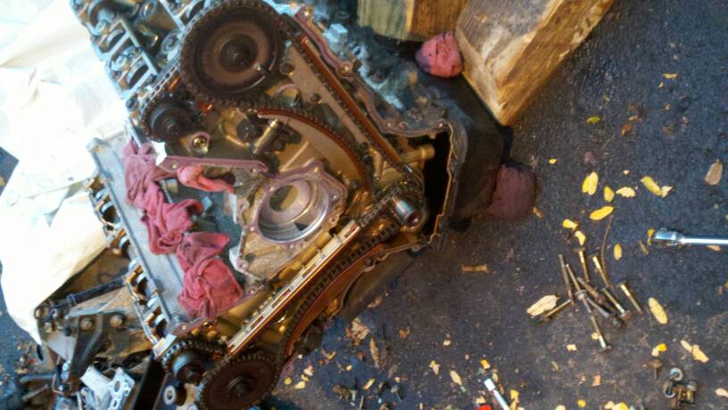

Day 3 w/ closeups of the timing setup:

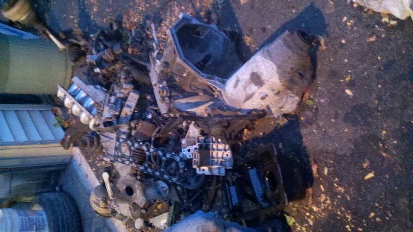

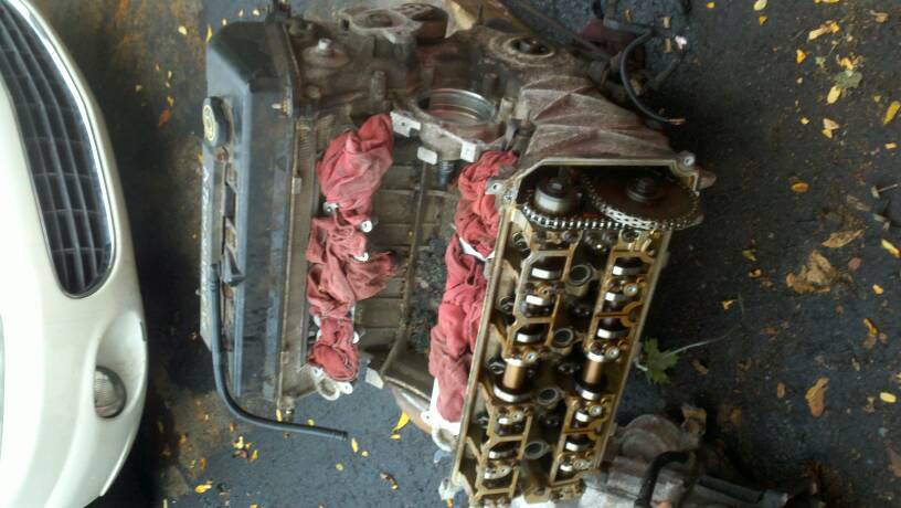

Day 4:

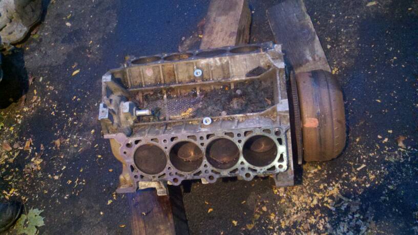

Well I dont know the answer to the head question, however I think you should get your 100 bucks back if you scrap the block. Problem is that the Continental blocks, being fwd, dont have the same bolt patterns as the bell housing to block of a rwd

They look like B-heads to me. The cams will have a different profile than cobras, and of course the intakes are different as well.

and again, the block can't be used so it's pretty far from a cobra motor. the cam covers are fine. that's not sludge, just the color of the parts.

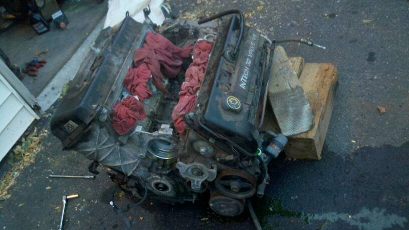

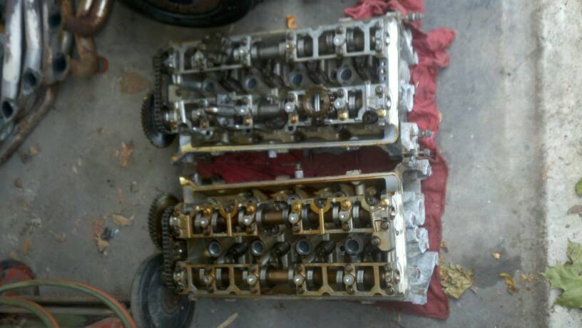

AND WOAAAAAA whats up with the milkshake on that valve cover??? she have a blown head gasket?
The discoloration is pretty common for that side head. The traditional "Passenger" side of the 4.6s are always sitting in a pool of oil due to the timing chain pushing oil up in it more so than the "driver" side. (which with oil changes doesn't always get it out so it can sludge and cause what you see there)
Those are indeed B heads though. At first glance it's tough to tell because of the rags you have in place of the intake ports however, the first picture you posted gives it away 100%. Dual port with 1 round and 1 square. Which are the same as the Cobra's just not the Cobra C's you hoped for and they should have the improved combustion chamber design and same springs as the 96-98 Cobra. If you want take some closer pictures of the springs and a combustion chamber shot to know for sure if it's got the revised design or not. (It's nothing major, just some light dremel work could do it if they need it)
I knew they looked the same, but I wasn't sure if they were exactly the same. I didn't know if they might be cast with different water passages or something like that. I'll have to get some more pictures.

Nope, same all around. What year was this actually pulled from?
In the mean time, this is what the CC should look like if it's got the revisions. The bottom bowl between the two intake valves should look like that, instead of how between the exhaust ports look.

Looks like the revised version extends into the middle further. ill probably get a look friday. like I said, the guy said 01 and I was like no..... now that I think about it, I believe my buddy looked at a sticker on the cam cover and told me it said 96.

My friend's dad scrapped the pile you see and got me $40. I scrapped the following pictures along with some very small stuff for another $57.32.Engine/Subframe/2 Cats/Struts/errrrthang - -$100 Breakfast for myself and Brownie - $20 (-$120) Gas - $50 (-$170) Dinner for myself and Brownie - $40 (-$210) Two cats - $90 ($-120) Subframe/Struts/Etc. - $40 ($-80)Engine/Torque Conv/Etc. - $57 (-$23)Total - Set back $23 and I have a complete set of heads to show for it. If I didn't count gas or food, I made out even better. Also, I have a lead on some 03 Cobra cams for $50. Things are coming together slowly but steadily. ) This was taken today:
