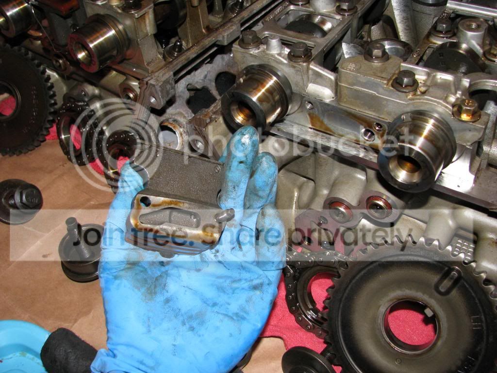

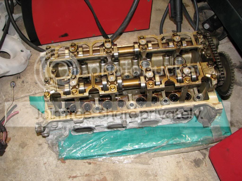

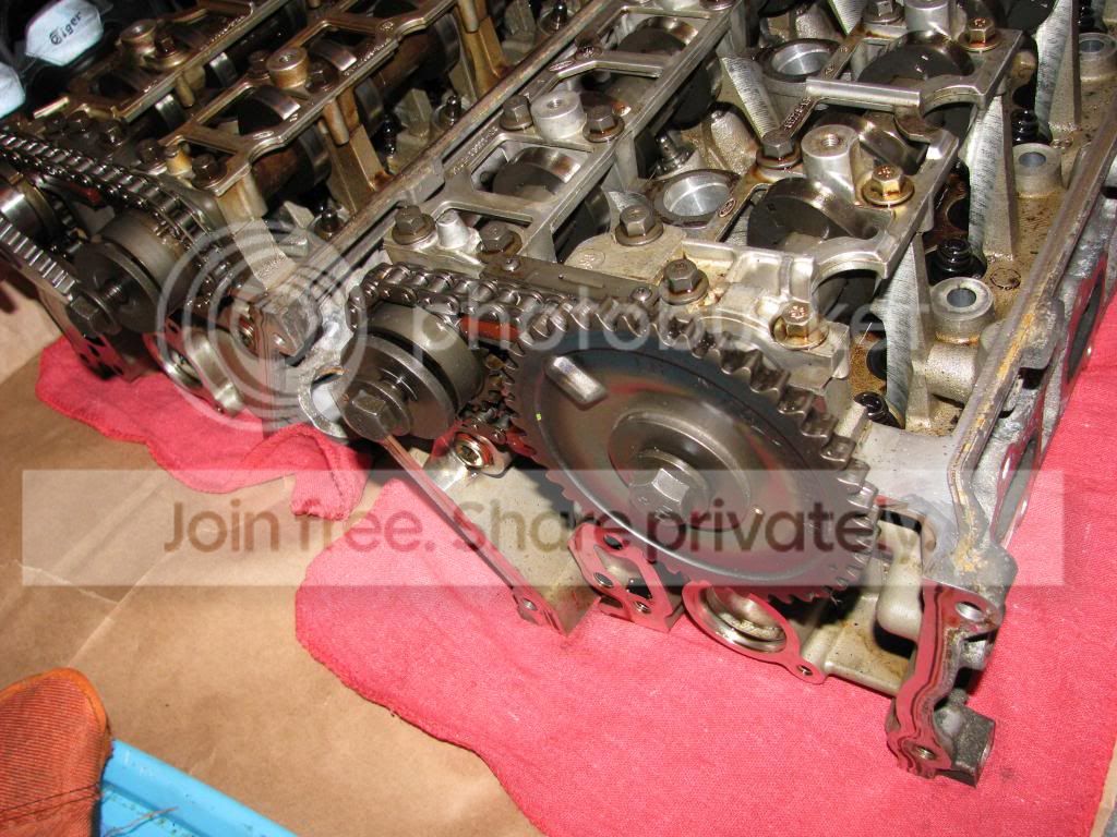

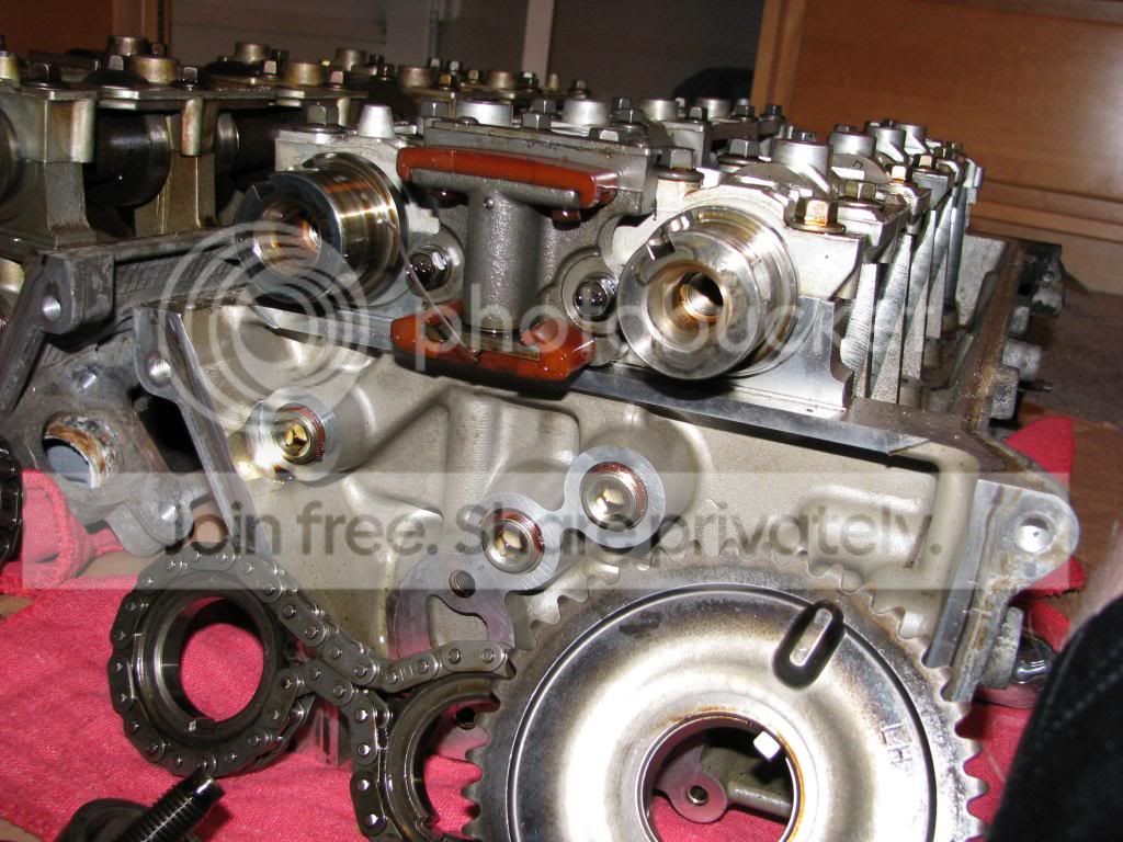

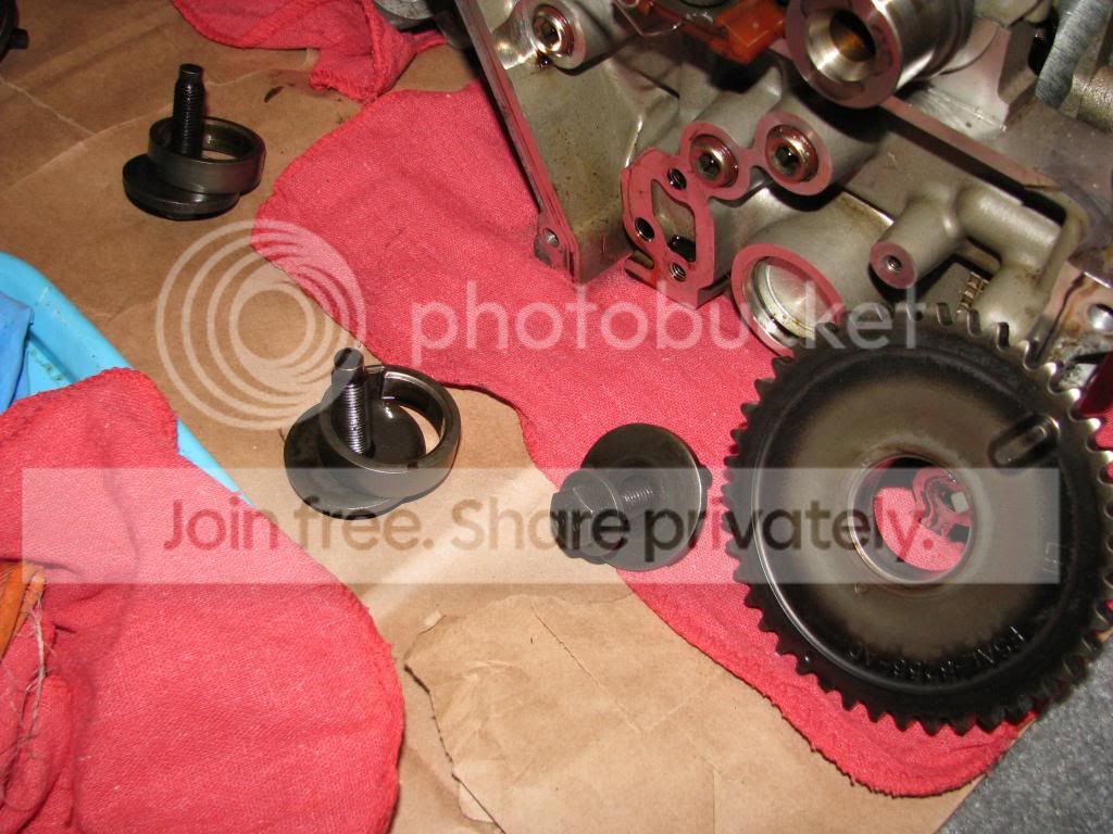

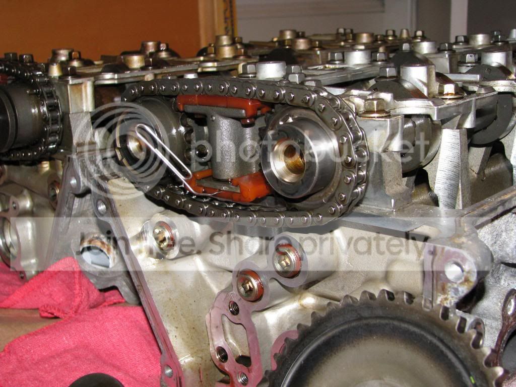

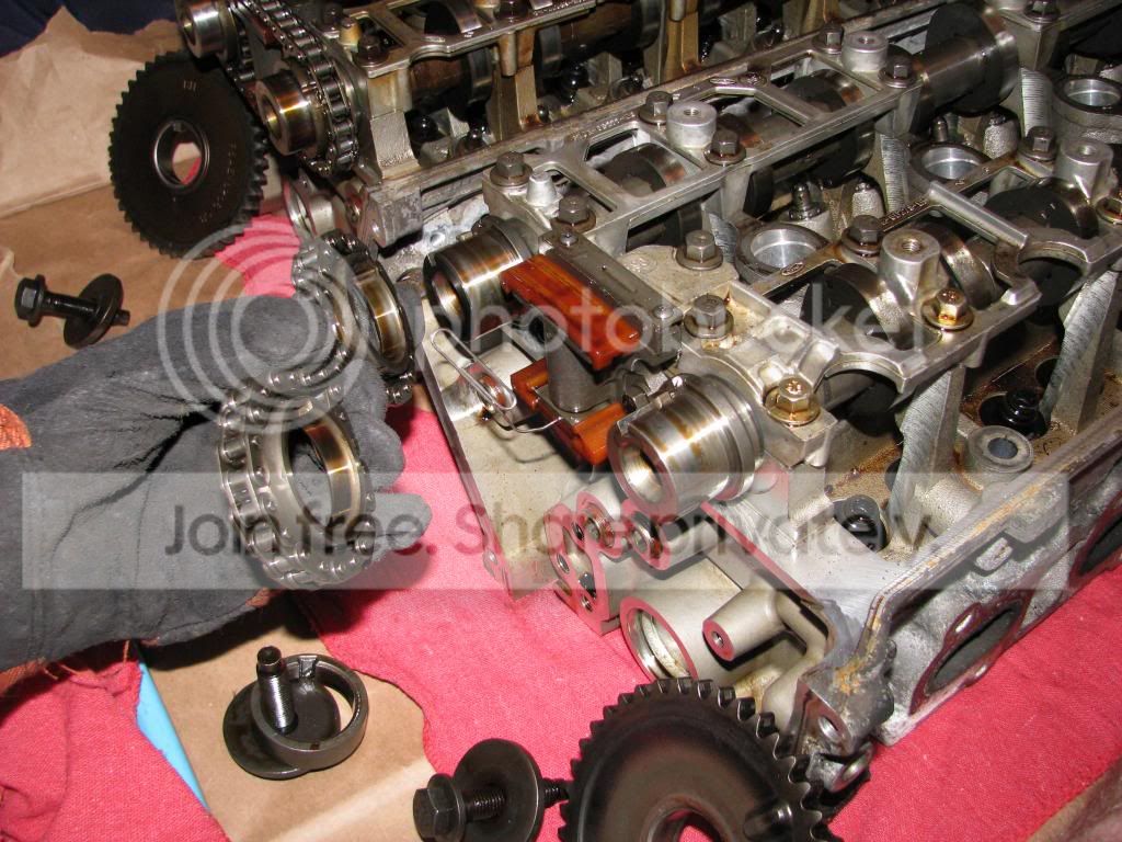

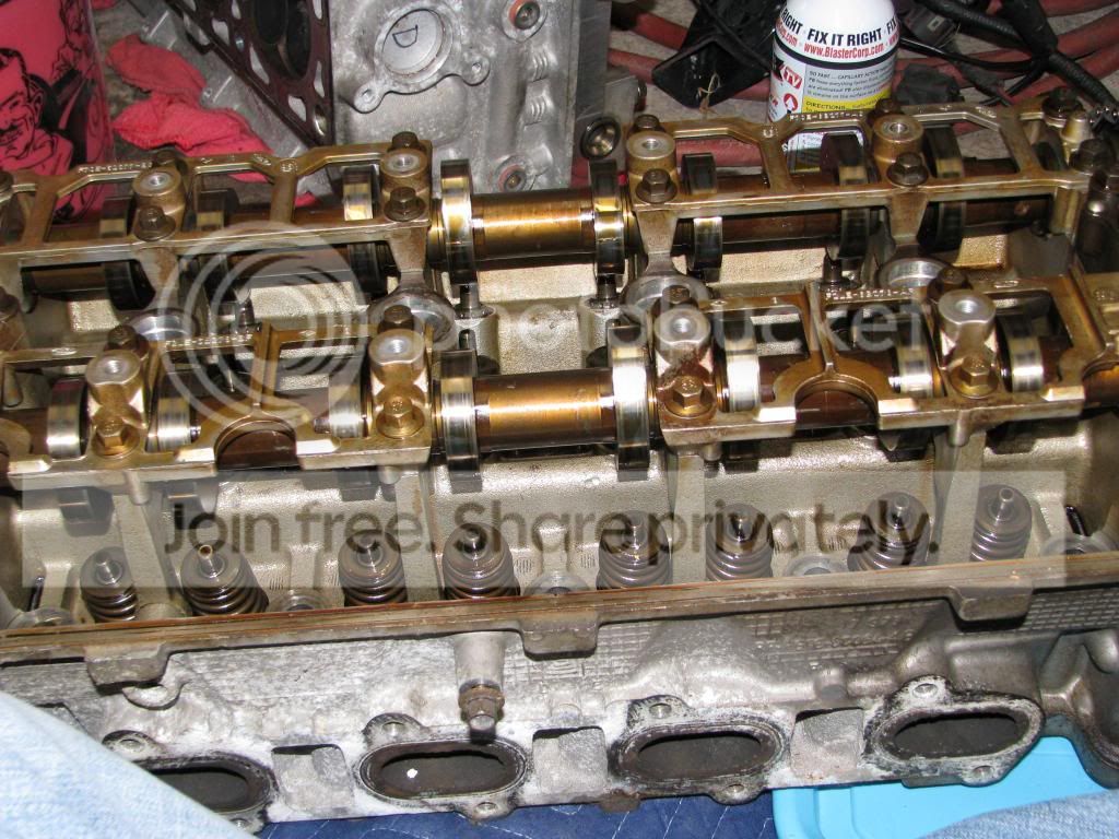

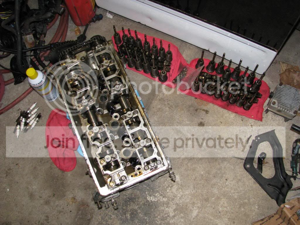

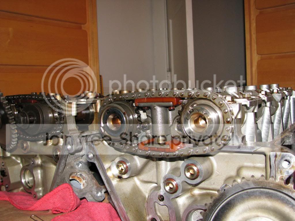

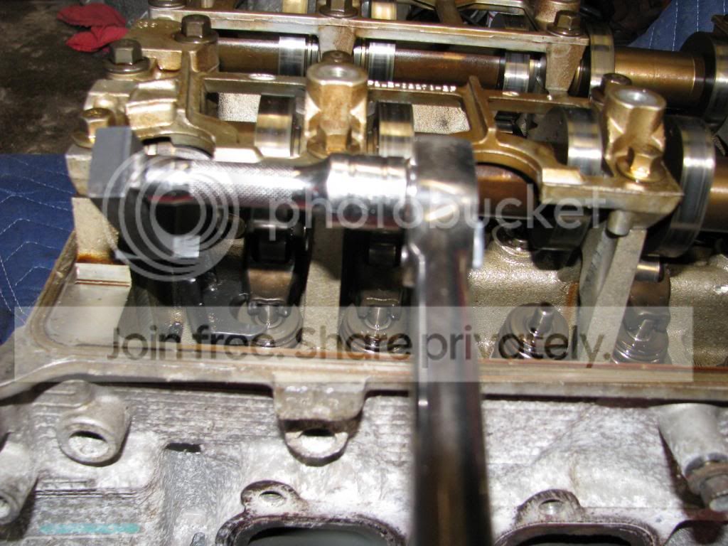

I just got around to disassembling the heads so I thought I'd share. I have 46 pictures so I'll try to only post a few.
Also, here's my '99 Cobra shortblock. I removed and scraped the pistons and rods.

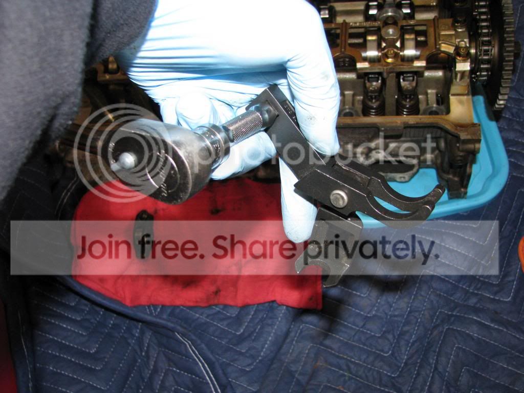

My buddy Josh hooked me up as usual. Tools to remove the valvetrain and lock the cams in place would cost me over $200.
My heads are on the floor. Joshs's two sets of B heads are on the tool box. One set is from the '98 Cobra engine he bought and the other is from a Mark 8.
I took my heads home to take off the cams.
