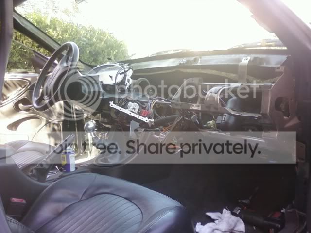

I figured out the pics kinda. i took the whole dash apart to get to the heater core. it took me about 4 hours to get it all out. i took a break from it yesterday and im going to try and get to the heater core today. Tips or tricks to get that thing out? i cant see shit its like still on the fire wall?

i am this far with the car so far, but im stuck that shit wont come out and i dont know why? more bolts? :violent1:
switch96
Jan 11, 2009
2,165
Props for getting this far, I don't remember any other bolts holding it to the firewall, but keep at it!
