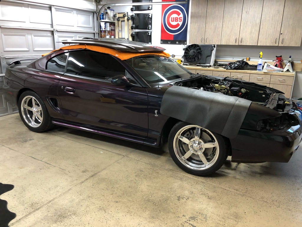

I’m currently completing a Gen 1 swap in a 96 Cobra using a Ford control pack. 2018 manifold, T56, 4:10’s, E85. Initially I planned on using the factory supply and return lines, but was having an issues with the push lock fittings leaking on the supply line. I may have been trying to use the wrong fitting, so I opted for a kit from Glenn’s Performance to eliminate the guess work. Should be running in a week or two.
