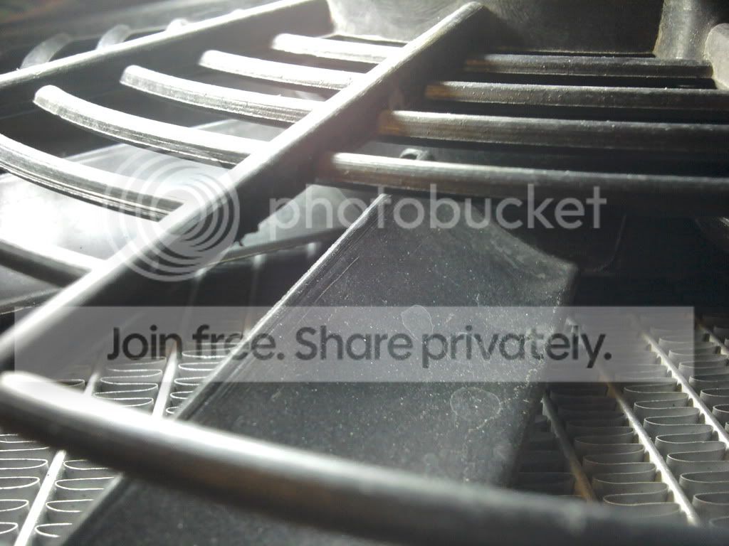

alright, painful hours of minut soldering and stripping and my fans are rewired. thanks to ya'll i have it narrowed down to the radiator. everything else is fine. a new problem arises, these twin fans are reversible, so they can spin either way. which way do they spin? iirc they pull air through the rad, right? thats counterclockwise i believe. VV-- is the left side of the fan, so counterclockwise would pull it through....which..is..right?
and i totally broke those 2 tiny fan guard bars :eek:ccasion14:

CC or CCW really depends on how the manufacture references the fan because the fan can be mounted on the front of the rad (pusher) or on the back on the rad (puller).
I suggest just touching the CCW wires to ck rotation. If the fan goes the wrong way, ck the other wires.
