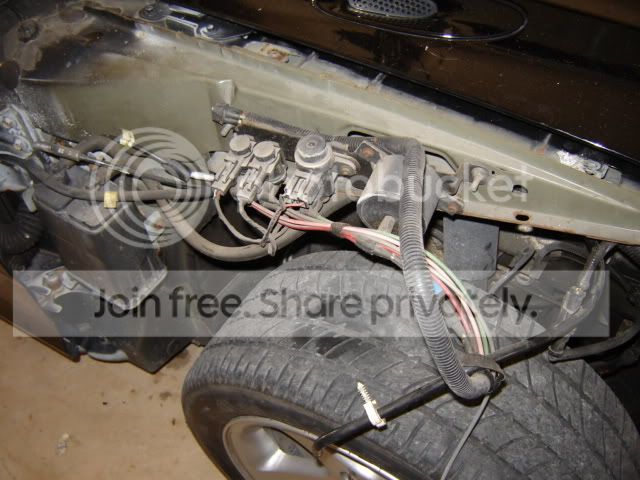

On this diagram you can see two things on top of the carbon canister that aren't connected by vacuum lines. If I remember correctly those two knobs were connected to a thick line that went into a single line then just ended. Unfortunately I do not have a picture, but I don't know how else to describe it. What are those two stubs for? Thanks guys.
[attachment deleted by admin]
C
cntchds
Sep 9, 2007
946
This is a better picture in order to see the two lines joining together and disappearing. Does anyone know where this line is supposed to go?
What two knobs are you referring to?? In the pic or the diagram??
C
cntchds
Sep 9, 2007
946
On the picture there are two knobs that have a very thick line coming off of them and soon after connect. It's the only picture I have. Sorry. :dunno:
