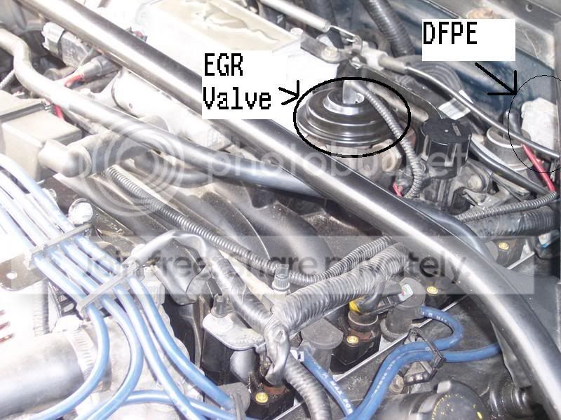

could you take a pic of the engine bay where all of the stuff i need to "check" is at?
bobtsgt
Apr 26, 2008
102
the sensor sits on the left of the drivers side head in the back. Its attached to the manifold by a black bracket and 2 bolts. Its a gray box with two hoses coming off it and a electrical plug. If you can take a pic of your engine bay I can circle it for ya. I have no pics of my old engine bay anymore. Memory card got screwed up last year.
these are the only pics i have but i can take more when i get home:
B
Brian95SVT
Sep 19, 2006
6,806
45
Chesapeake, VA
oh i know what the egr valve is (i replaced it a long time ago)
but thanks for pointing out the DFPE
that's the one i wasn't sure about.
