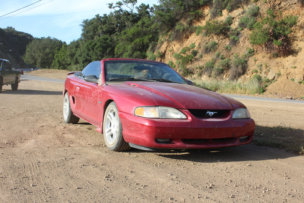

This past weekend I took a super long Greyhound ride to LA and picked up the Mustang. While I was in LA I took it to some nice canyon roads in Malibu which was a total blast. I then drove it all the way back home to Phoenix, which went off without a hitch. Here are some pictures I took of it while it was in LA:
It was absolutely filthy from being thrashed around on a dry lake bed for the video shoot, and the side skirts got torn off. I still have them along with all of their clips, they were laying in the front seat. It's also way too low thanks to the ghetto spring cut job (we cut 2 coils off the front springs and 1.25 coils off the rear springs).
Specs-wise, it's a mostly stock 1996 Mustang GT convertible with a 5-speed manual. Neither the speedometer nor odometer work, so it's been frozen at 182k miles for a while. Reportedly it's near 200k according to the previous owner. The engine runs perfectly for the most part, especially since I just replaced the IAC with a brand new one. The AC works brilliantly since my friend and I filled it up with a cheap Autozone kit. The radio also works since we fixed the previous owner's horribly botched wiring job. The engine doesn't burn any oil and it doesn't appear to be leaking any fluids. The spark plugs, ignition coils, and alternator are all pretty new as well. The tires are in decent shape too, with a good amount of tread left. Not much grip in the rear though since the tires are only 245's.
