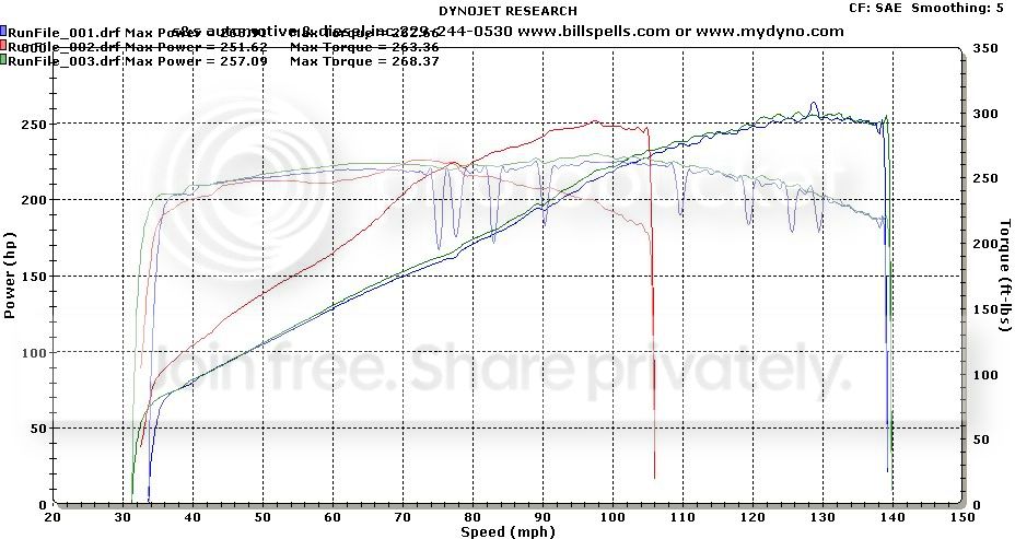

On a side note, I just got my results from the dyno runs:
RWHP-258 (first run)
RWTQ- 268 (last run)
All 3 pulls were to 6,000 RPM. 1st and 3rd pull from 4th gear, 2nd pull from 3rd gear. I threw 2 codes during the 1st pull. P1519 IMRC stuck and P0303 Misfire Cylinder 3. Is this on spec for a 15 year old 106,XXX mile car? 75 deg temp, 80% humidity.

I'm curious to know what other STOCK 96-98 Cobras are putting down RWHP/RWTQ..I've searched google to the edge, and seems everyone who posts their dyno runs has at least upgraded exhaust or intake. Any actual figures on STOCK 96-98 Cobras??

It seems I have all the right tools now to prepare for one more trip to the track once the temps cool down later in the year. I guess it turns out what initally seemed a poor first performance wasn't that bad (for being a first timer). My dyno results are also a little encouraging after talking to a few other fellow Cobra owners. It turns out the car is exactly where it should be, maybe even a little healthier than expected for the age and milage. Thanks for all the insight guys, and please continue adding anything else you might have.

why did you stop at 6000rpm on the dyno??? did you ever take care of that high rpm misfire?
your dyno results are right on par with all n/a 4v sheets i've seen, even with bolt ons they dont pick up much, until you bolt on a blower or bottle.

The tuner said the peak of the power band is at 5800 RPM, so there was no need to go much further past that. As for the misfire, it only did it once on the dyno. Car runs great on the street, so I'm assuming it was a one time deal..maybe caused by the IMRC getting stuck.
