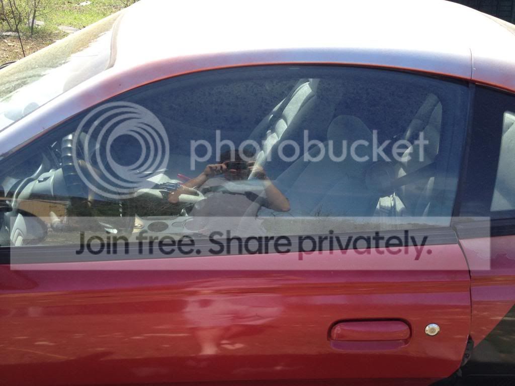

Here's a picture of what all I found in my driver side door (this'll defiantly help eliminate some rattles) Anyone know where to find a replacement one of these?
And this picture shows how unaligned my window is, actually smashing into the body of the car and having an opening at the rear of the window
