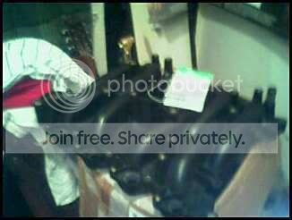

just got my intake and i guess have to put a second hole in there somewhere.. but where?? and pics or anything would help me out. i wanna get this bitch bolted on..

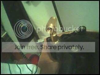

this was my solution... cost 20 bux at a machine shop.
and it looks factory.

Hey Dave, what exactly did you have the machine shop do to get a fitting in that thermostat housing?
